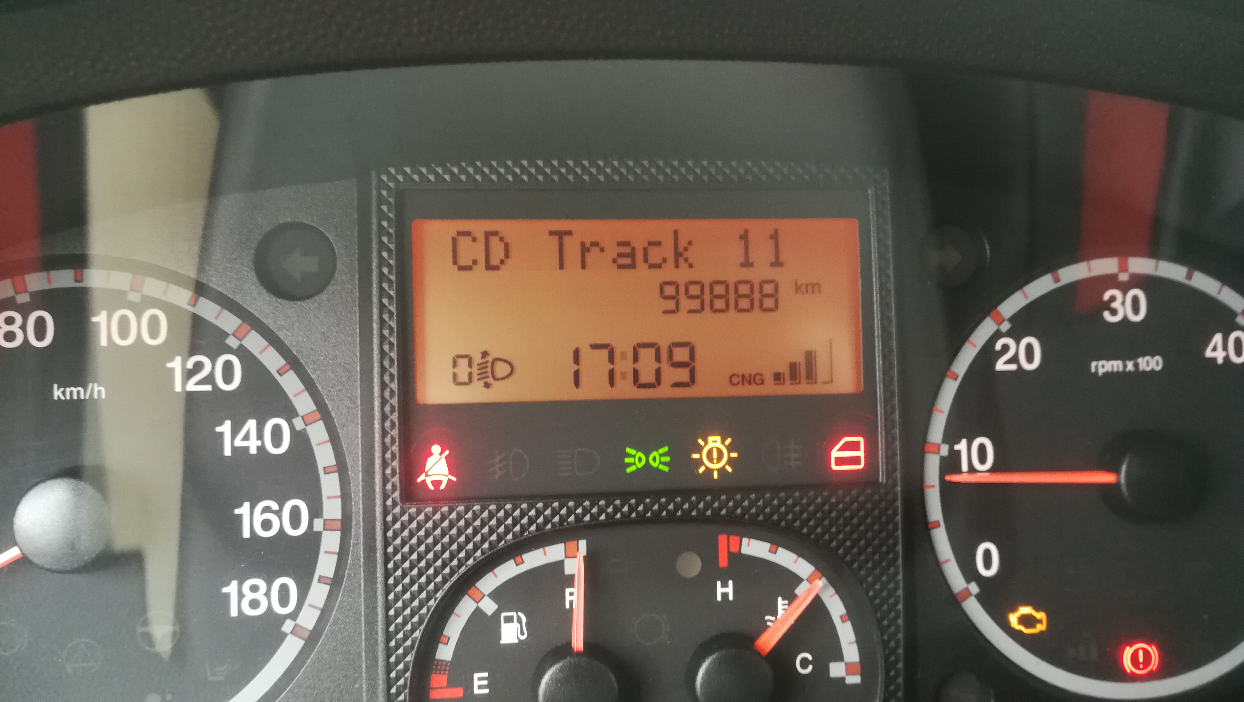

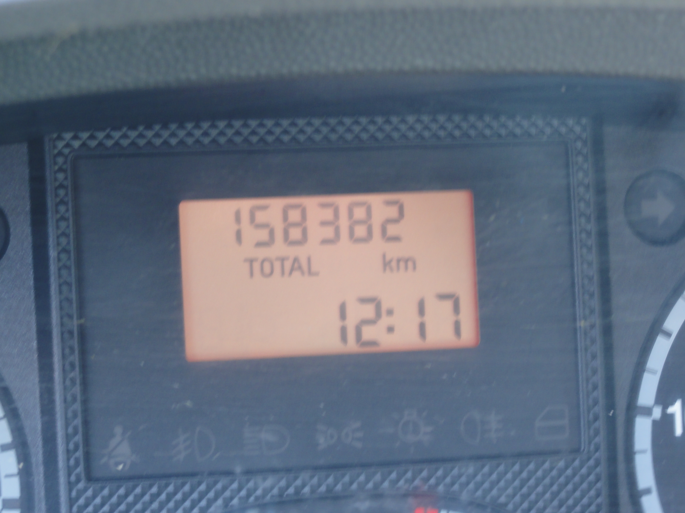

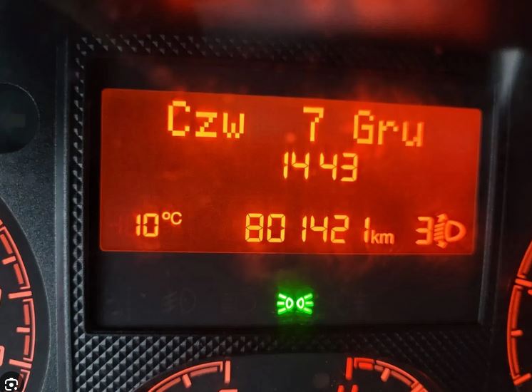

As far as I know, there were several types of the displays. First of all, there are 2 sizes of the display itself (see attached photos 1&2). Then, what is displayed depends of the installed equipment. The easiest would be to reffer to the owner's manual. There should be one available in the download section of the forum. The positionning of the displayed elements will also vary depending of the van equipment / options. On the second attached photo the headlights position is being displayed on the right hand side. My displays shows it on the left, as the right hand side corner is reserved for natural gas level (photo 3).
The outside temperature, if available, should be present in the left bottom corner. The function must be active, and the sensor must be connected and working. If the sensor is broken or disconnected, but the function is active, you'll see -- C or -- F.

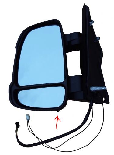

The temperature sensor was default only with automatic AC. But it can be added and activated in MES. The location of the temperature sensor is bottom of the drivers' side mirror (see photo 4, marked with the red arrow).

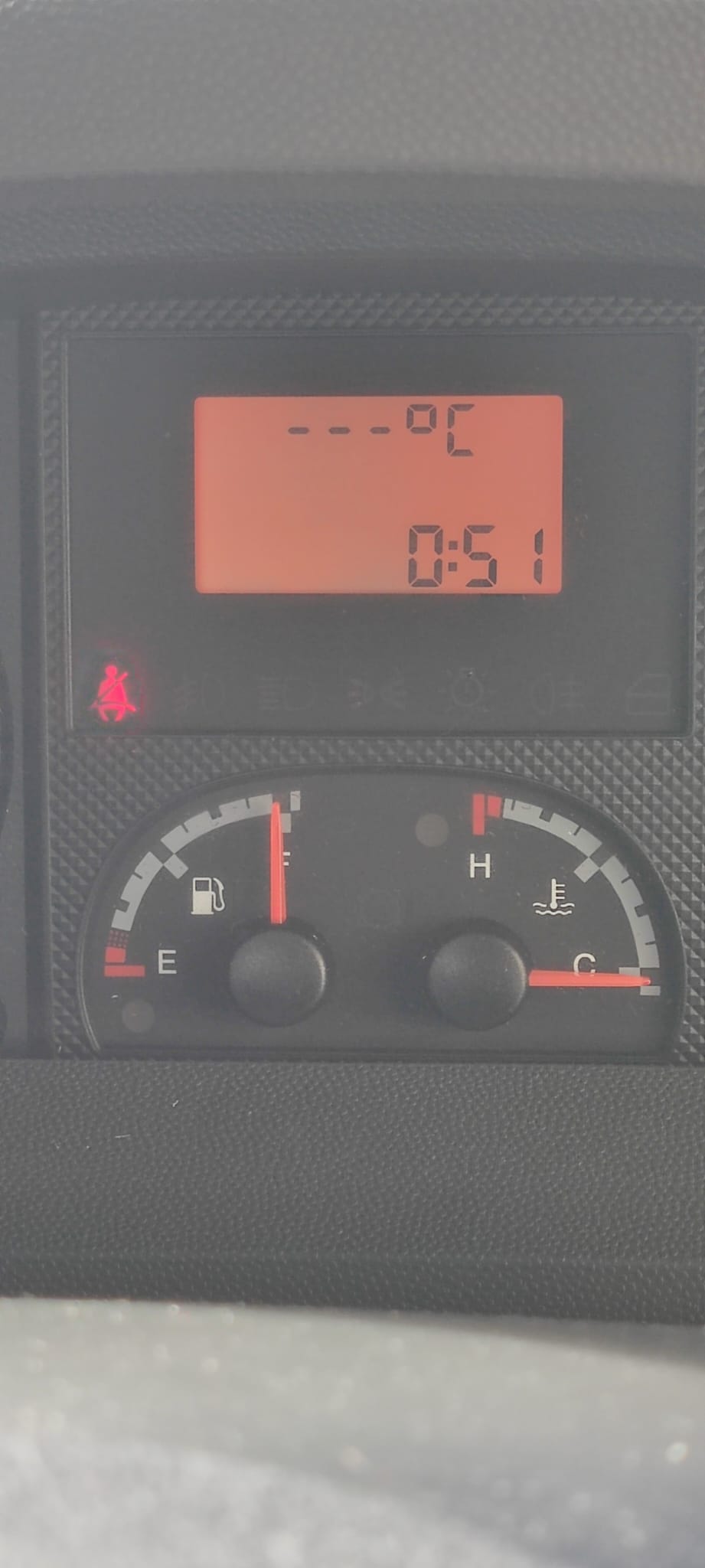

Many thanks for the reply
Green vamper my displays this and it does not read any temperature readings. Do you happen to know what colour wires the sender connects to in the driver's door ?

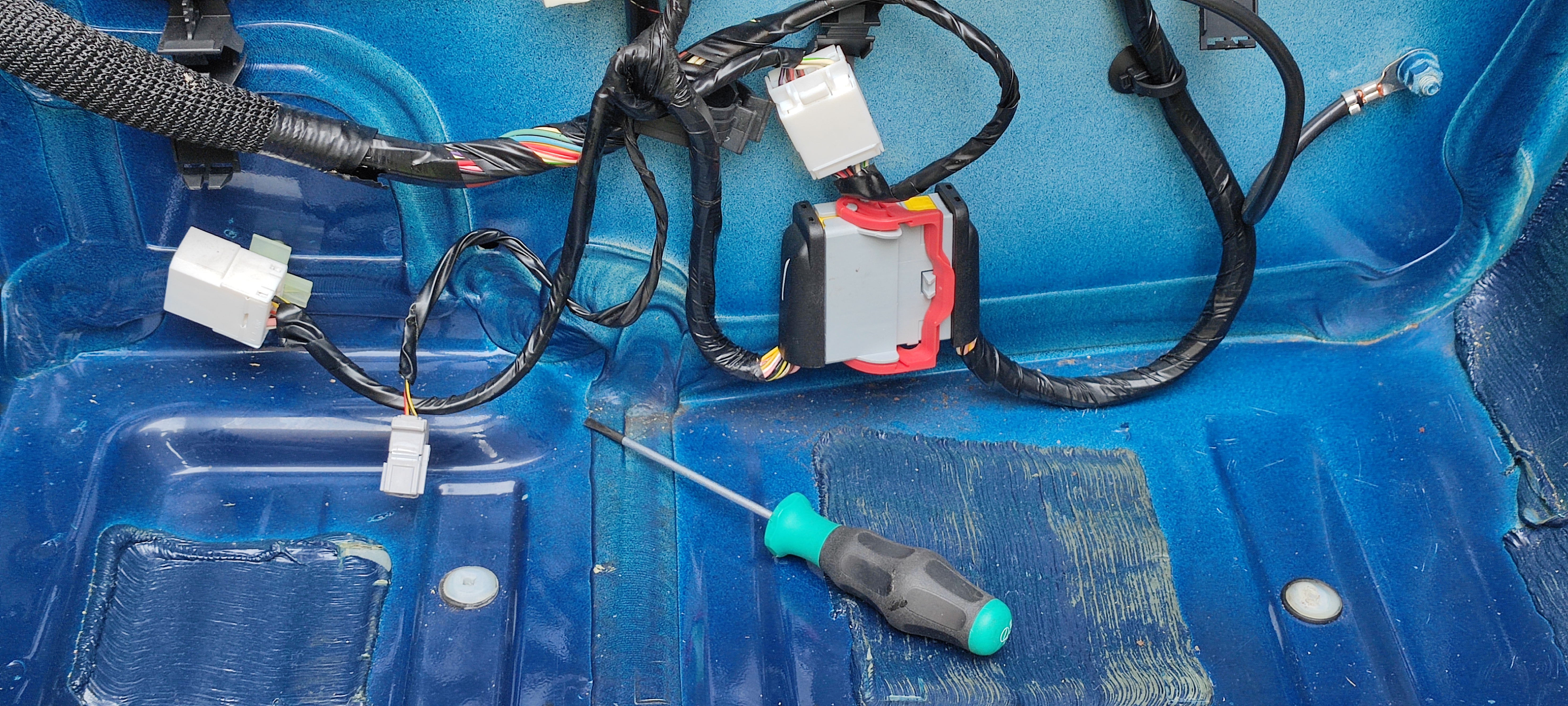

Thanks for the reply I did get a chance to have a look at my van today but did not have any luck getting a reading on my dash display. As the video is in polish I cant follow what is being spoken so I have a question for you green vamper and that is I see that he is using a laptop can you please confirm if I need to program this into the BCM ? Thanks

As on yours you can see the --C on the dash, you have two options: or your temperature sensor is broken, or it is not connected to the BCM. I assume you have it, as I put a photo of a mirror with a sensor and you haven't commented that there isn't one on your mirror.
Is that a left side step on the photo? or the right side one? The sensor should be installed and connected on the side where the steering wheel + fusebox are. In my opinion. You won't find it on the other side.
I assume also your van is RHD...
Hi there yes my van is RHD and it does have a sender fitted in the driver side mirror but i think the mirror is a non Fiat replacement mirror. I have also purchased a new sender unit only and tried connecting this to the pins shown in the video but still did not get it to display the temp. so at bit of a loss as what to do to resolve this issue
You've connected it in the right side step?
Check if there are cables running from this plug (same pins) to the BCM. I can't remember which ones. And another thing - you've got a smaller display, I'd also check if the pins are the same, that also could have been changed by FIAT.

On page 139 of the manual, there are pictures of two versions of the instrument panel MODAL, and COMFORT. Apparently the MODAL version does not display external temperature.
