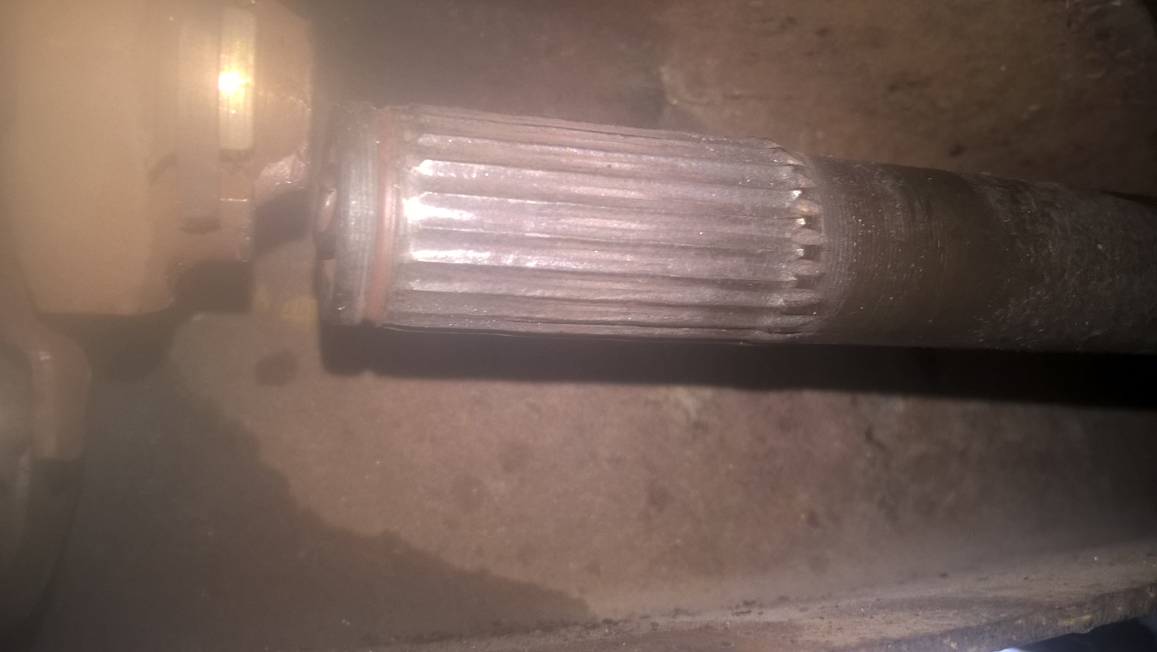

The splines on your driveshaft are badly worn, if you look to the right you'll see the original spline size. Fitting new driveshaft flanges would probably get you mobile again but they'll quickly wear and fail again. Much of this spline wear is avoidable and due to lack of maintenance. They're supposed to be sparingly lubricated with grease and there's a small rubber boot which clips onto the groove in the driveshaft flange to keep out dirt and water. (Hint - order some new rubber boots!)
Unfortunately changing the driveshaft means opening up the gearbox but this has been covered several times on this forum (try doing a search, see search option in green line near top of page for previous relevant posts).

To replace the drive shafts, which looking at the pics you need to do, you do need to dismantle the diff but you must mark and reassemble the main diff taper roller bearings exactly as they are to retain the most important crown wheel and pinion backlash (y)

What Toshi 975 says is correct if you dismantle the gearbox piece by piece or start changing the diff bearings etc.
However, if you remove each diff side plate complete with bearing outer race and adjuster ring as one unit as shown in the above picture guide, you're unlikely to have any problem after reassembly as you won't have disturbed any of the adjustments. Just don't mix up the side plates!
Don't get into a panic over this job, it's not difficult as you're not setting up a diff.

Thanks for the tips and tricks. Not having to mess with the diff set-up is the secret to success in my mind. I can actually source axle kits locally (quite a saving on shipping) ....they are quoted as "large diameter" as an improvement over the standard 19mm ones. Am I correct in the assumption that assuming the boots provided are suited to the larger shaft diameter, this will not cause any problems within the diff during assembly.
Providing you get drive-shafts, rubber-couplings and oil-retaining boots with oil-seal diameters which are all matching, they will work well. The larger 24-25mm diameter shafts will fit the diff. without a problem. Double-check they are supplying the correct length for a 500.
