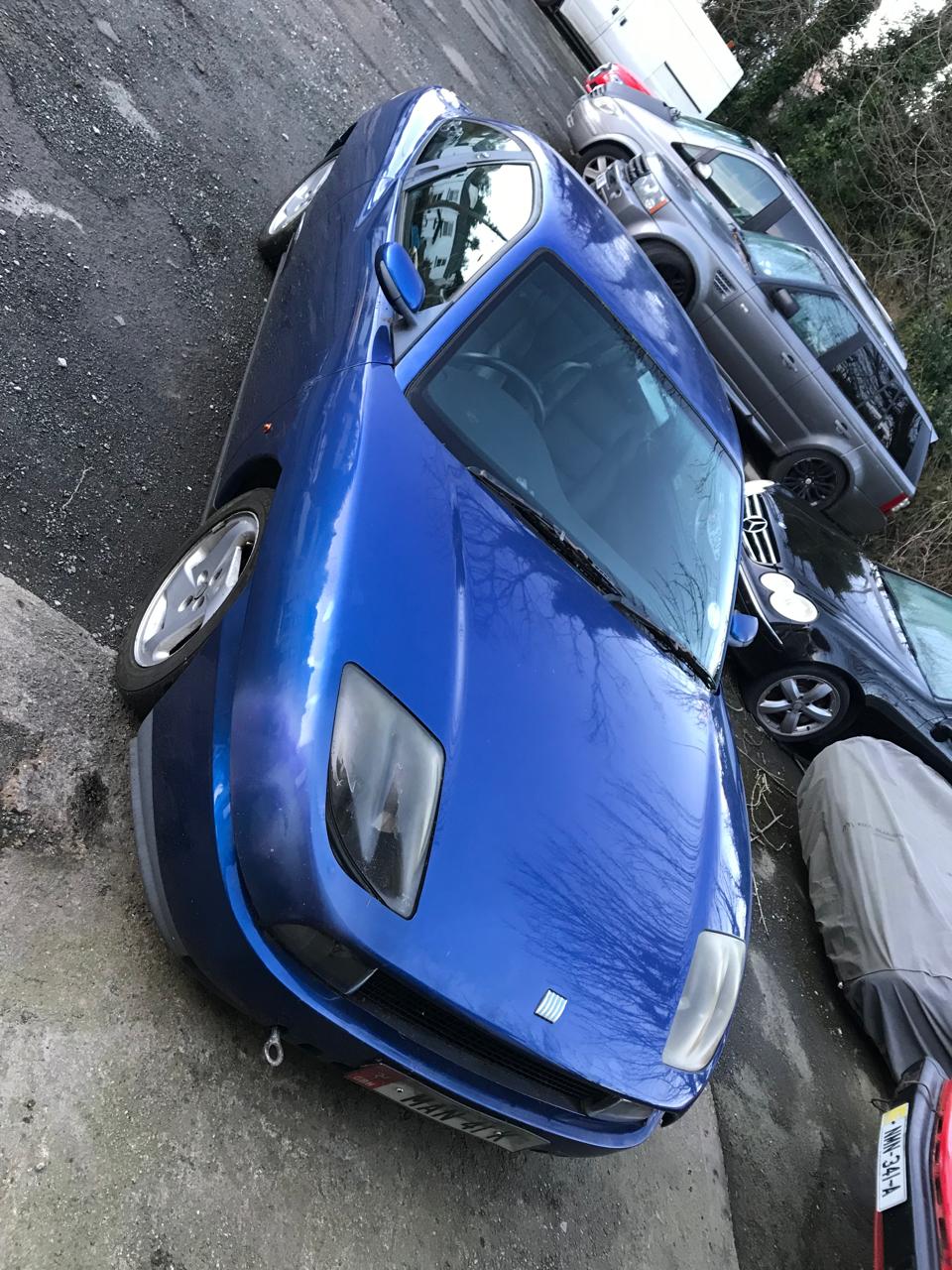

16v 1995 Car won't start no spark or fuel just turns over injector light stays on
I need to know what diagnostic process I need ,program ,tool ?
I have no experience with coupes at all

Is it possible it's an immobiliser issue?
Try a spare key if you have one as injector light can be on some makes referring to that.:)
This is the era where you had Blue Slave keys
And a Red Master
It spinning isn't controlled by immobiliser
Traditionally fuel injection IS a function controlled by Immob
Not sure if sparking is 🤔
