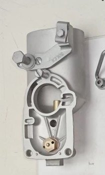

personally I like the Solex PBIC style carb for a single downdraft... you can get a cool manifold / valve cover from Nanni Motori to suit a PBIC carb too.
The solex while it may seem large at a 34 butterfly, the internal design of the solex (it puts the emulsion tube right in the centre of the barrel) is by design restrictive, so needs the larger barrel size. Its advantage is it atomises the fuel very well
I'm using exactly this setup on one of the two 550cc high performance builds I'm doing
The 32 and 34 PBIC carb was an Abarth upgrade for the 595. (was also used on the 850TC Fiat 600 and as an upgrade for the 850's too)
Pretty sure the base pattern of the PBIC and other common webers / dellorto's like the FRD series delloroto's and the IBA and ICEV webers too, so this valve cover / manifold will suit those carbs too. Downside of the PBIC is it's installed height. and FRD or IBA is shorter overall.
SteveC
View attachment 482171View attachment 482172
SteveC

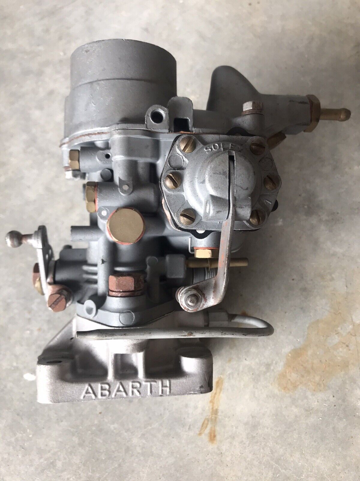

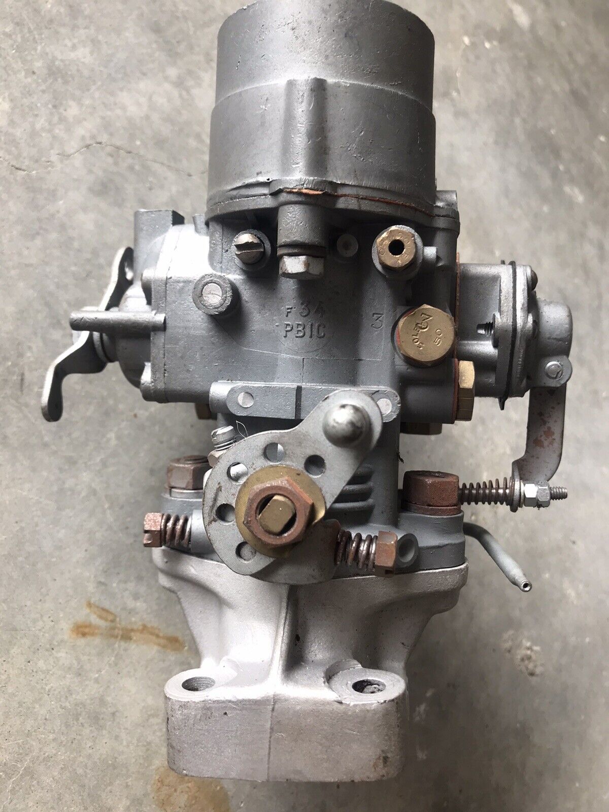

and I found a NOS genuine Solex 34PBIC 3 from an 850TC, it comes with the 28mm venturi
you just have to know what to look for!
View attachment 482180View attachment 482181

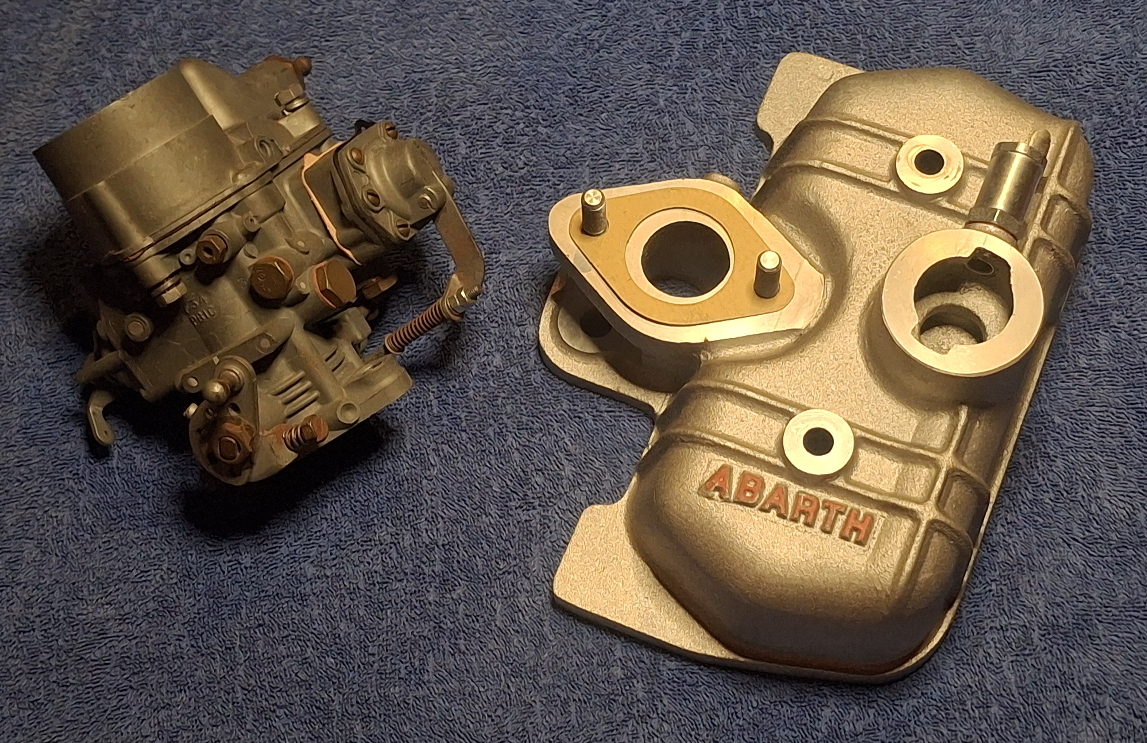

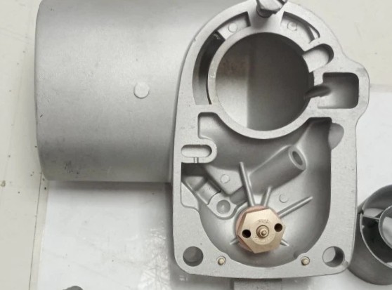

For anyone following along, this is how Abarth got around the overall height problem with the 34PBIC, they cast up a special carby top cover that angled the outlet 90 degrees.... these are real hen's teeth.
sorgente_896037.d1655916082.jpgsorgente_896038.d1655916083.jpgsorgente_896039.d1655916083.jpg
not mine, pics found on the web just for reference
SteveC

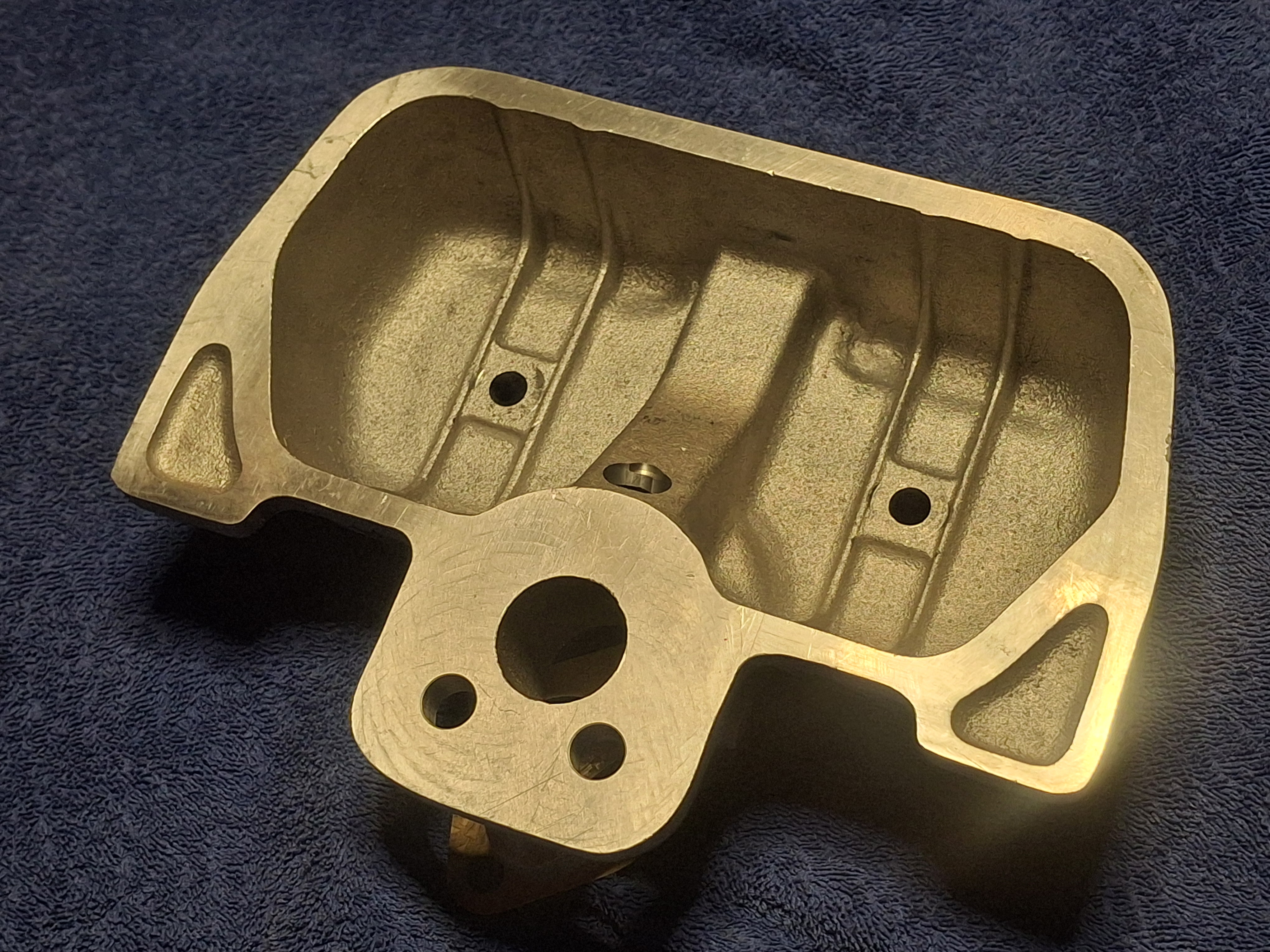

what do you think? here's a pic of a 34PBIC "abarth" style top next to the 32CBI top as best as I could get them from online pictures
SteveC
View attachment 482486View attachment 482487
SteveC
Very interesting---just got to find one!
