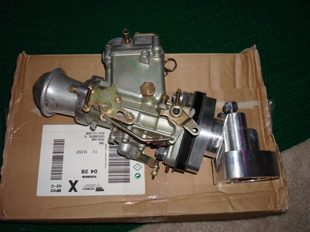

Hi Chris
I just bought Mark's spare FZD. Looking at the pics I assume that I'm going to have to swap around the throttle linkage to get it to work on the 500. In the first page of this thread, you say this is possible, but not all of the parts are available - is it just a case of replicating the linkage on the other side? So for example making the reverse of what's on the rear and fitting it to the front?
Thanks
Steve
Hi Steve,
The throttle lever should be on the correct side for mounting in our cars.
The part illustrated in the above photo is the choke 'lever'. This is the bit - particularly the butterfly shaft - that is mirror imaged and also the bit that is unavailable (unless Andrew has found some). If you don't need a choke, you don't have a problem.
I think that is part of the issue with a lot of these carbies - the choke was never used and most likely disconnected resulting in the interconnecting levers and rods being lost over time. Also from what I've read, these carbies were often fitted in pairs (on Minis etc.) and would have had different means of linking and activating the chokes. Hence the confusion now, where you separate what would possibly have been a mirrored pair of carbies and sell them individually.
If you are looking for one of these carbies to fit our engines, try to find one that has all of the interconnecting parts on the rear side - the side without the writing on it. Either that or we need to start making the bits for ourselves.
Chris
Thanks for the quick reply Chris. Sorry I should have added pic of the other side too...
So, if not using the choke, could you please tell me what parts do I need to source/make to fit to this side?
Thanks
Steve
Steve -a manifold, thermal spacer connector rod and gaskets are the external parts required.
I don't have my carb to hand as its with the engine builder - when I have it back I will photograph it and communicate my findings.
PM your email address and I will send you my photos of a number of FZD's from a second hand source that i have for info purposes.
Thanks Andrew, email sent. Ok that's clear, I just wanted to make sure I wasn't missing anything. When I place my next parts order, I'll get the manifold and gaskets. I already have a thermal spacer.
cheers, Steve
a thermal spacer for an FZD?
it sits between the manifold and carb and is special to the carb type ......I think

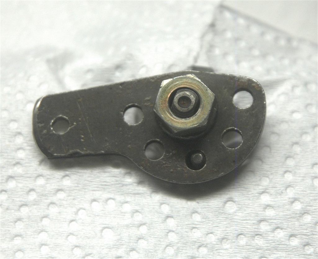

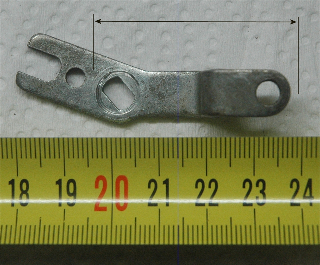

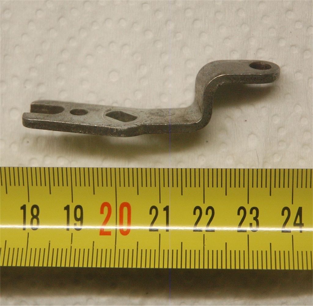

Hi Steve,
All you need is a suitable throttle lever and any decent carby service place will have a wide selection. The choice of ball fitting or hole for the throttle linkage doesn't matter as once again suitable parts are readily available for either. Something like the third photo might work well.
I've attached a couple of photos of mine to give you an idea of dimensions and the angle of the slotted key. If not using the choke, you only need the bit between the vertical lines and depending on your linkage, the double 90 degree bend may not be necessary either.
The thermal spacer goes between the base of the carby and the manifold. They are available and I would think that they should be common to any 32mm single throat carby :)
Chris

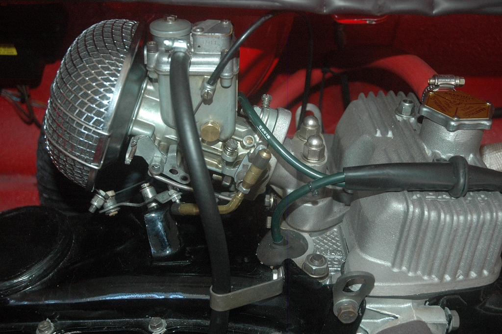

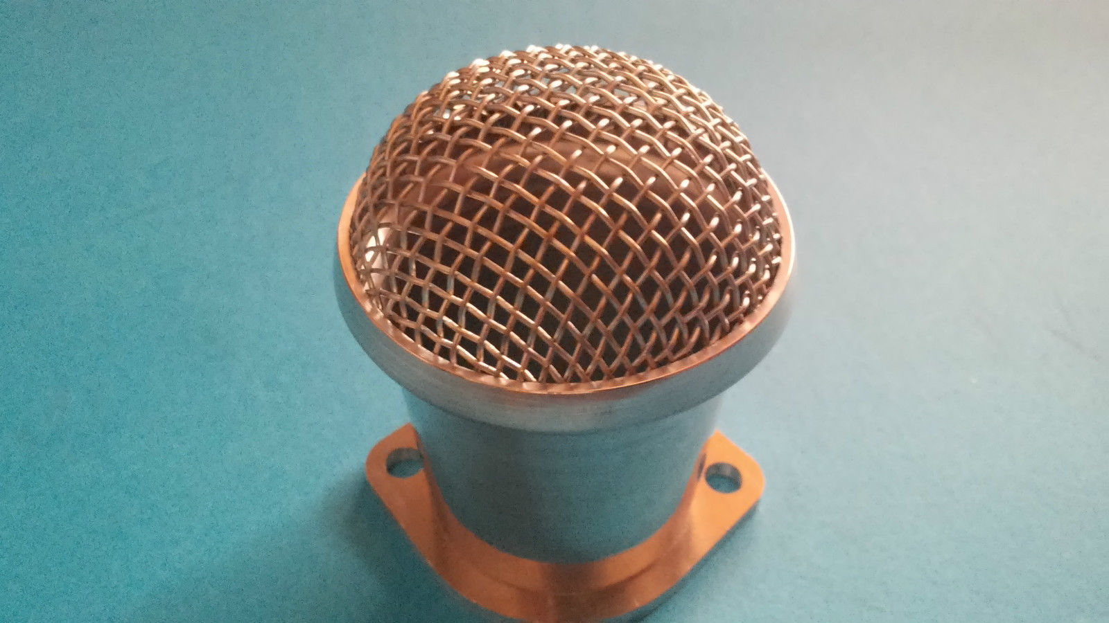

Hi Marcus,
I use a RamFlow filter (1st picture). It works well and sounds good.
I've also used a genuine DellOrto filter but didn't like the 90 degree angle on the inlet (2nd picture).
The velocity stack would be interesting (3rd picture) except that there is really no filter and I'd be a bit concerned about dust and dirt getting into the carby.
Glad you got the problem sorted.
BTW, on my engine I've diverted the crankcase ventilation directly onto the road ... :eek:
Chris

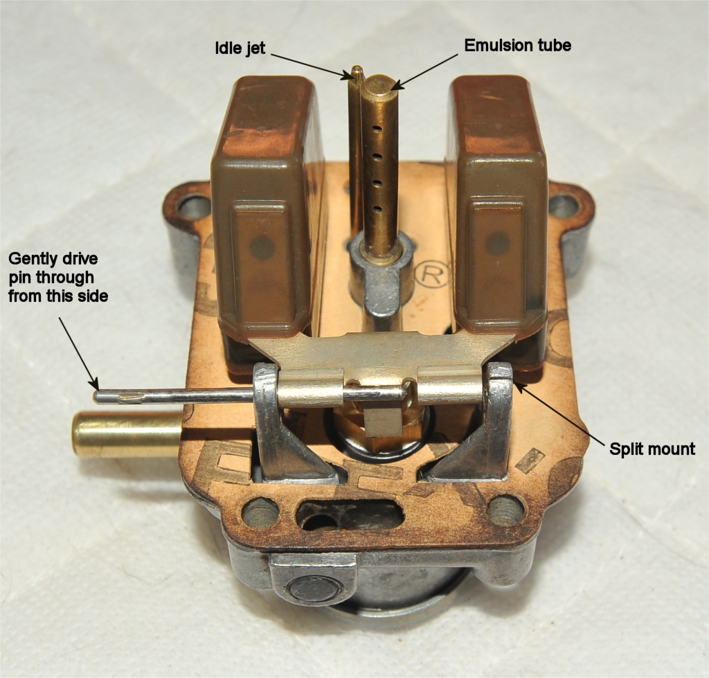

Re: Float adjustment and tuning settings
I'd been looking for this diagram for a while and finally found it - it's the float adjustment.
The float is adjusted by carefully bending the two small flanges that hold the fuel inlet needle valve. The distance (5-6mm) is measured with the gasket in situ.
Hold the fuel cover vertically so that the float just closes the needle valve and measure the distance between the top of the float and the gasket. Once adjusted sometime in the past, most floats do not need readjusting unless they have been abused somehow. New floats should ready to use and need no adjustment.
I've asked around over the time that I've been running this carby and discovered that there is virtually nothing written about the FZDs. If I find any more information that may be of help, I'll post it.
Happy driving,
Chris

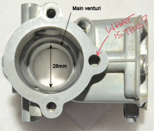

Well, I found my issue and it wasn't jets or emulsion tubes. It was my clever air filter arrangement. I'm my own worst enemy. Just removing the U-Shaped tube and taking it for a test drive showed no issues with acceleration. I had read recently the intake tract length could allow for bouncing pulses and a short air horn/velocity stack is ideal.
So, now I'm looking for a velocity stack with the 3rd hole in it for the crankcase vent tube that allows for a small filter. Not much room in there. Does the Ram Flo mount right to the Dellorto?
I've been wondering what that third hole was for! Can anyone confirm that it is for a crankcase vent tube?
