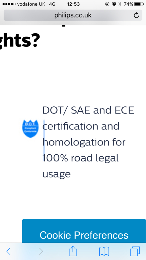

At the bottom of the U.K. Led website.....
Oh and no matter what uk laws say we have to recognise the EU laws, after all you keep quoting the ECE standards which are the EU laws we follow
I don't know where the screenshot came from, possibly a mobile site, but the main UK site lighting page
http://www.philips.co.uk/c-m-li/car-lights/car-signaling-and-interior-lighting/signaling-lighting
Mentions ECE at the bottom, not SAE /ECE, but the page does not list any exterior LEDs only interior. One interior light product page
http://www.philips.co.uk/c-p/127996000KX2/x-treme-ultinon-led-led-interior-lighting
says "ECE beam pattern compliant*
Similar or better beam pattern than standard halogen lamp, to see and be seen better.* There is no ECE regulation existing for LED bulbs. ECE beam pattern compliance is tested on several commonly used luminaires where the LED bulb beam pattern matches the ECE-approved halogen beam pattern"
Confiming what I said about there being no way to ECE E mark an LED replacement for a filament lamp. This statement is misleading and doesnot mention intensity or colour compliance. The package images here
http://www.philips.co.uk/c-m-li/car-lights/car-signaling-and-interior-lighting/interior-lighting
Say interior or off road use only.
