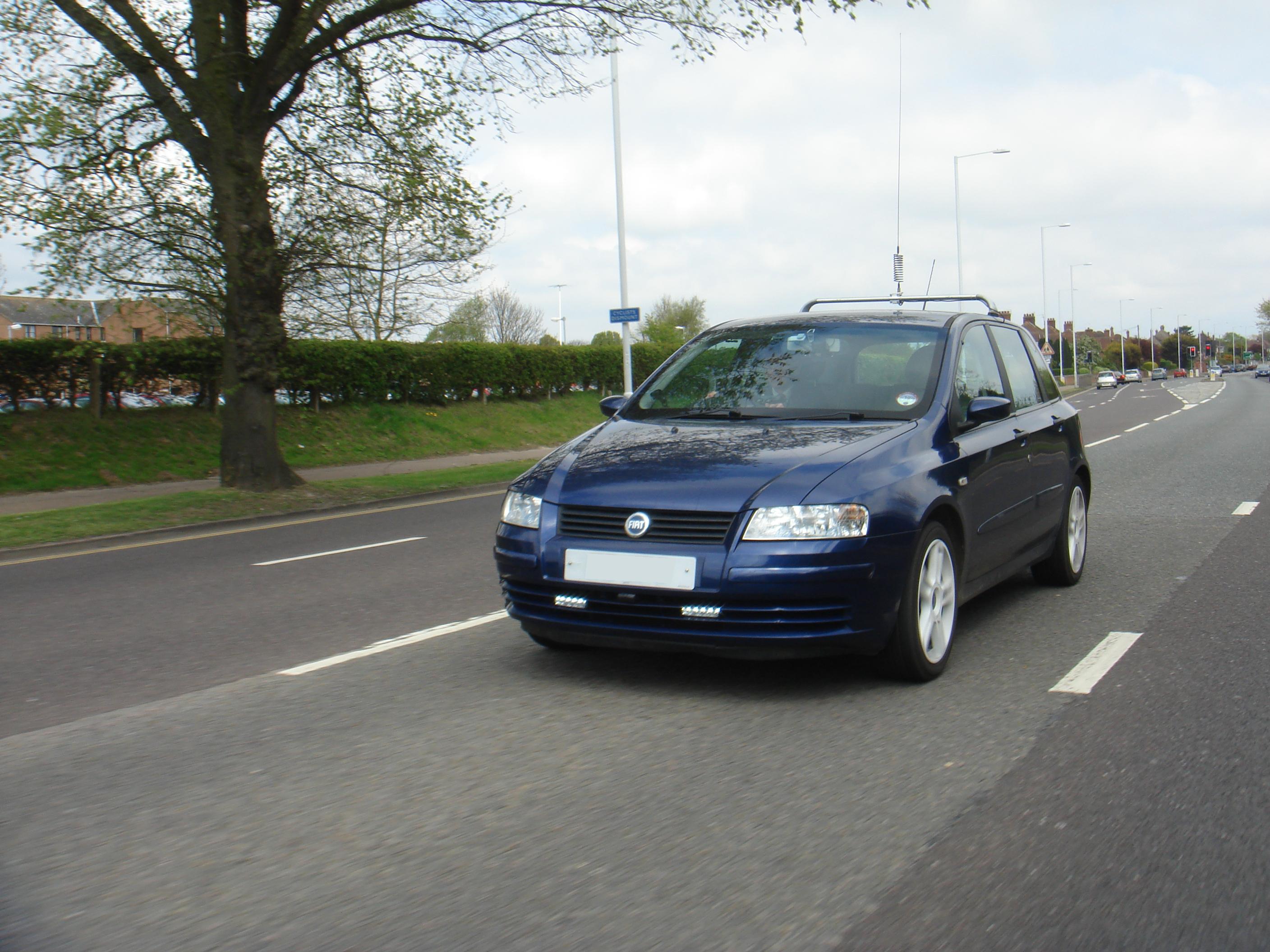

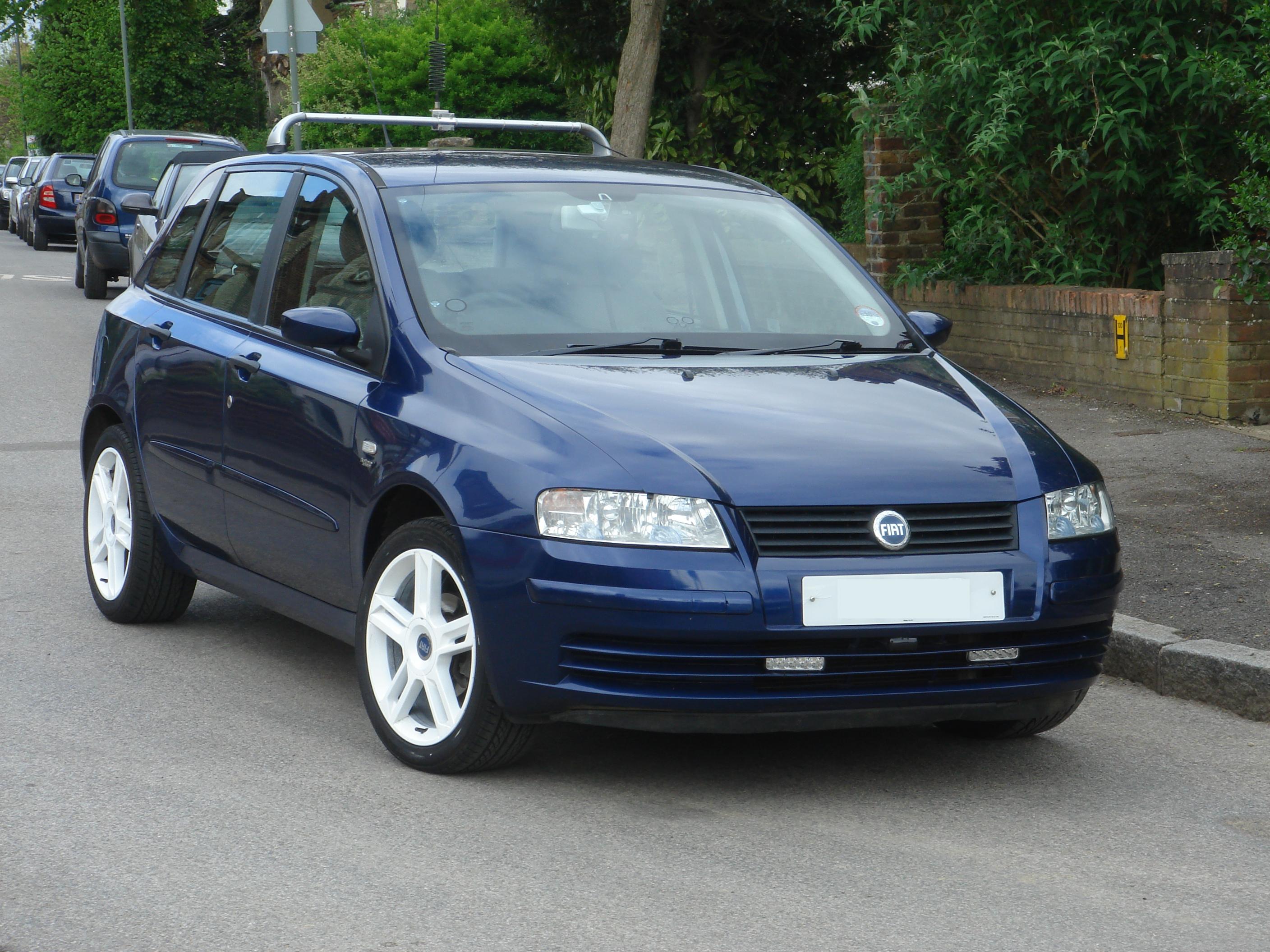

We've their BRL0397's on my old Stilo and Dad's Panda
Angles are not that good on this Stilo pic, so they don't show their full effect
And here they are off
