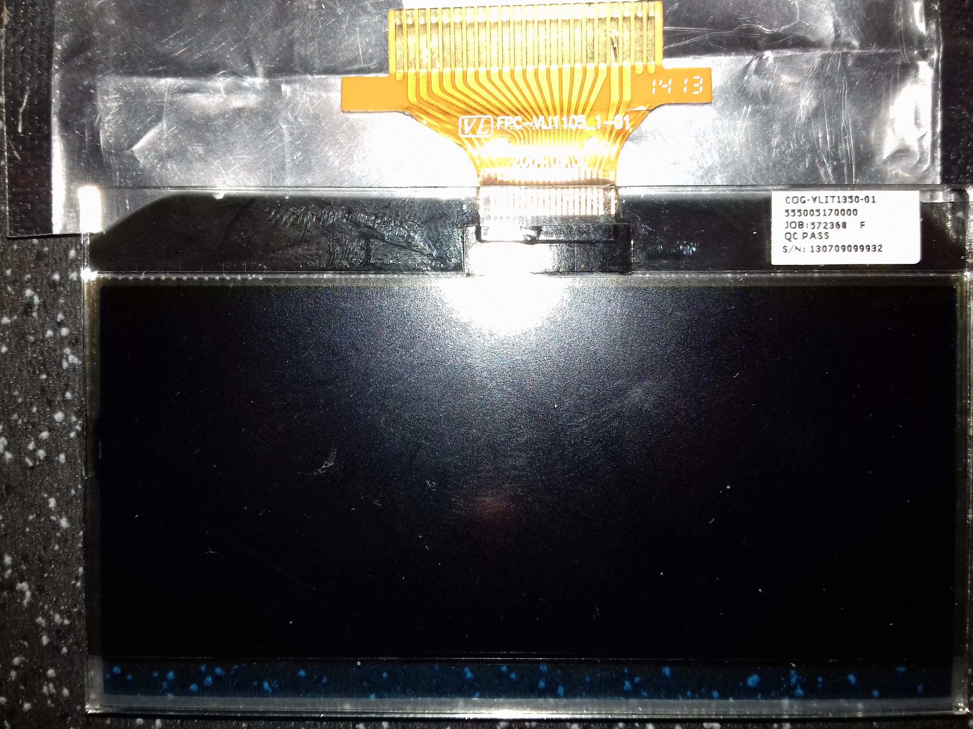

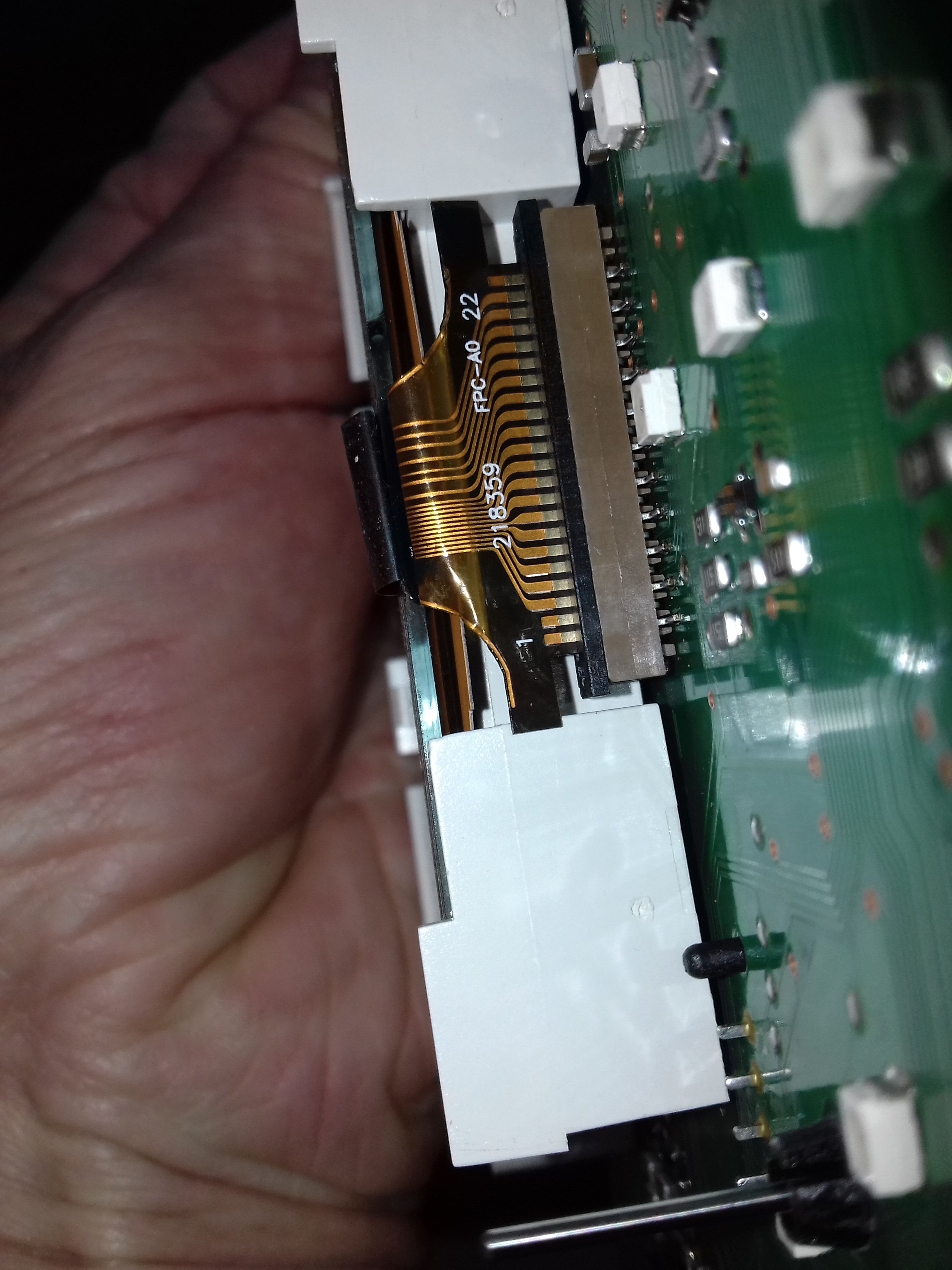

OK,here goes, didn't know how to do this last time so hopefully this will work

Pic 1 only numbers on the panel.
Pic 2 Font of panel showing sticker with numbers.

The part number is the COG-xxxxxxx (obviously your first replacement was for the manual 'box)
There isn't a corresponding COG number somewhere on the original is there?
I'll do some research later anyway
Did you notice the number on the 'New' one; 2004 09 30. It looks like a date but 10 years before the van was built, any significance?
The FPC's (flexi cables) could well have been separately manufactured in quantity (and by a completely separate FPC manufacurer) to accomodate a whole bunch of displays (with different programming and segment arrangements).... so I'd ignore that
The main assembly is the COG numbering, the flexi is just a flexi
Is the COG number not for the new panel, meaing is's not rea;y the right one or do you think that's the original panel?
COG actually stands for (Chip on Glass) which describes the driver IC/circuitry technology, but this manufacturer has just added into the part number framework to ID it.
The numbers will then undoubtedly specify the segment layout and firmware/backlight colour etc and various other technical features/options, a lot of these smaller LCD's are dot addressable (which is how they build up the graphics), but this type I think has pre-built segment graphics.
But even if you google search COG-VLIT" you'll see there's dozens and dozens of different ones , and it's probably one manufacturer (who's simply decided to put COG in the part number to differentiate the COG stock from other types of LCD in their portfolio.
I'm betting that original panel had a part number on it (apart from the writing on the flexi itself, which just describes the flexi)
Tall ask but maybe somebody else has stripped their (auto) one down and there's a pic somewhere when they documented it.
There's no getting away from the fact you need that original manufacturers number.
What actually went on the old panel?... missing segments?, no backlight ?
