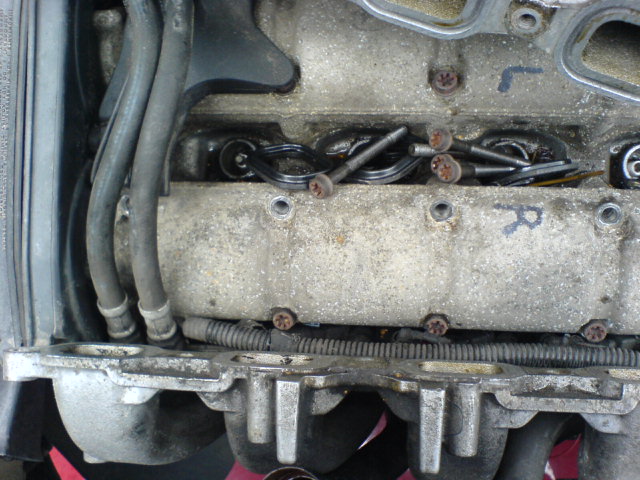

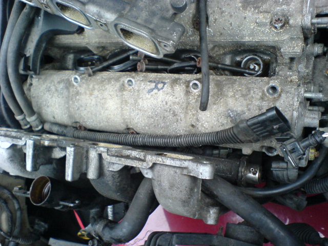

From that picture of the marea engine would you say all the injectors are there? Sorry i couldnt tell when i was there although the connector and wiring was hanging in there.
the fuel rail is still fitted to the head, and you cant reomve injectors without first remving the fuel rail, so i would be very surprised if all 4 injectors are not there. few people wouold bother refiting the fuel rail to a scrap car once they have removed the injectors (why waste your time?)

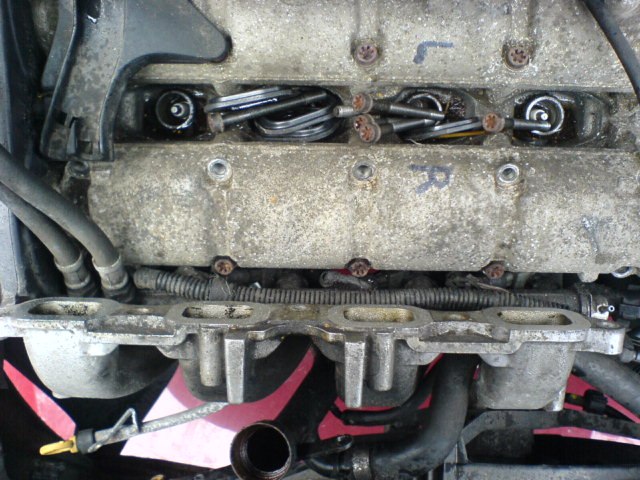

I went back to get the injectors out of that brava today. Checked with the meter first and the injectors averaged 14.5ohms. Are they also close to the end of their life?
This is engine that i was removing them from:
and this is how far i got:
After this stage i couldnt work out how to get the fuel rail out. I must need to remove the lower manifold section aswell? But it was getting late and started to rain so i left. The yard owner told me they will probably be crushing the car soon. So if i go back the car might not be there.
How close was i to removing the injectors? I removed the five torx bolts in the middle but the lower five i wouldnt be able to fit the torx socket on. How is this done? I'm guessing i was about half way there.
cheers
no, you can leave the lower manifold fitted to the head. disconnect the 2 fuel lines (or chop them off on the scrap car to make it easier) and reomve the 3 torx head bolts holding the fuel rail to the ehad, then slide the rail to the right until it is free. you may need to move the battery out the way (i dont personally).
90% of the way there
no need to reomve those bolts.
nah, you were very nearly finished.
