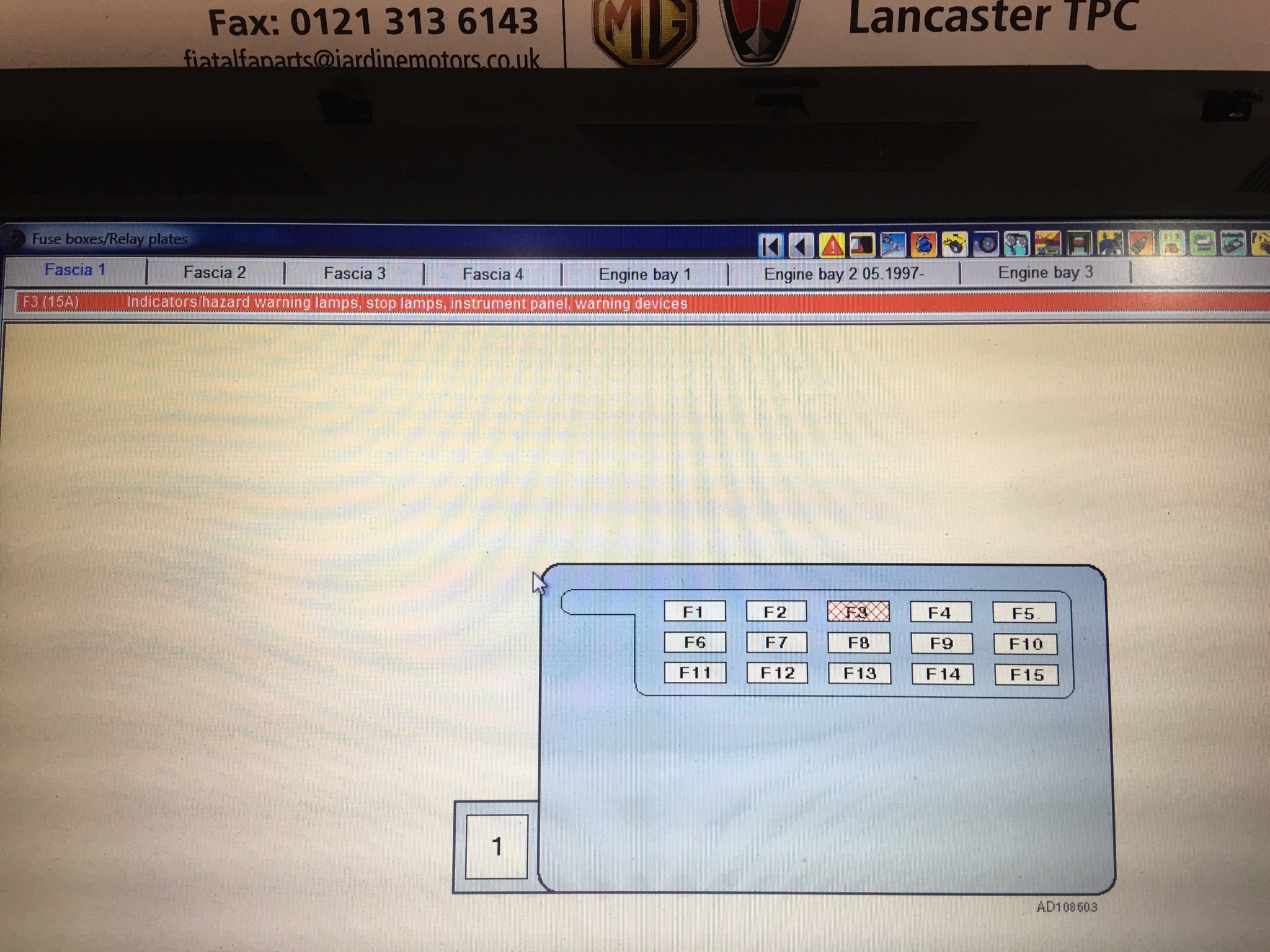

I've got a 2000 model year Lancia Ypsilon Elefantino, which is mechanically similar to the Mk1 Punto 85S and uses all the same mechanical parts.
I have just had total failure of the instrument panel display, accompanied by failure of the indicators and hazards.
I am going to start dismantling the instrument cluster shortly, but before I start I wondered if anyone else had had the same problem - I wondered if there was a big multi-plug inside that controls everything and had come undone (my car has a VERY hard ride).
Anyway, any advice or experiences gratefully received. Thanks in advance - Alan
