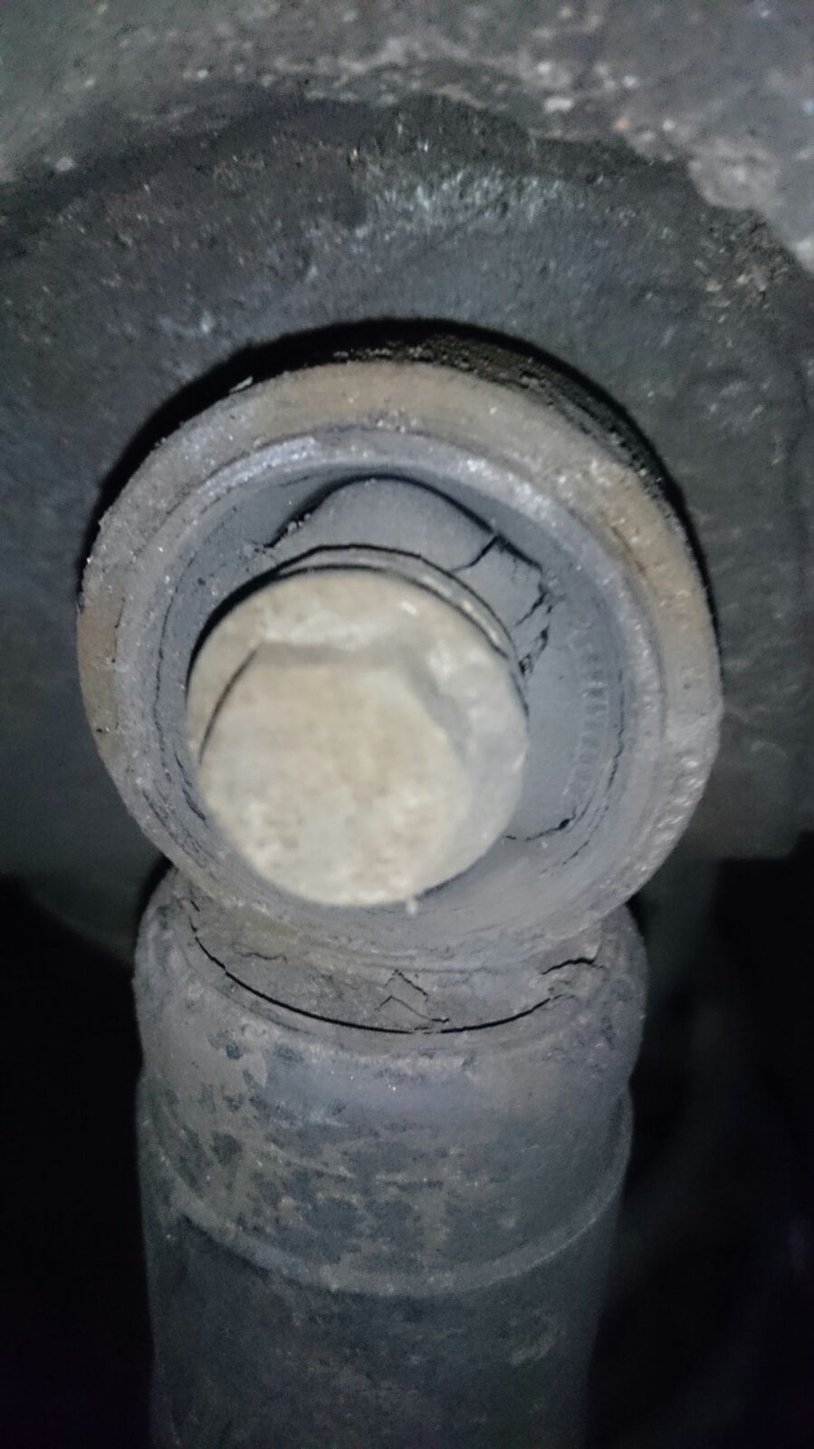

I know the punto handles quite badly at speeds above 60mph. It rolls moves a lot on it own and when trucks pass it rolls even more. Cross winds are the worst.
I bought cheap fiat alloys of ebay so I could put a brand new set of 185 wide tyre on it and it handles much better now than on the 165's. But it still have a tendency to roll but not as badly.

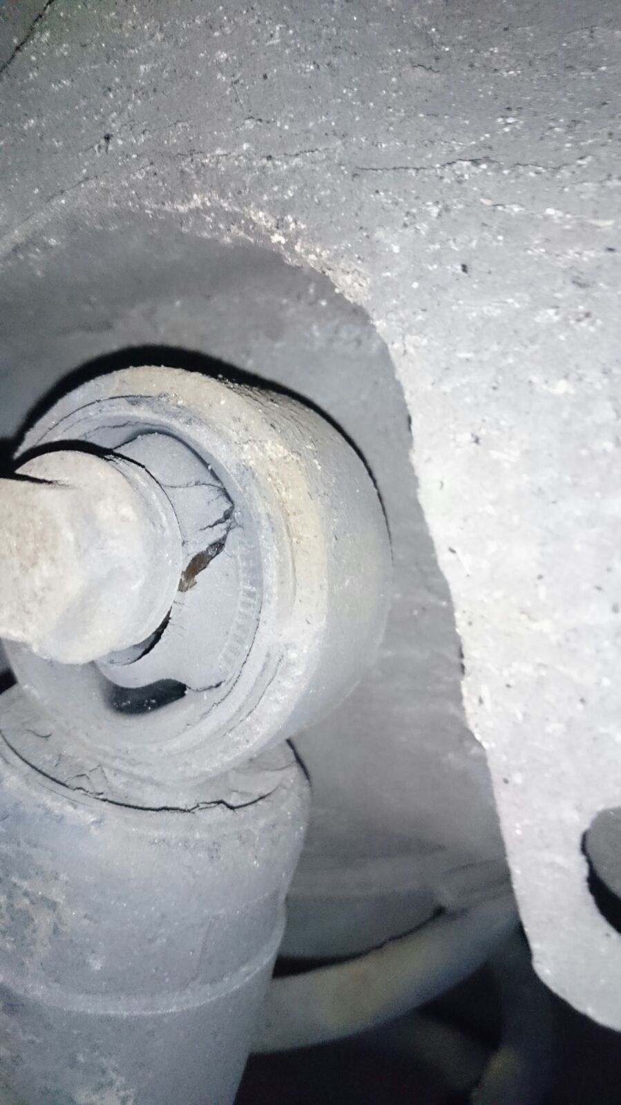

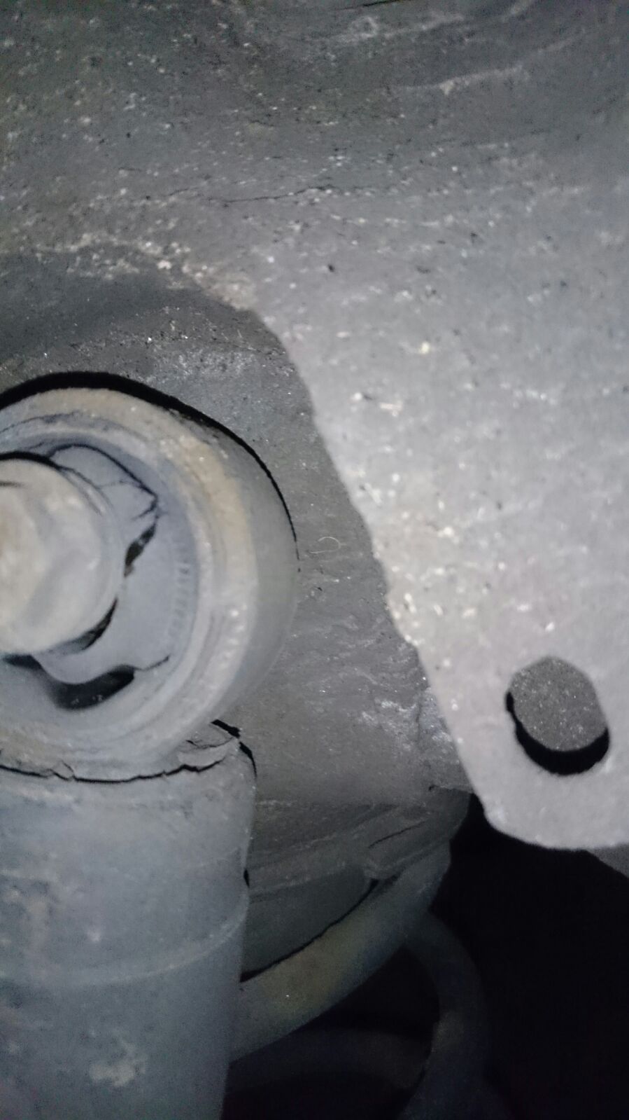

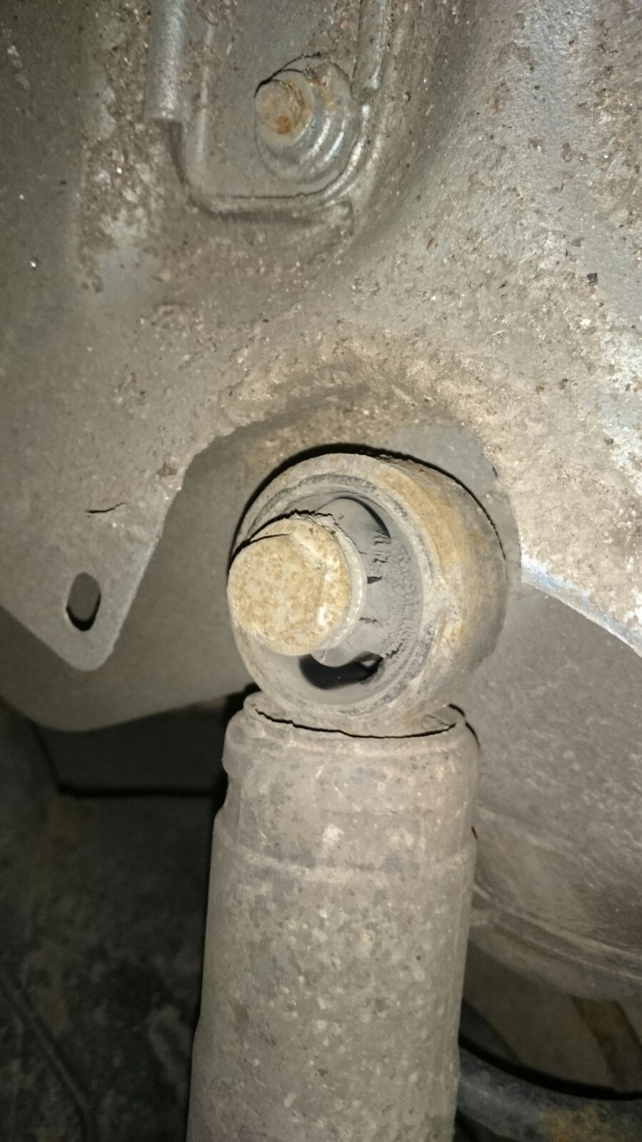

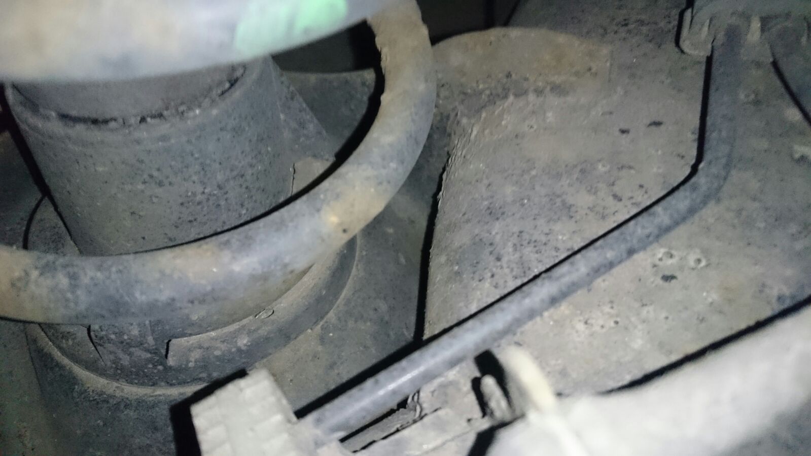

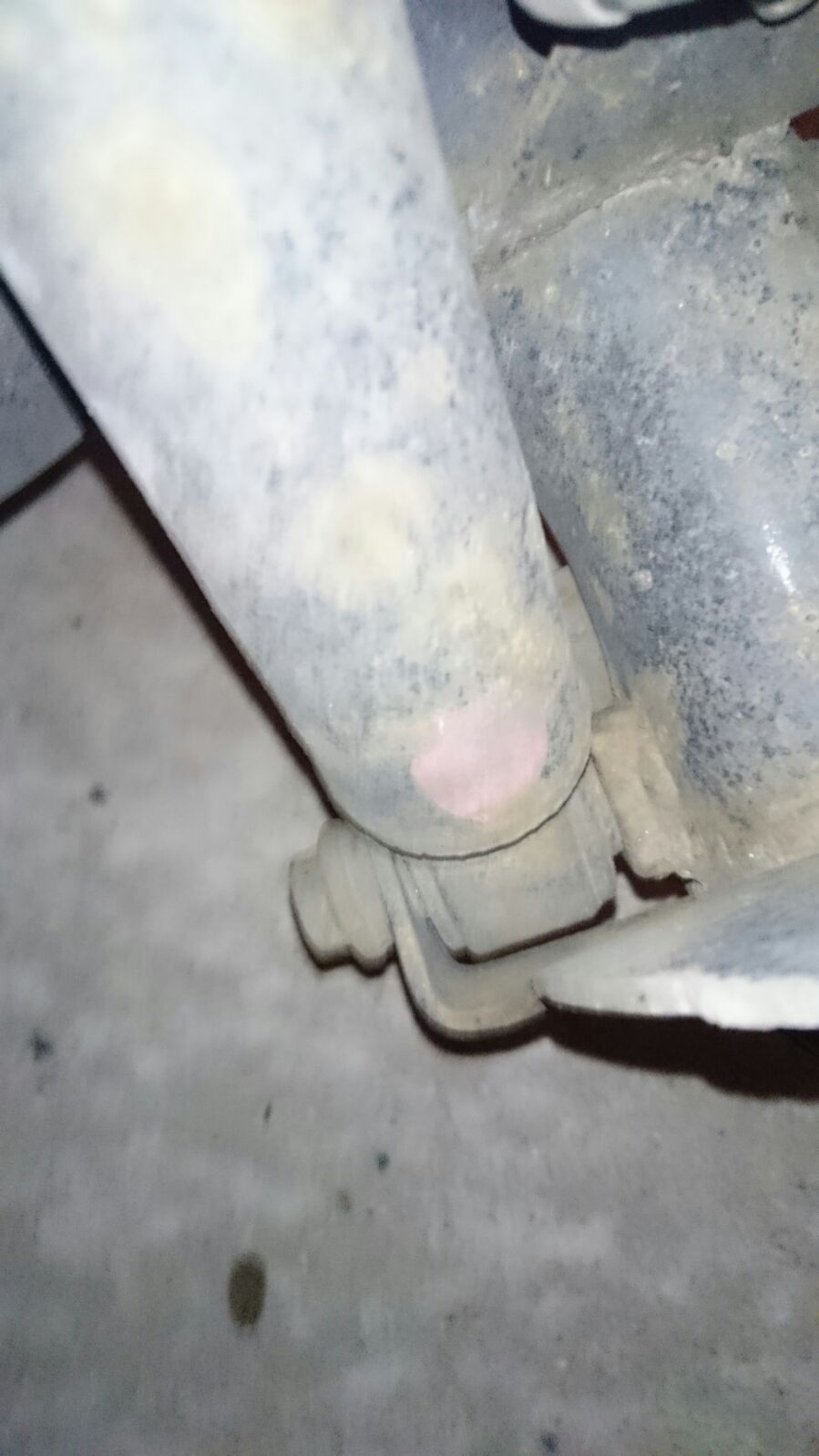

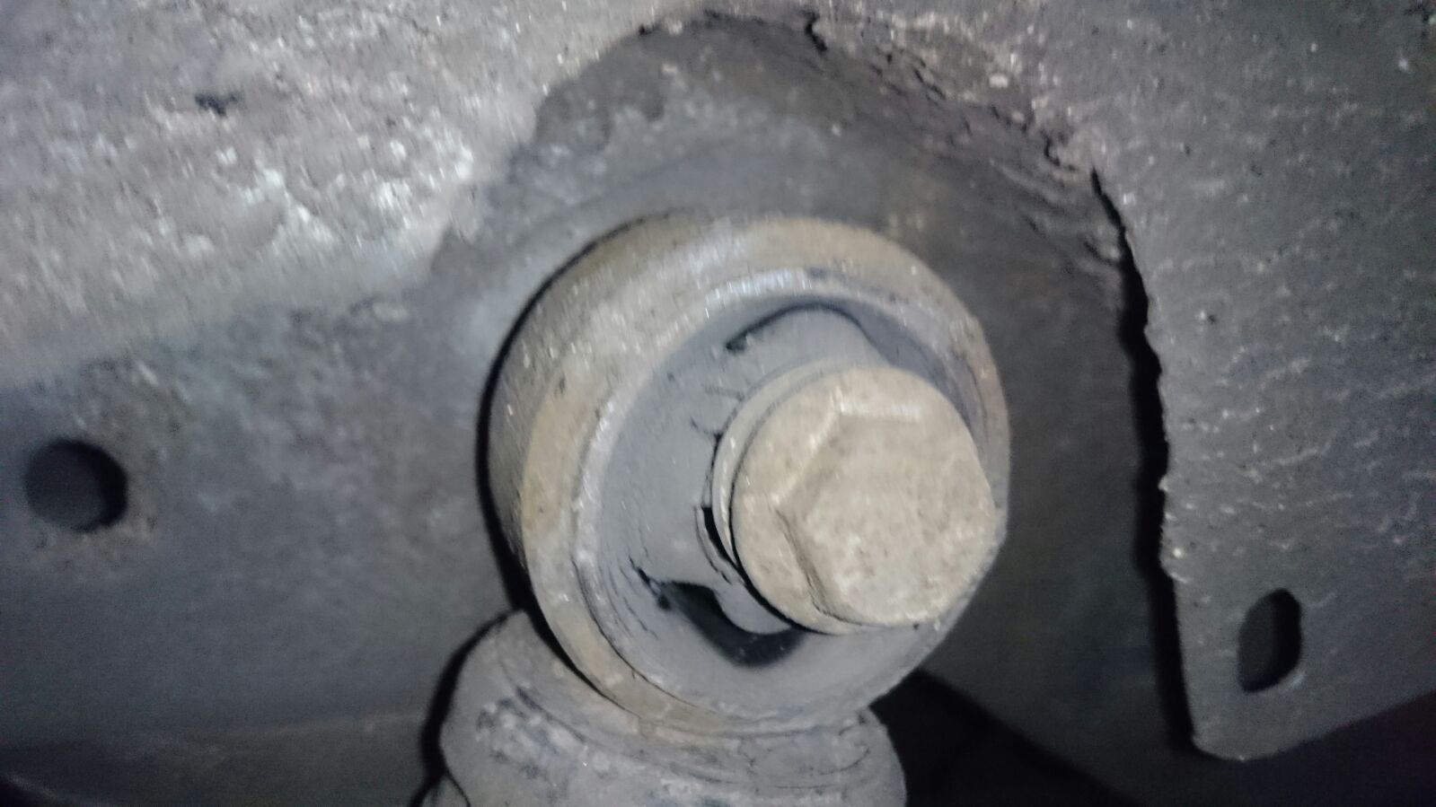

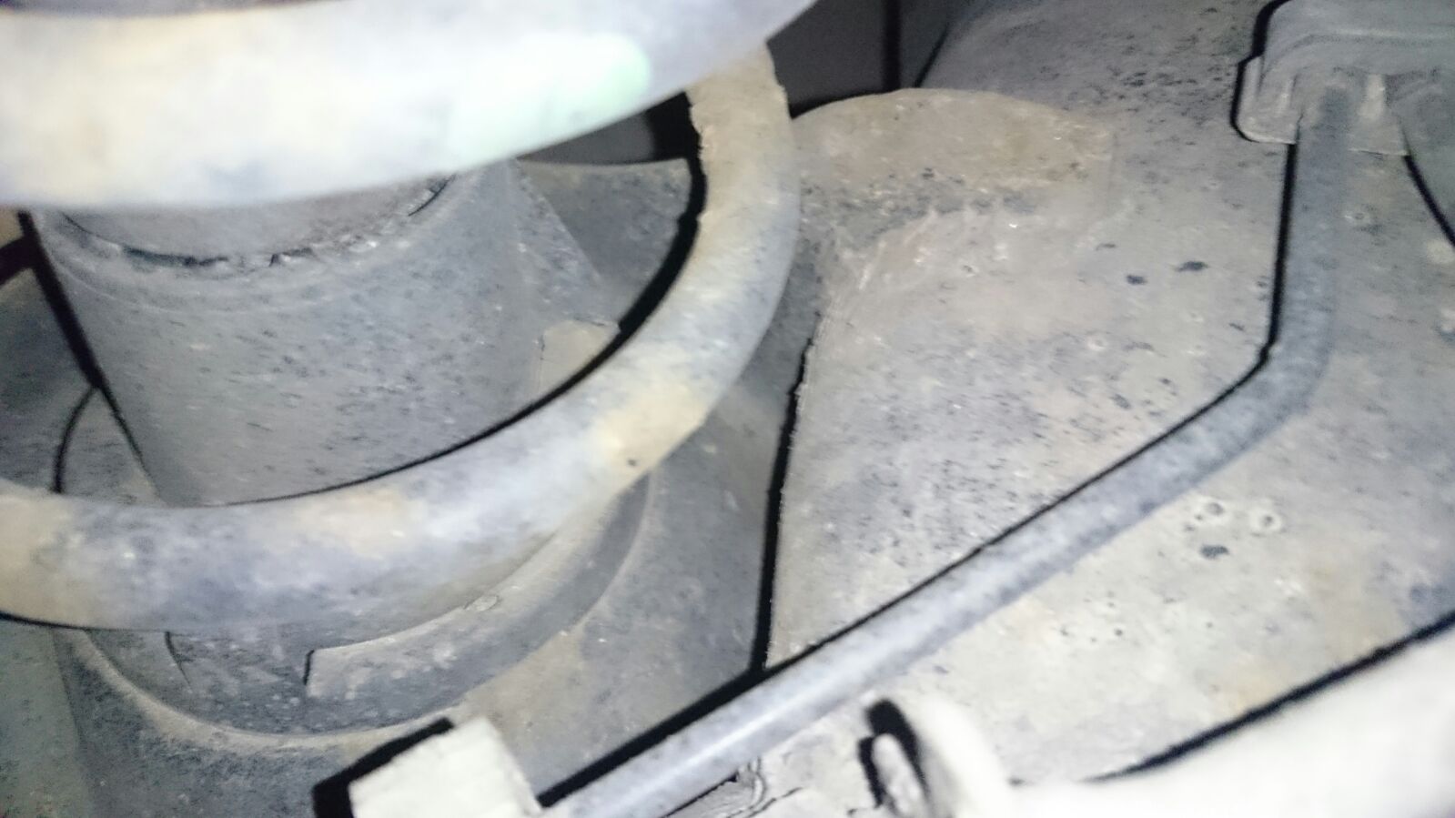

When I replaced the wheels I took some pictures of the rear dampers. Do the rubbers look worn to you and if so how bad would you say they are?
They look pretty horrendous to me but I am no expert. Thanks.

Yup there worn mate
You cannsee the.metal bushing in middle support by the runner has ripped well and truly
So this will moving and not dampening till rubbers finished moving
It wont hurt to replace the shocks
Just start pretreating the bottom bolt as they do like to seize into place
Lots of spray - easy access via rear axle ends

I've had a look at the springs and they seem to be intact although a bit rusty in parts. The tracking is out slightly as she pulls left but the four new tyres I put on yesterday have alleviated a lot of the pull.

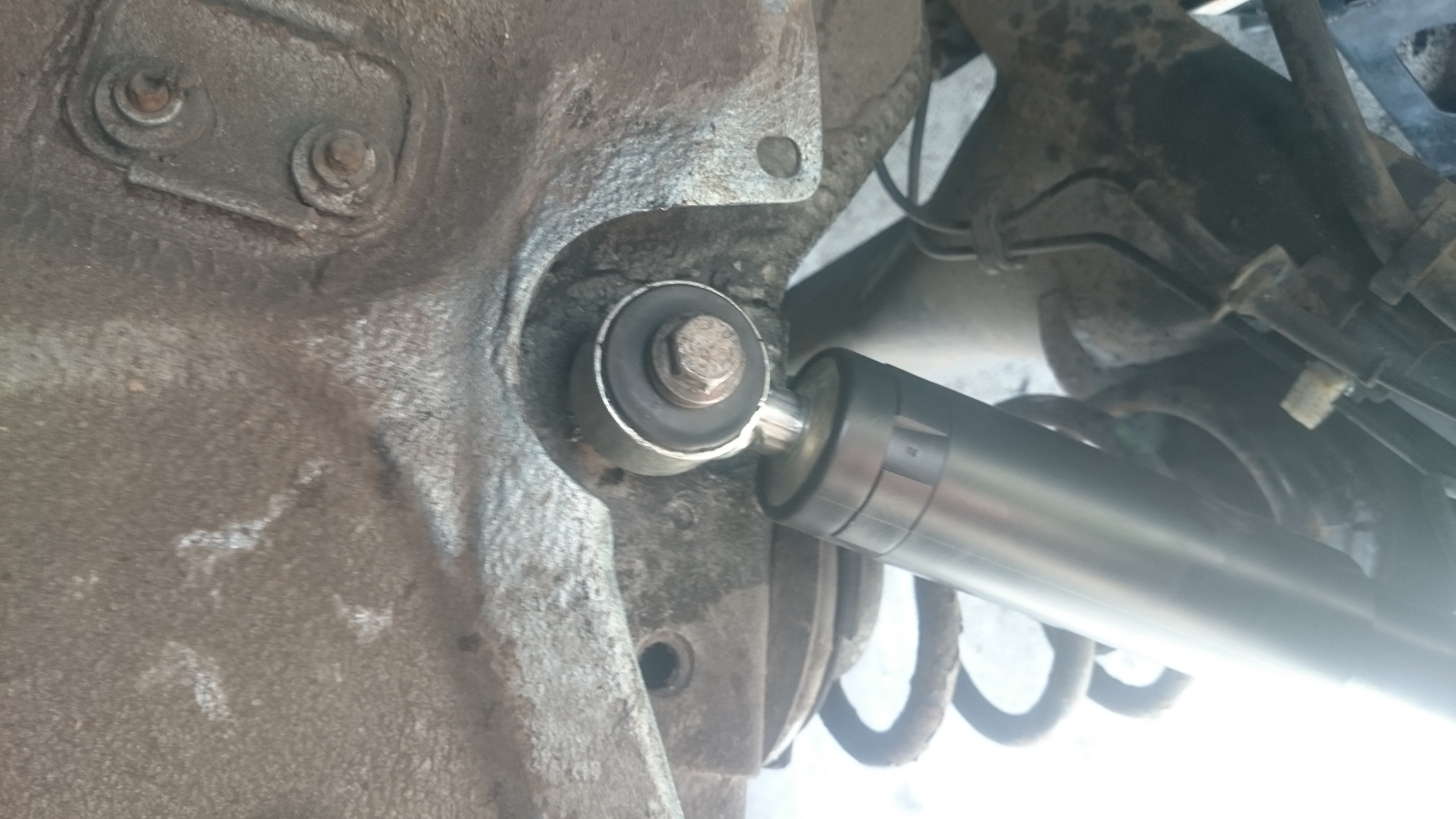

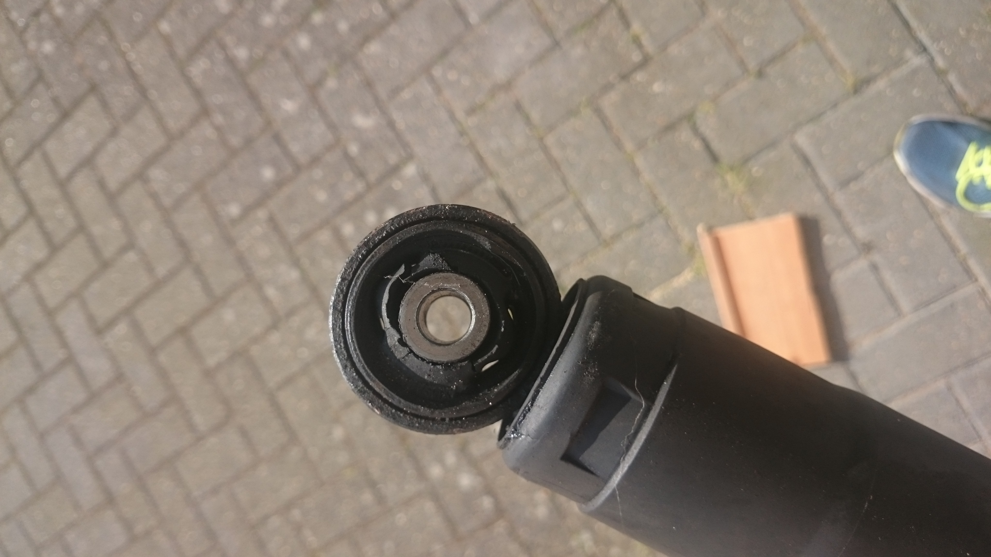

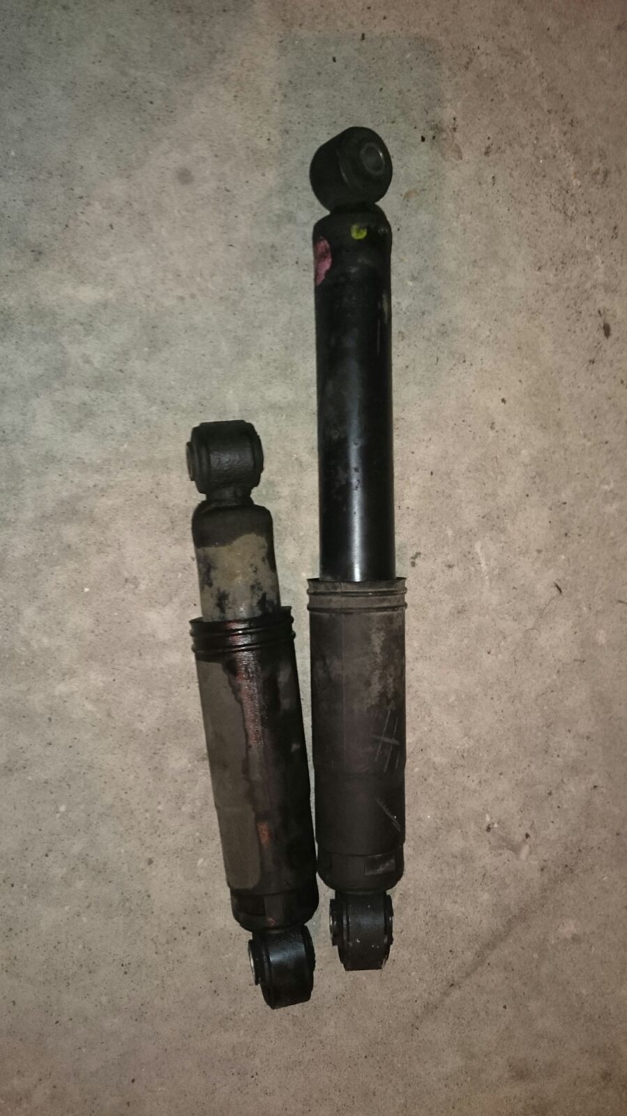

New one is on. Old one was in terrible condition. I changed both sides, both were in terrible shape.
they never went when they were solid bushes like youve replaced with but fiat fitted open ones in all their cooking cars ,panda 500 punto and they all fail very quickly,i searched everywhere to try and buy the eyelet bushes but failed when there was nothing wrong with the shockers
Turns out the left one had failed. The left side always did feel worse and now I know why. Good thing I decided to replace the shock rather than buying some new stiffer bushes.

Yep the old ones looked shot in your photo's
