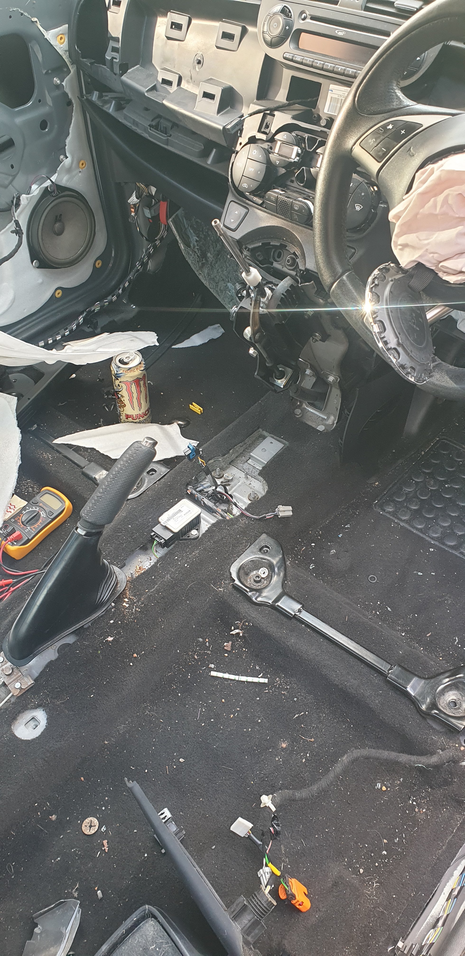

@varesecrazy
Just an idea of what I'm working with...
They even levered out the hazard switch.
I think next step may have to be a wiring diagram, but I'm struggling to find one which is even close.
It's a 595 Competizione 180, but it seems to have various factory-fit bits which are a mystery to me (and the wiring diagrams I've found so far).
