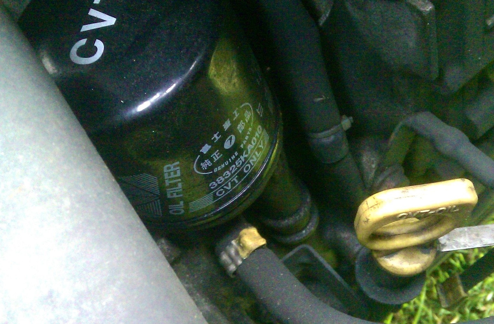

if you have picture of the measurement indicator please post. maybe we are mistaking.
thx,
in cold I can see the oil but it is not between the borders. in hot, when running, it is more visible but but still not between the borders.
can you post a picture of the oil in between the borders?
few oil borders here
is that any help
