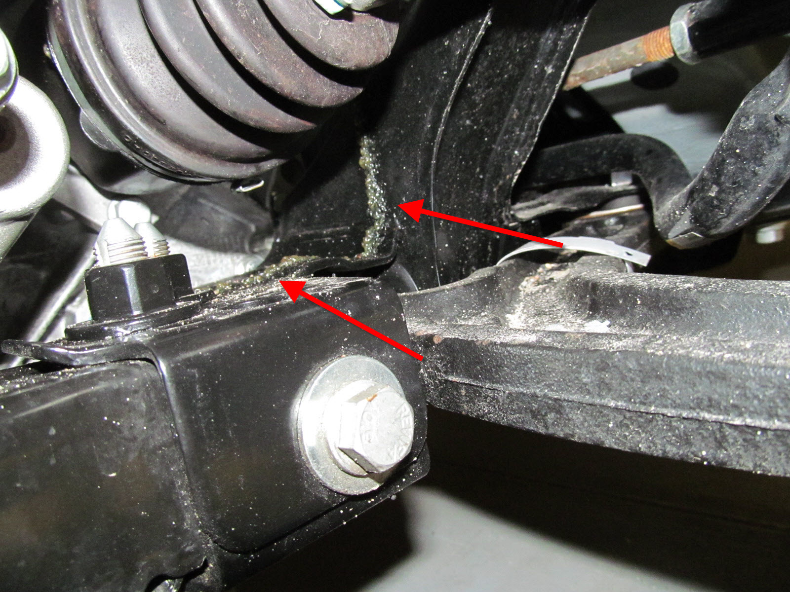

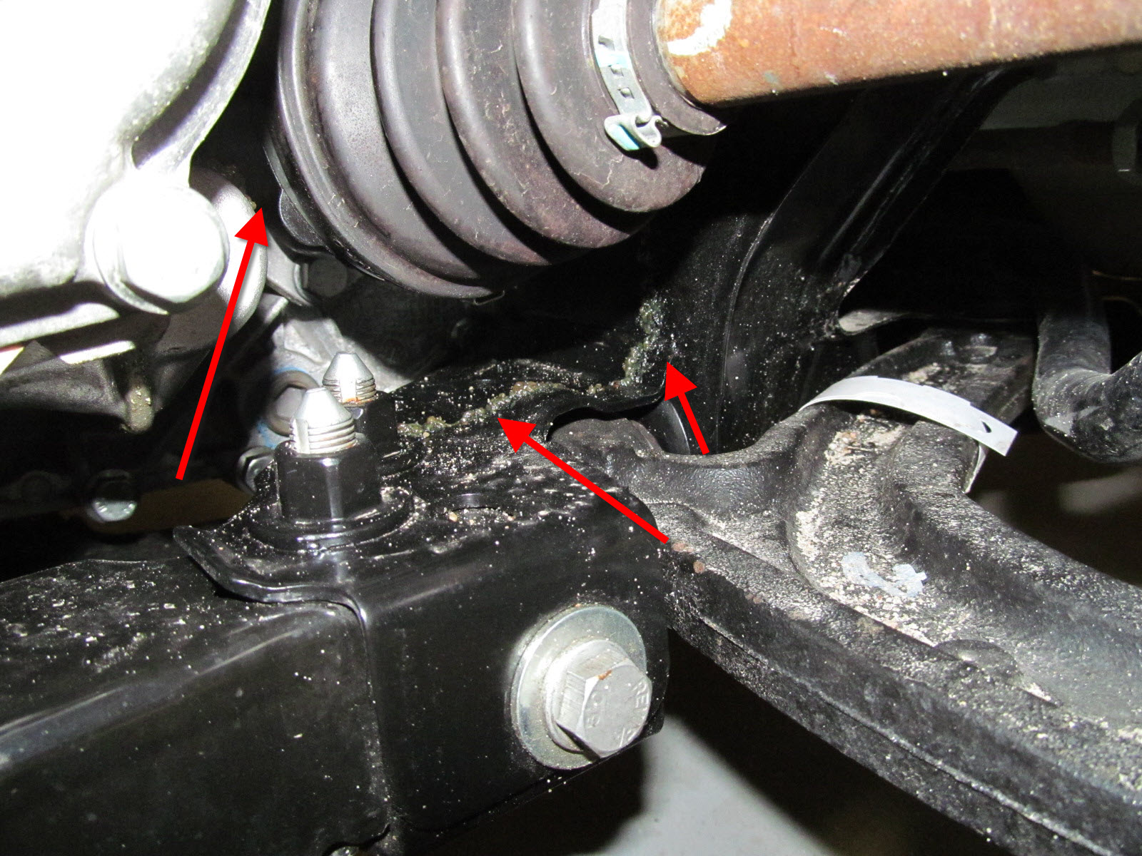

I have probably first issue with A500. At the same day I picked her up from the dealer after covering about 120 km I spotted that there is some grease in the area of left CV joint (the one on the gearbox side). I thought that maybe in factory while mounting CV joints they left by accident some grease on the front suspension frame. So I cleaned it with paper towel and naphtha.
Since this time till today I covered about 1500 km. Today I looked once more in problematic area and again found grease exactly around CV joint (on gearbox, suspension frame etc.). It seems that the metal band on rubber cover is loose and when grease from CV joint is warm enough it goes out of it. Rubber cover itself seems to be OK - there are no cracks on it.
Tomorrow I am going for an engine oil change so I will have Abarth service investigate this problem. Below you will find some photos.

Hi Gregi, in the absense of a split in the gaiter, your diagnosis of a loose clip would seem to be the most logical answer. Although it is possible that the CV joint was overpacked with grease there is plenty of room for expansion inside the boot itself and if the clip was secure should contain the excess.
Let us know how it goes. (y)
Depends how overpacked it is. I've seen numpties *fill* a CV gaiter with grease. You'd expect this not to happen in the factory, but if the grease dispensing machine was having a bad day..
Make sure dealer removes boot and refills with correct amount of grease before fitting a new clip. If the grease quantity was correct, it is now not enough, just tightening or replacing the clip will lead to failure later, possibly when out of warranty. Make sure it is done right.
Excess grease is unlikely as this would waste money, so is likely to be very closely controlled at build.
But you're not actually reading what I'm saying are you? What I'm saying is that it may have been overpacked due to a mistake.
I appreciate what you say, but manufacturers control costs well. This grease will be dispensed by machine, carefully controlled. Could give insufficient grease if it ran out and the operator didn't notice, but unlikely. I suppose operator could double-dose it if distracted, but difficult to add just a little more, as it will be one-shot, or two-shots. This will be done at the driveshaft manufacturer, not by Fiat or Abarth.

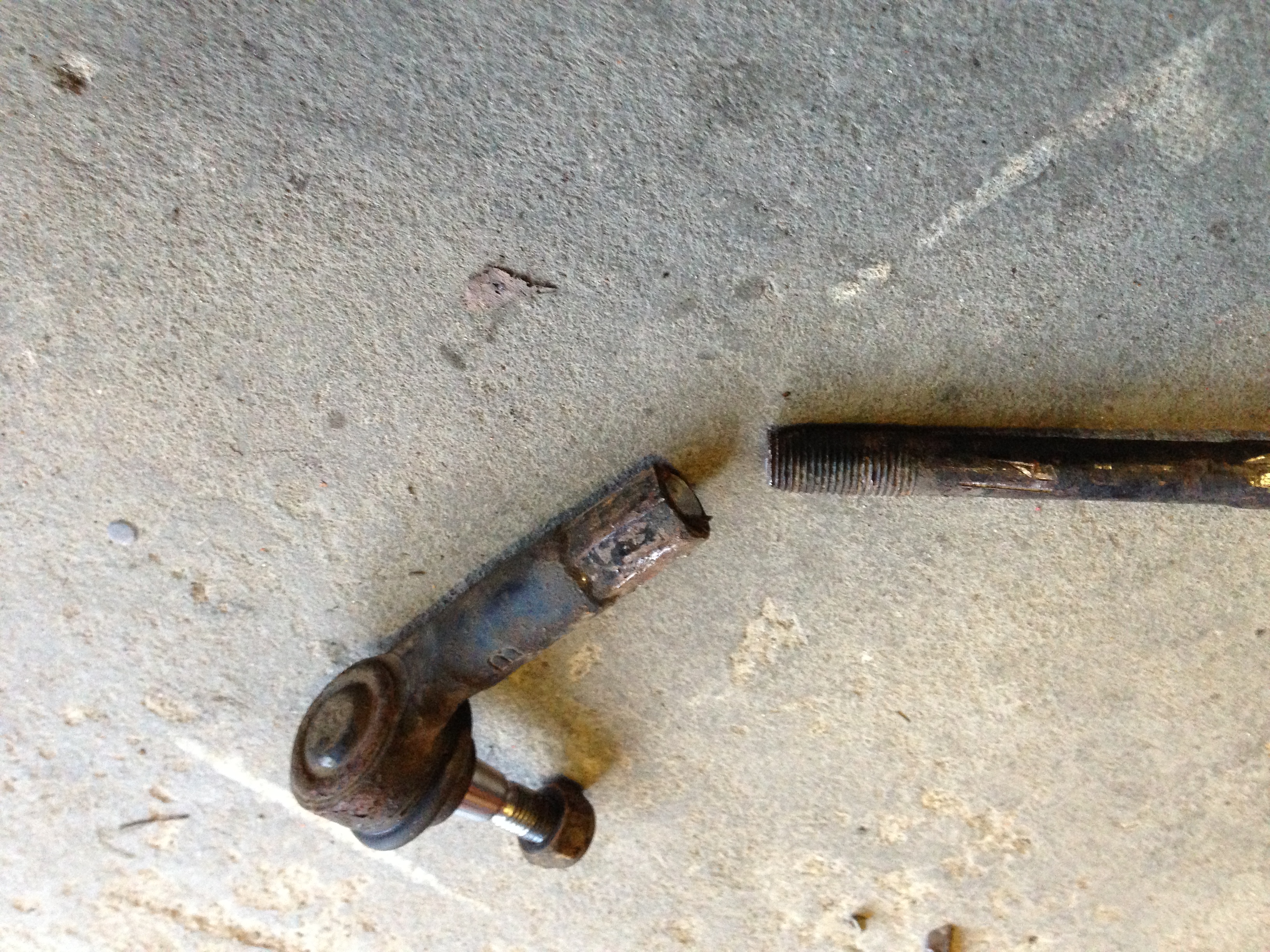

(excuse the jaunty angle, an iPhone photo that always ends up in different orientation when uploaded)
An Audi A3 tie rod a week ago, the inner balljoint had died before the outer (unusual), but not being wasteful, I didn't buy the outer, until I realised the old one wasn't going to come off the old tie rod.
Grease on the exposed threads isn't going to help this though, you need to put anti seize compound on the threads before you screw the outer joint on.
