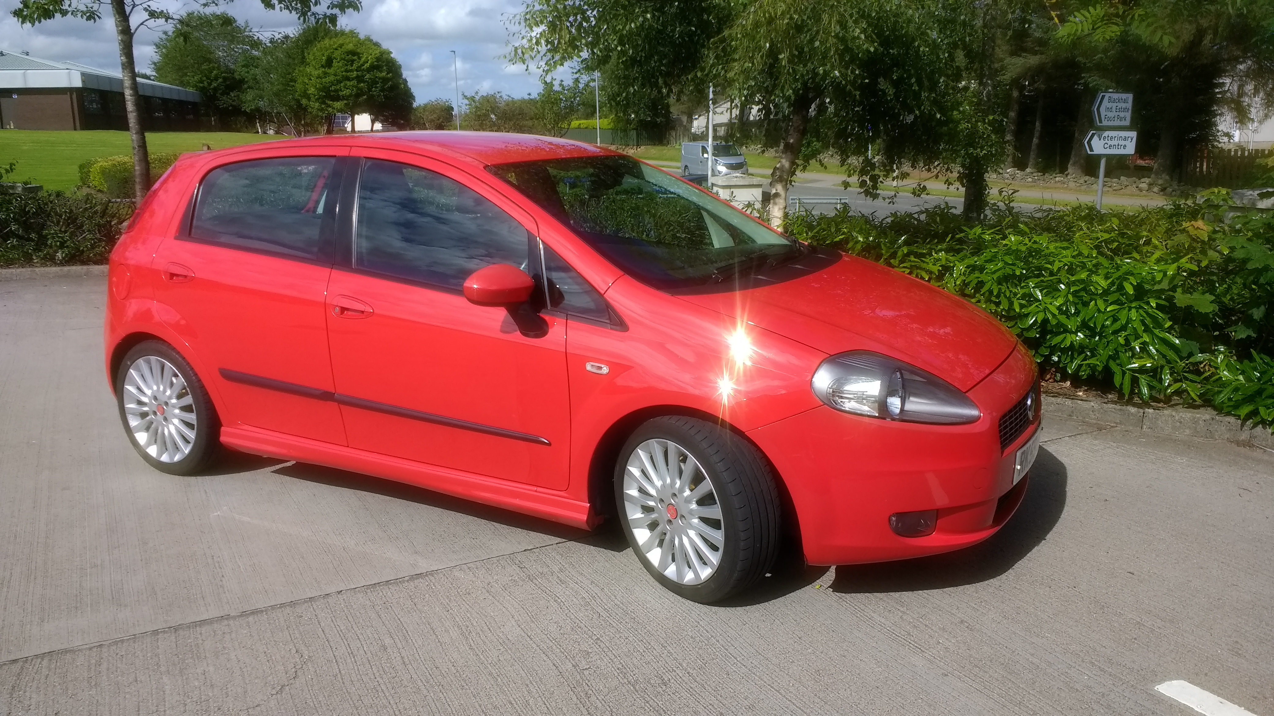

This was not long after fitting suspension, settled a little after pic was taken. Not super low but low enough to have to be very careful I've those modular black and yellow speed bumps.
