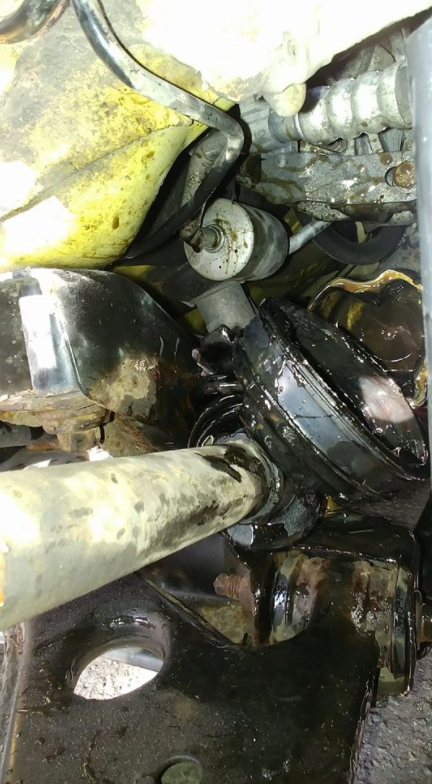

I opted to replace all shocks, purchased the Stance+ Kit from Venom Motorsports. Also decided to replace the drop links with shorter ones and fit new top mounts too! So far so good... right? HOWEVER, it didn't last more than thirty second on the first test drive. Drivers side drive shaft popped out, bearings and needle rollers flew out along with gearbox oil.
Issue:
From what I can gather, now that I've lowered the car, it's become apparent that the driveshafts are 'too' short and can't handle the excessive strain.

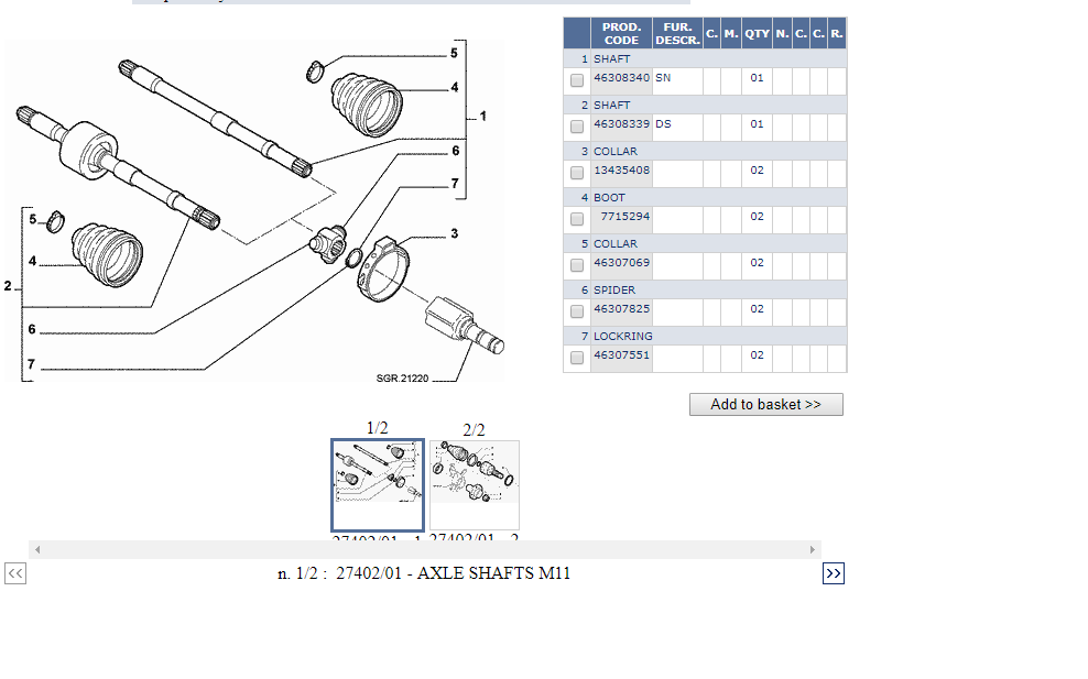

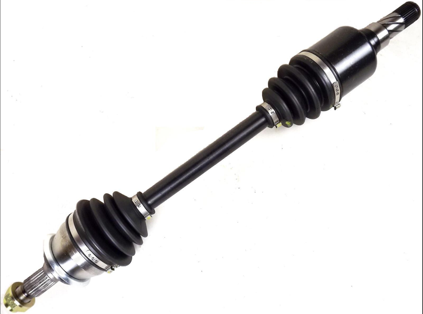

Hopefully you'll agree, but I presume longer drive shafts would rectify the issue as they will sit further in the cup and would then be under less strain. I'd suspect the length in the middle will need to be increased by 230-250mm and reinforced if possible?
