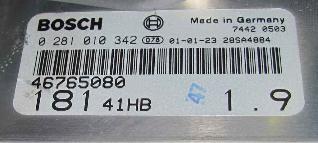

My JTD110 was an early 2001 (Y prefix). It had an EOBD/OBDII 16 pin connector and this
Bosch ECU. Engine fail light was injector symbol. I don't recall the dial style. As stated before, FiatEcuScan reported the cruise discrete inputs changing but cruise would not engage. There was no wiring to the ECU cruse input pins

my ECU.. looks darn similar.. , cannot find any trace off OBD plug.. so looks like I've backed a loser in the "cruise dept".,

Hi Charlie,
It's not an identical ECU so don't give up just yet.

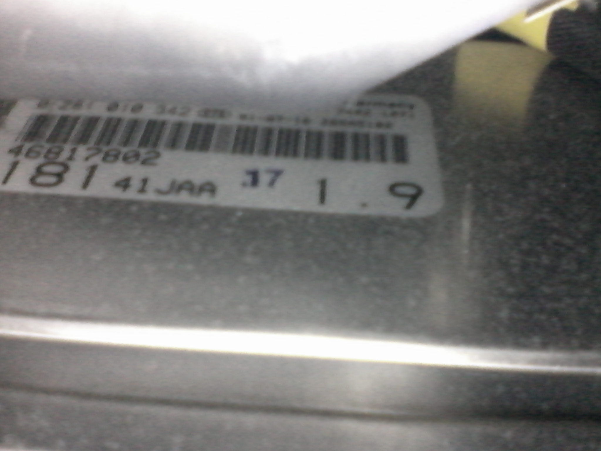

mine does appear 6 months newer.. by ECU date stamp

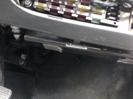

This is driving me crazy, I'm begining to doubt my memory. I finally found the location in the workshop manual
and it appears to be where I first thought. just under the edge of the trim below the steering wheel. One of them (the Pug or Marea, I can't be sure which now) had a black plastic cap and was very hard to see / indentify. The other was hidden behind a loom near a fuse / relay box. The BOSCH ECU you have means the car HAS got a 16 pin connector, not a 3 pin.

OBD Socket = Located..!!:eek:
complete with plastic cap:rolleyes:
It's on the BOTTOM face of the fusebox.. pointing at the floor.
