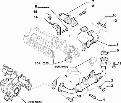

Your EGR valve (according to ePer) is at the back of the engine, bolted to the rear of the inlet manifold i.e. item 7 in the picture. Your EGR valve is totally different to the 150 & 200 ones. The valve will be a long reach to get to because of its position - right in the middle of the rear of the engine bay. I personally believe it's worth a go as excessive EGR flow will help clog the DPF prematurely.
PS "HTH" stands for "Hope This Helps". I like being anonymous in these days of 'Big brother' - I am not a number etc etc etc. :D
HTH ;)
