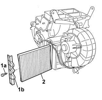

yer i am looking at the rite guide and it doesnt look like that on my car. not even on the driver side or the passenger side. so i dont know wat to do coz the feet heaters are propa terrible and i need a propa guide on how to fix the problem:slayer:
remove the centre console right hand side panel and look propa:)

all these diagrams do not look like mine, i have pulled everythin off on the passenger side and there is just loads of wires and the tube bit where the air come out of. there is no little plastic clips that u pull back to get the pollen filter out or anything like that.
i dont have a clue, just need someone to help me get at it so i can fix the problem:slayer:

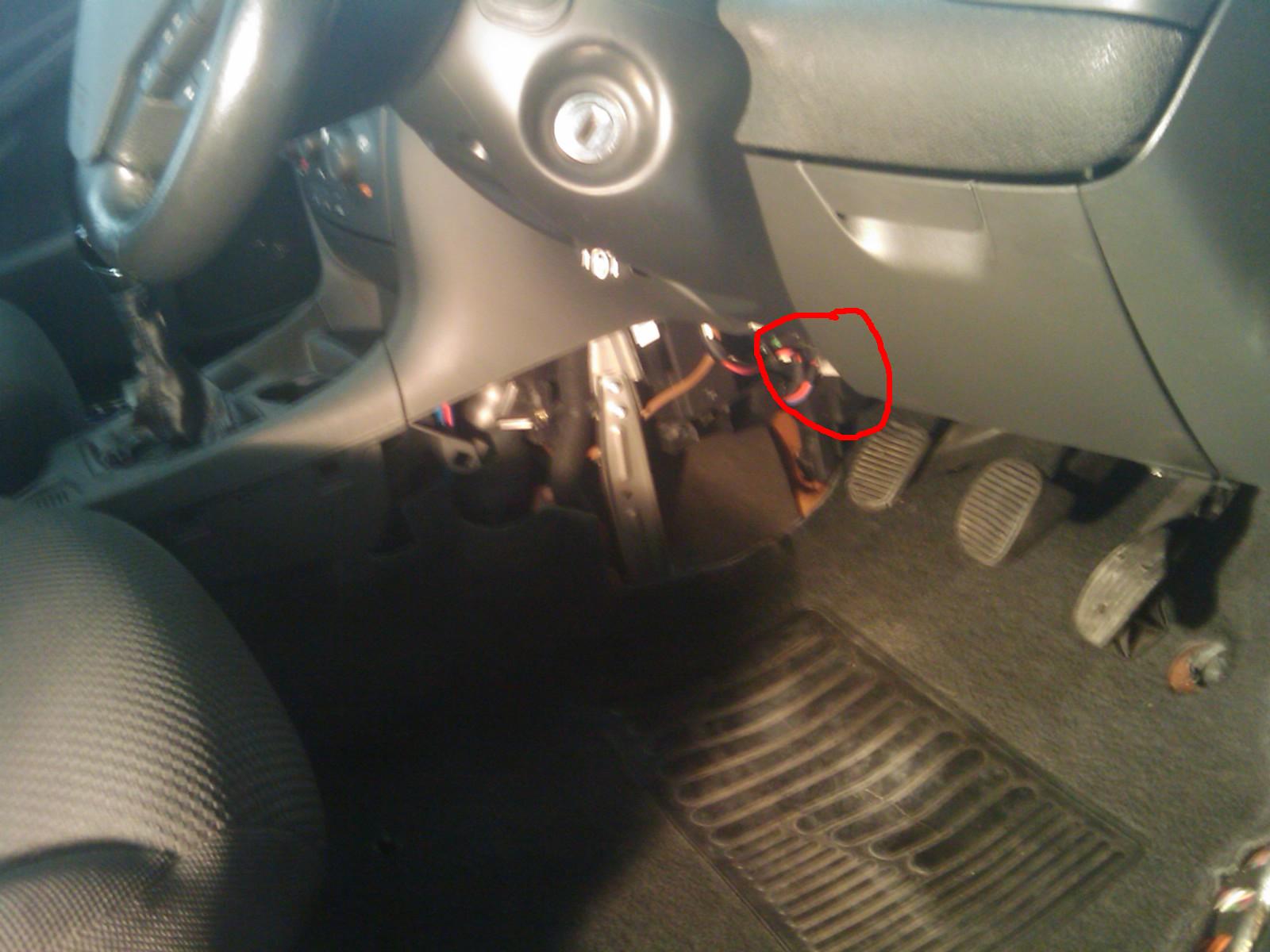

this, but on the DRIVERS SIDE!

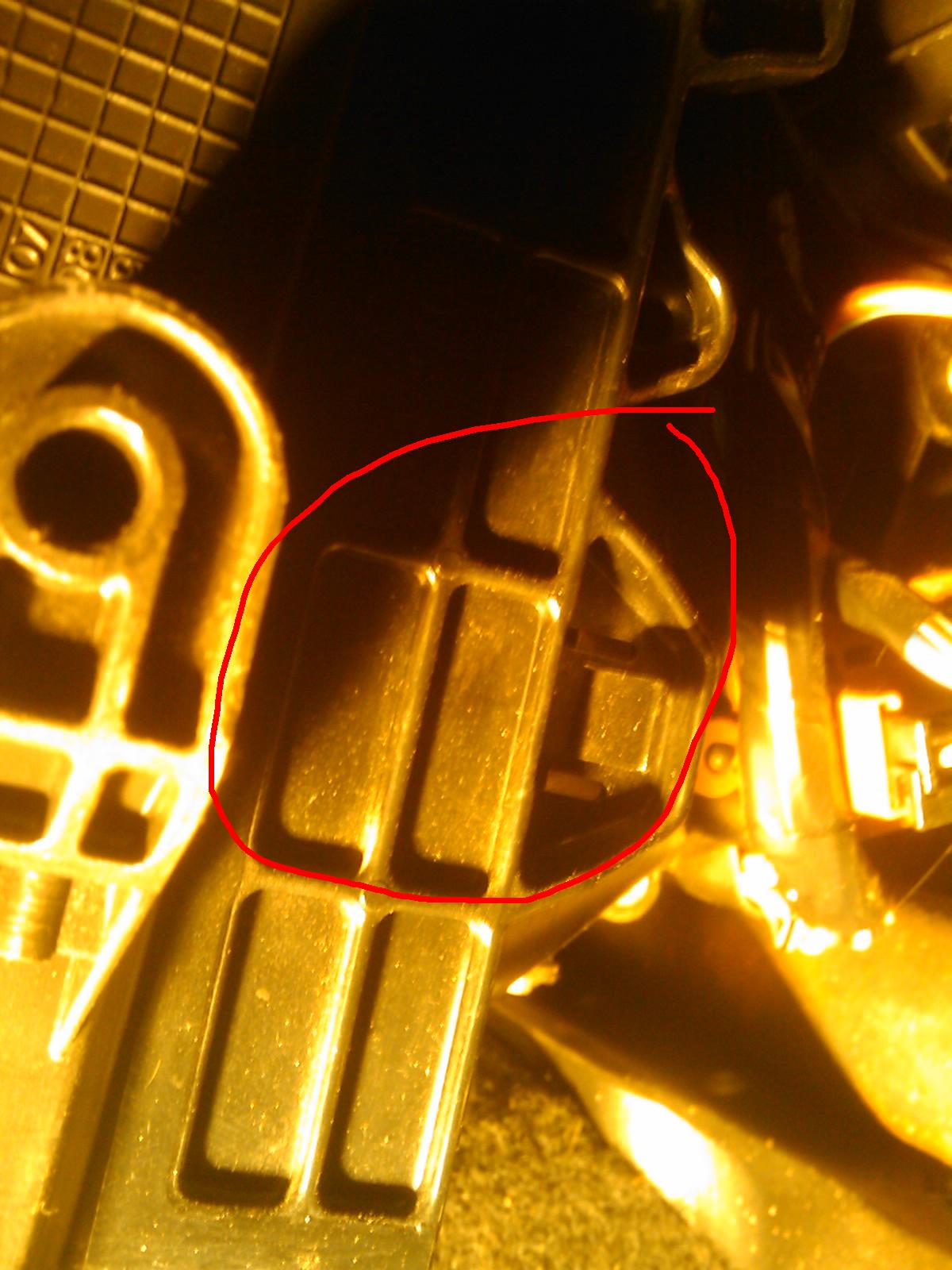

after you take the panel off, look right at the back and there should be a plastic flap/lid with a screw in the middle. its right by the steering column. its not that obvious so look hard. you'll need to be upside down for this

i've written DRIVERS SIDE in capitals 3 times now. also where else will you find your steering column!? :rolleyes:

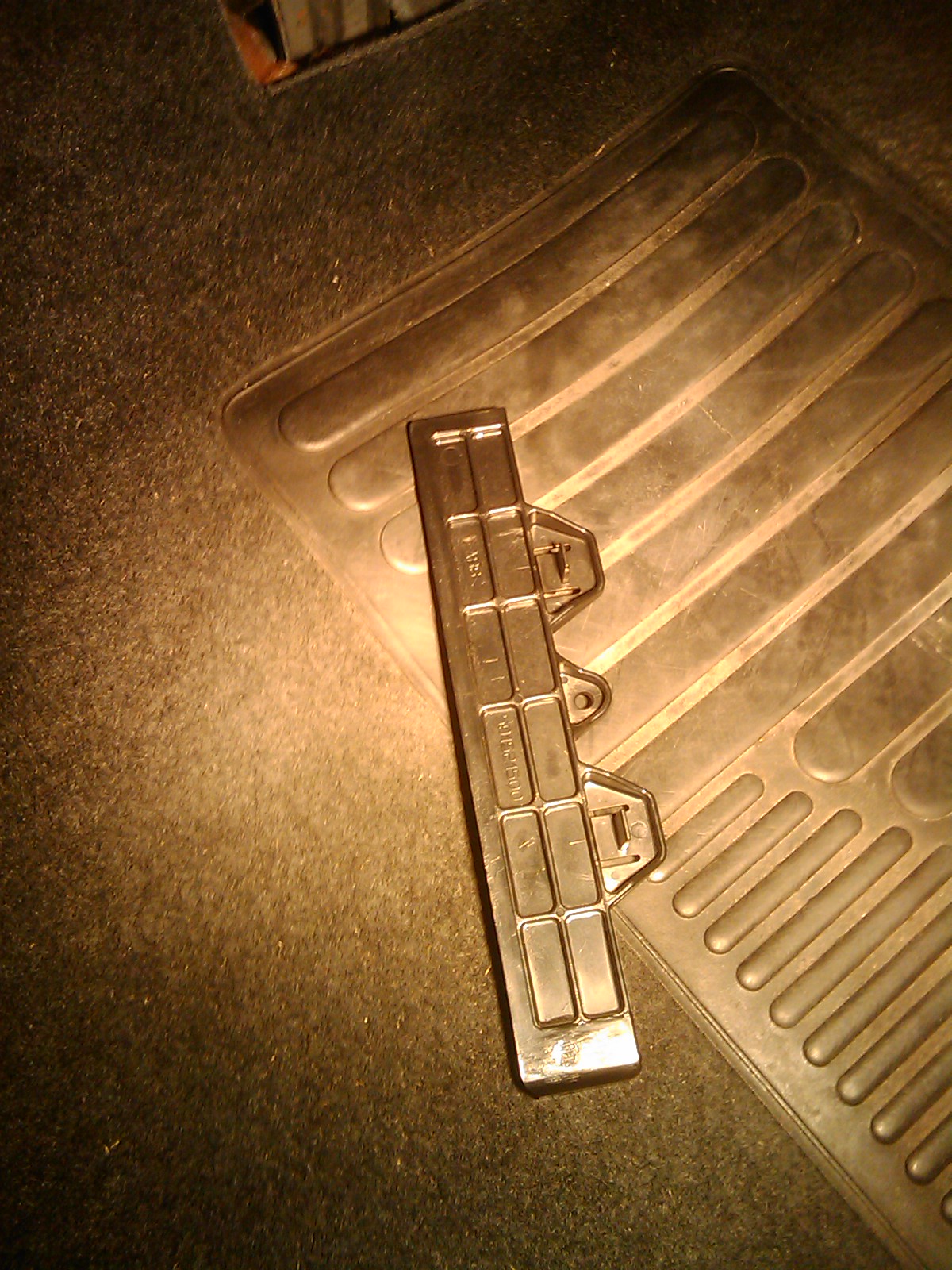

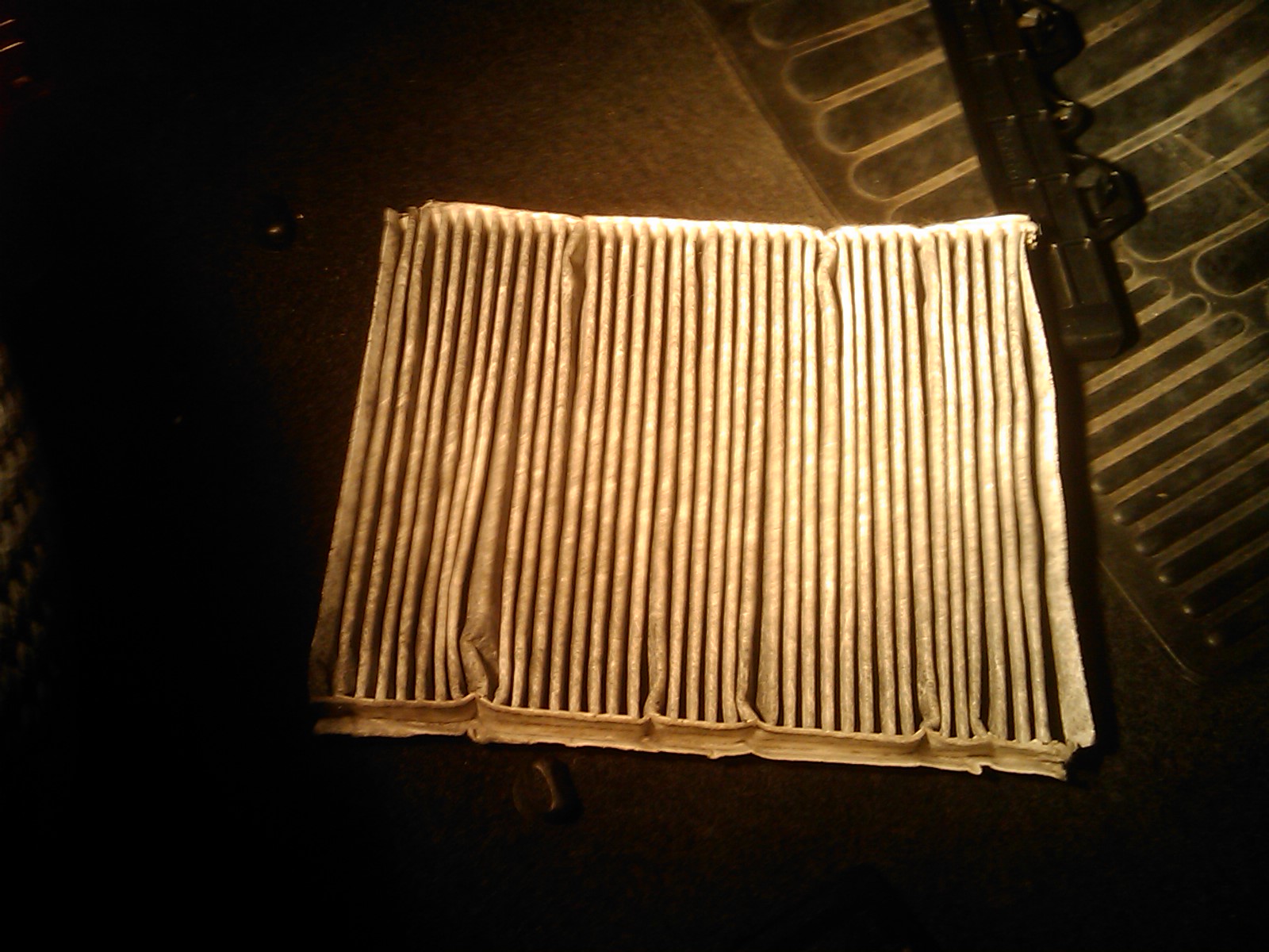

:slayer::slayer:eek:k i found the thing, in the ends uswell. cheers for all your help.
just wondering on how long the thing is as i pulled it out and it was quite small. and it has made abit of a difference but id there any other way to make the heaters work better.
