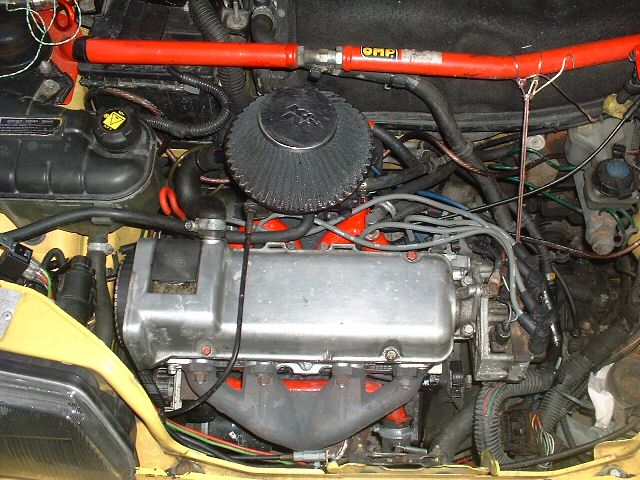

Top view of the engine, nicely painted inlet manifold, head, block and waterpipe
Yes, i need a new air filter

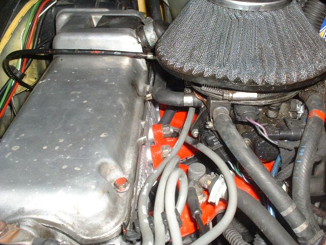

Plenty of exhaust sealant goo on the spacer join

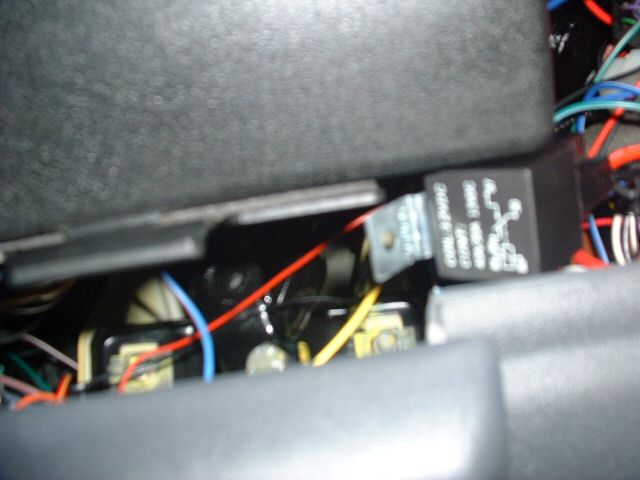

blurry picture, but another relay inside - switched by the igntion. means i now have a radio that goes with ignition, same deal with the cig sockets

mate youre a genius! :slayer: what does the powerfeed thing for the stereo do? any different to standard?
Craig
Just means the wiring is less resisitve, and as its driven off a relay, the battery connection is direct to the battery and therefor a cleaner source - which can only be a good thing (y)
Looking good mark, love the painted inlet manifold, never thought of that one before!
ta people (y)

Inlet manifold i thought looked pretty snazzy too, not seen one painted like that before - this was it before it was fitted:
