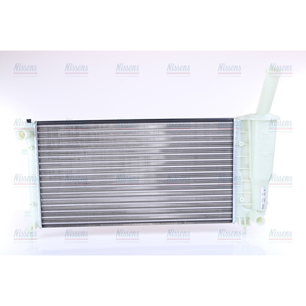

Running anywhere near the MIN mark is very dangerous. It’s well bellow the heater matrix hoses. The circulation is altered and airlocks are possible. Cars with the expansion tank on the side of the radiator

A pin hole in the steel radiator side plates are in my experience very common. More so than the pipe across the front. They leak quite quickly to this level then much slower
There is a channel at front that fills up first. It rarely drips on to the floor until it gets worse

Does this Panda have the same type of expansion tank as 1.2 and 1.4 Grandepunto, later Stilo model, Bravo, Linea? If yes, then my idea might be worth trying if no leaks are found. Some people have had same issues and worries and after my response they found out that actually no coolant is lost after minimum level and it isn't really being lost at all, only excess goes somewhere. I've had it for years like this, zero issues.
No not on my RHD versions
Completely different
