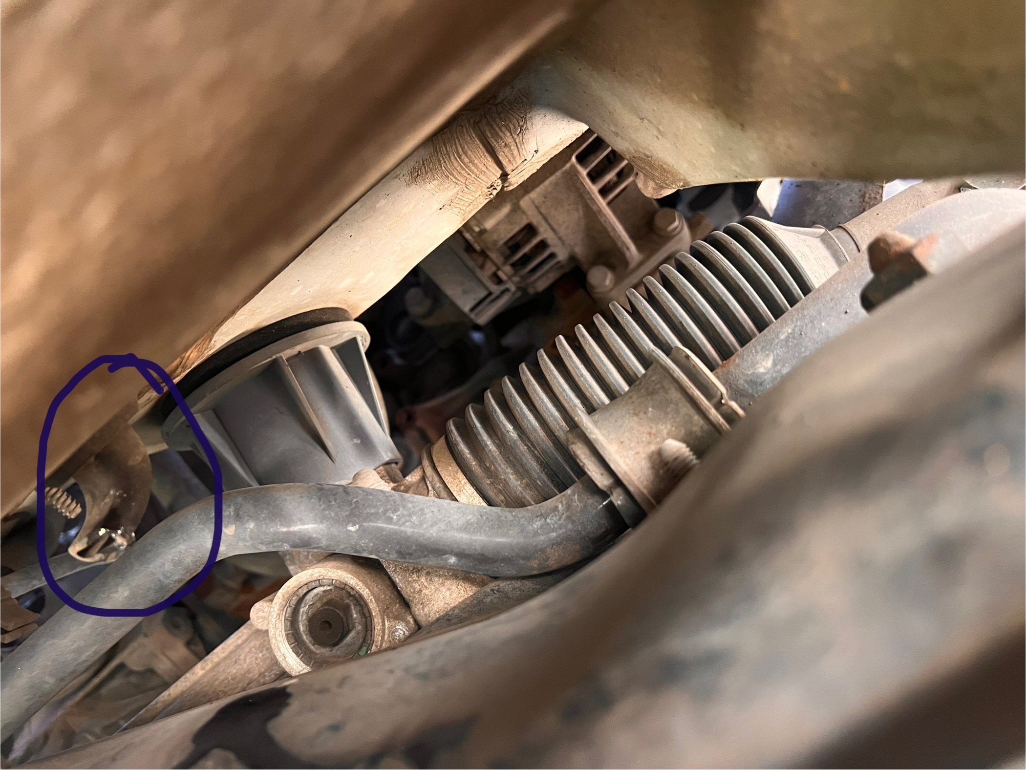

Hi all,
I have a coolant leak and the only place I can see anything leaking is from this black thing (see pic) under the car. Does anyone know what this is? TIA!

Hi, 🙂
That is propably the Aircon drain
Fluid will be clear ( it's water) 😊

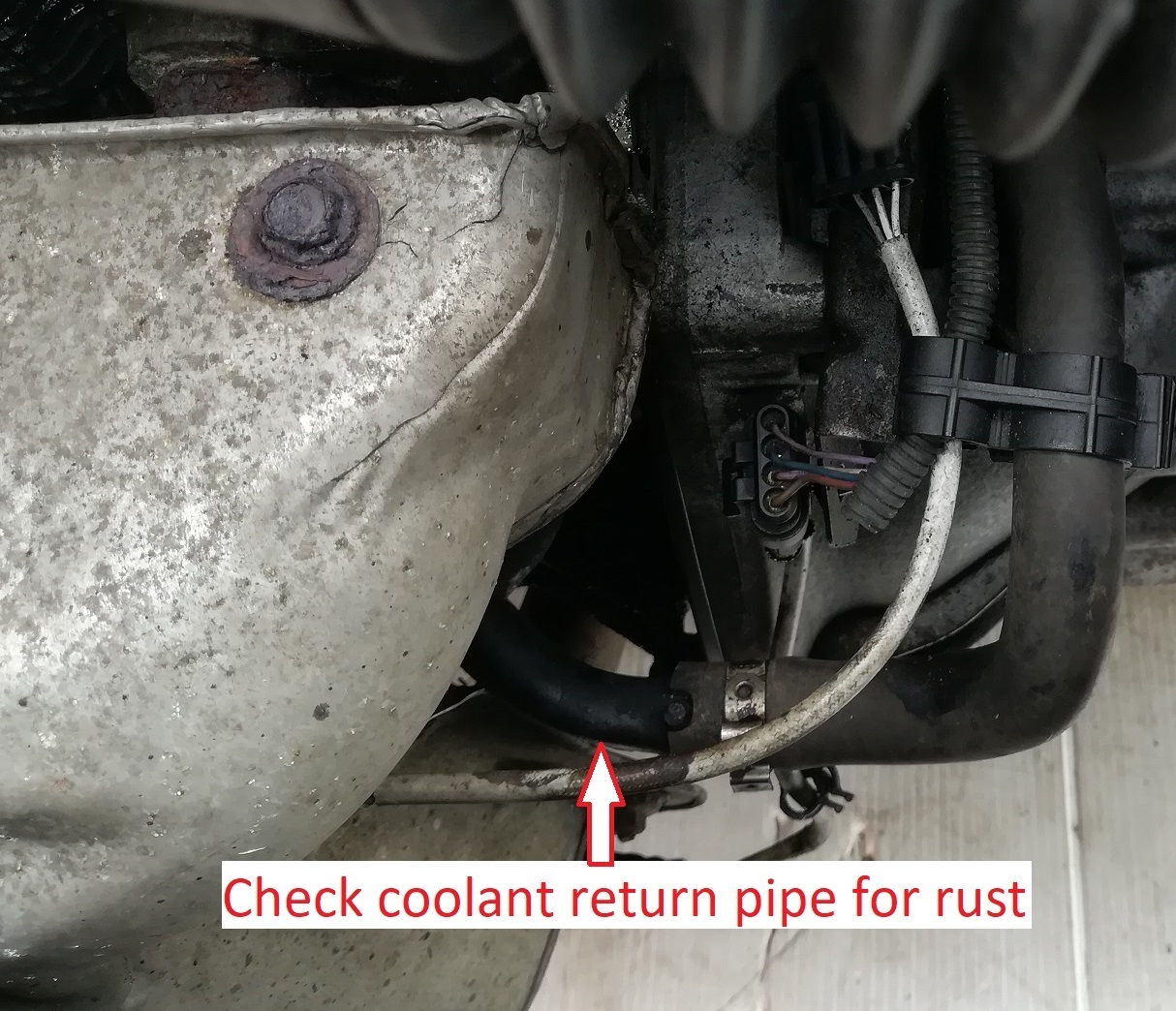

Have you checked this coolant return pipe?
Known to weep when they rust on the underside of the bend

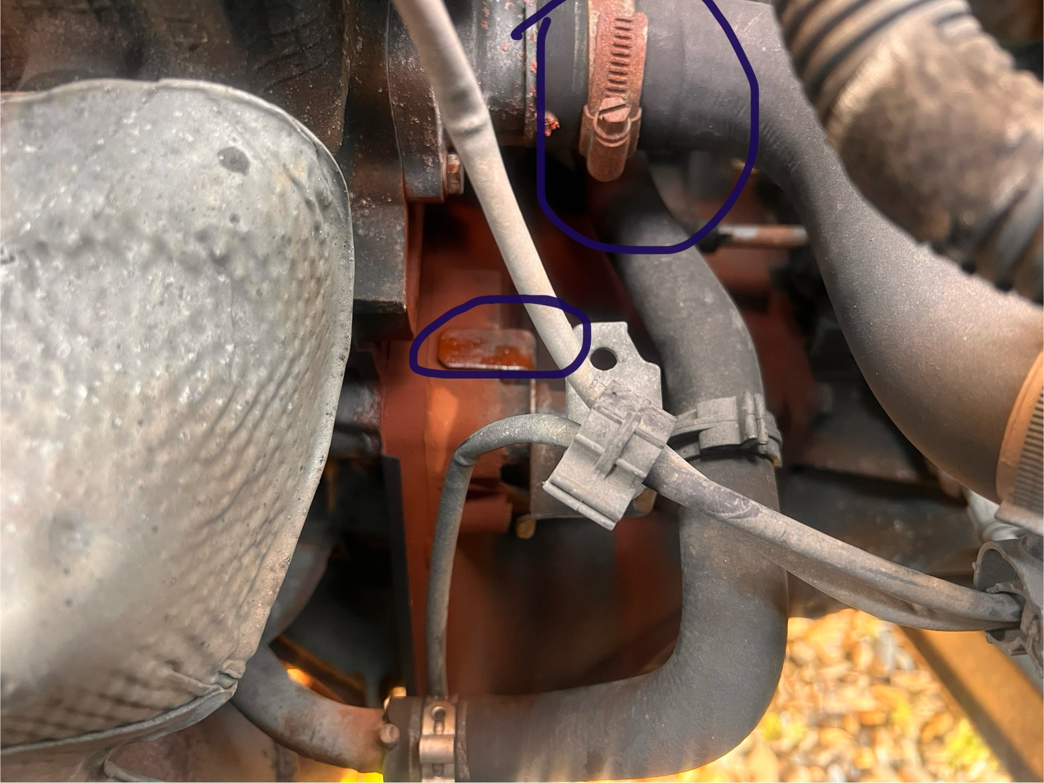

Hi… thank you sooo much for this!! I can’t see that it’s that pipe but I checked and found a little splash of coolant above it… and very rusty around that area could it be this pipe dripping down do you think?

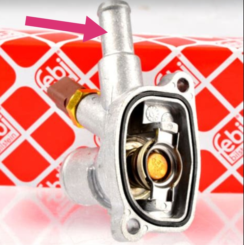

That's the thermostat.. Just above the stain
Common for that to fail on the 500
So much so that I carry a spare 🙃
