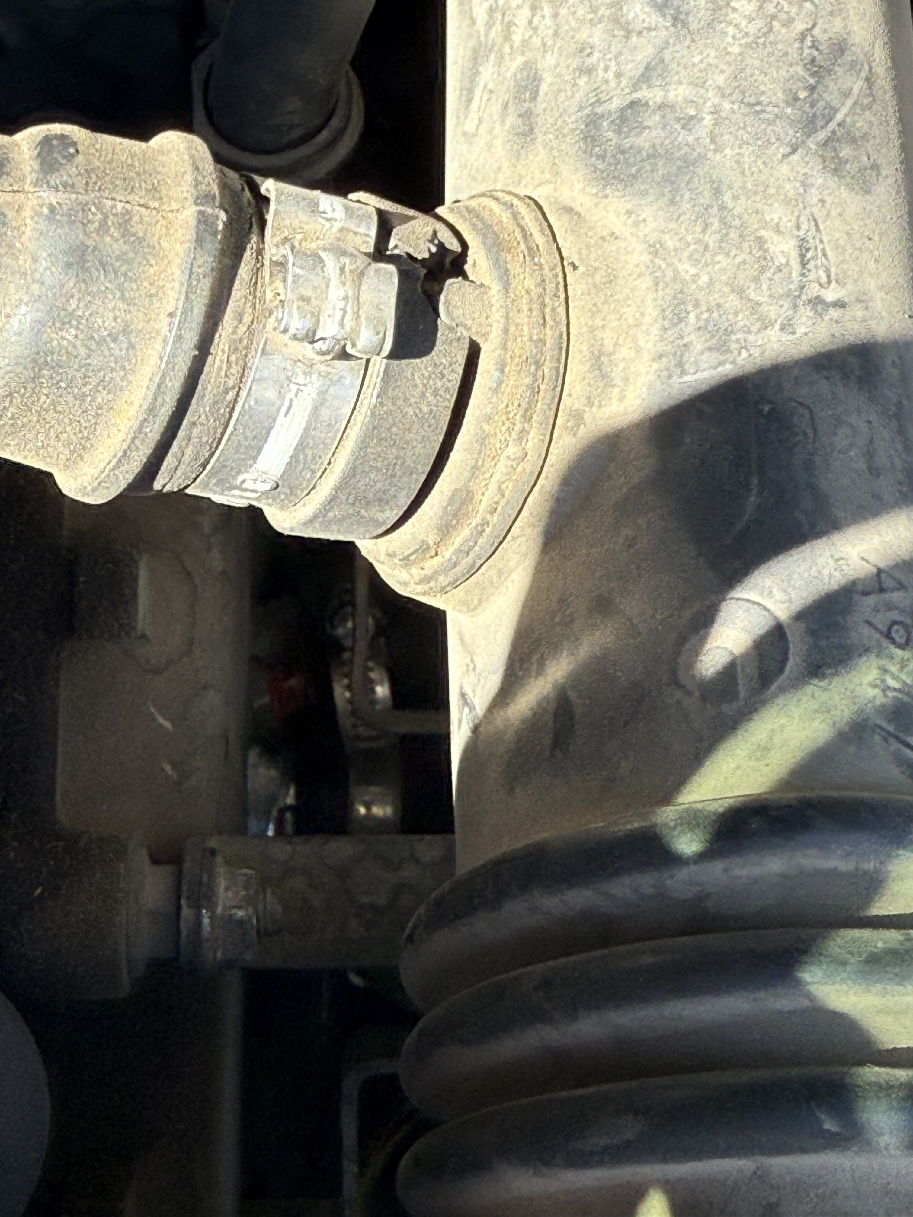

Ok there was a small leak at the connection here with the thermostat he tightened it. He said if coolant goes down again he will replace the hose connecting the reservoir tank and the thermostat
Also replaced the cap since he had a spare one on him!
I’ll check the level and add some later as he opened the cap when engine hot so some coolant overfilled and came out anyway and after that if it goes down below minimum I will get that hose replaced

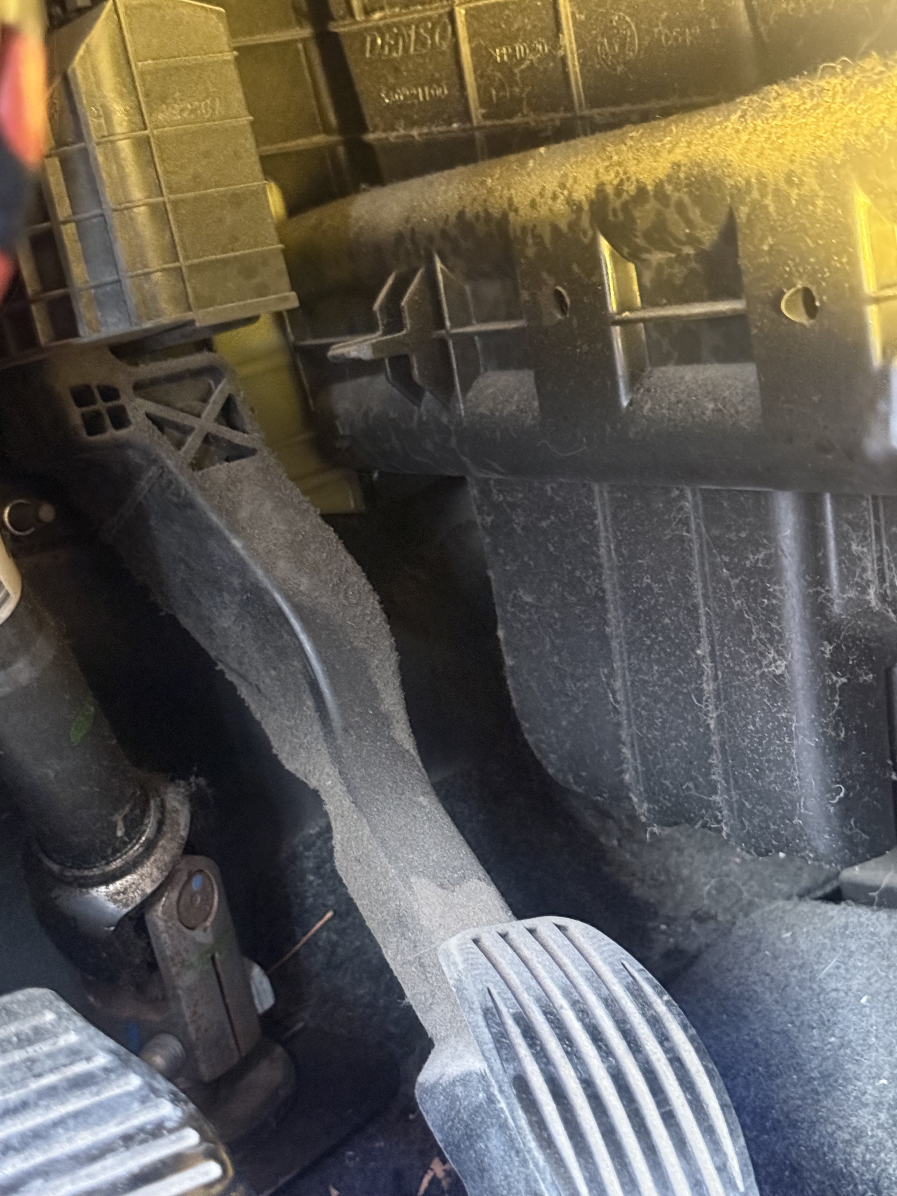

Actually it is still leaking a bit around 100 ml every 2-3 hours of driving. So got it checked again and there was another leak from the cabin by the heater matrix ? The thing behind the accelerator pedal as attached. So will get that replaced next week at 130 euros. Will still drive normally until then just will keep an eye on coolant levels and top up if necessary
