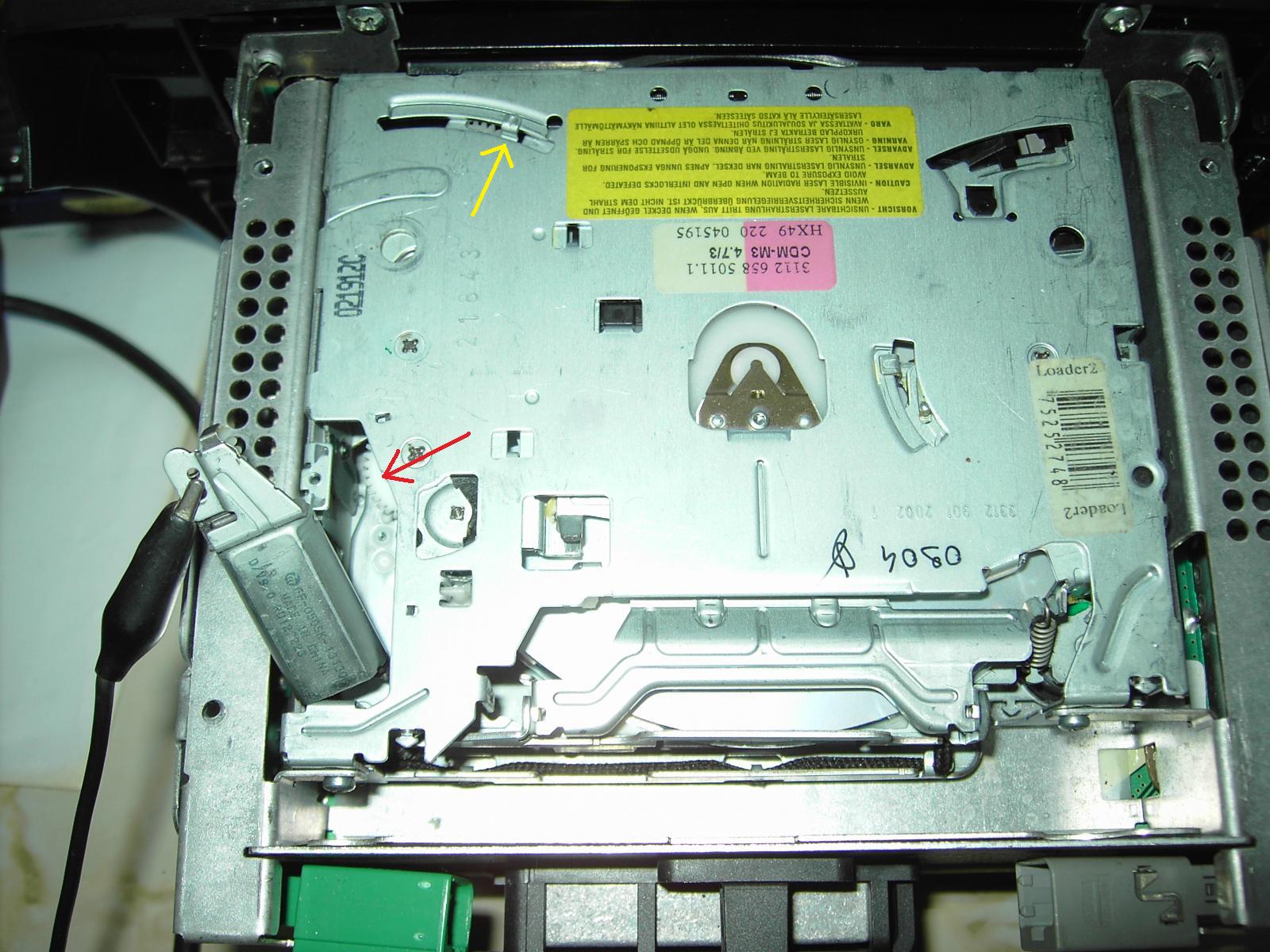

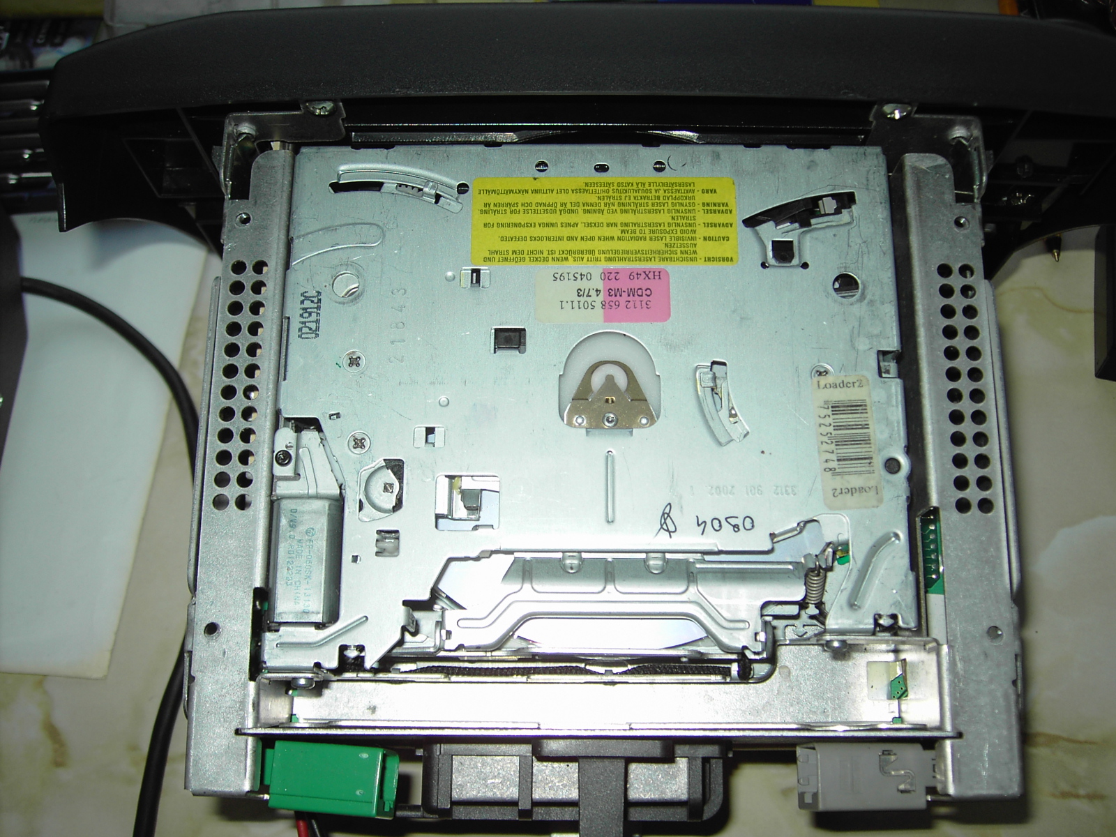

To remove a stuck CD, you need to remove the top cover then remove the screw holding the eject motor. You'll need a T6 screwdriver for the screw.
Lift the motor up just enough so you can get a finger on the edge of the white plastic gear wheel (arrowed red) then turn the gear wheel clockwise until the CD comes out. The black clip in my picture below is just to hold the motor out of the way while turning the gear wheel. Be careful lifting the motor, the wires to it are very thin and easy to break.
As you turn the gear wheel, the metal tab (arrowed yellow) should move to the left and the CD should start to come out. You can only turn the gear wheel a small amount at a time, so each time you need to release it, hold the tab so it doesn't spring back then turn the gear wheel a bit more until the CD is out.

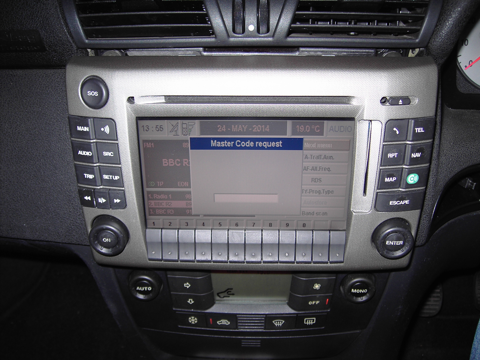

Is there a trick to actually putting the code in? And is the master code the radio code? I noticed if I just turn the stereo on it doesn't ask for a code until I turn the key. When I do, it asks for a master code which I input using the keys along the bottom (the screen has 1 to 9 (I think) above each button) and then hit enter. The screen then says 'wrong pin, try turning the unit on/off' or something to that effect. :bang: Not sure if it's the way I'm typing the code in or whether the seller has written it down wrong etc.
The Master Code is stored in the Connect Nav and the Body Computer. The BC is only active when the ignition is switched on, so the CN will work without a code until then.
Yes... the 4 digit code is the Master Code. When the Master Code request box is showing, the buttons will be labelled 1 to 9 plus 0. Press the relevant buttons according to the code, then press "ENTER". If the code is rejected, it's likely you have the wrong code.
