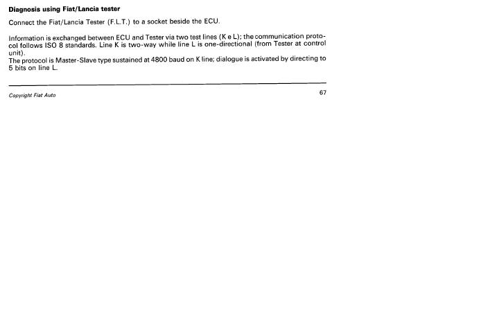

In addition i have found the following interface description in the original Fiat Workshop Manual, it doesn't seem to fit any of the descriptions in here.
Now i'm even more confused...:confused:
Help!!!
Cheers Michael
