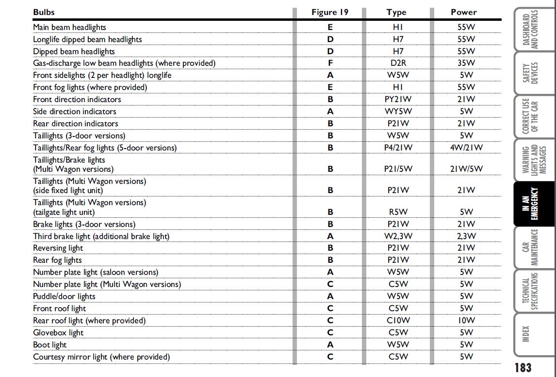

On the 5 door 02 1.6 may dam hear side bulb has blown :cry:
Its the main driving beam(only side light working)
Im confused as to weather its a H1 or H7
I really dont want to be trying the wrong bulb,Last time this happen I was on the verge of hanging myself
Thanks
From the Stilo handbook:
I guess in terms of wording the stores are correct,main beam is what I would call high beam
H7 dipped which is what you drive at night with.
