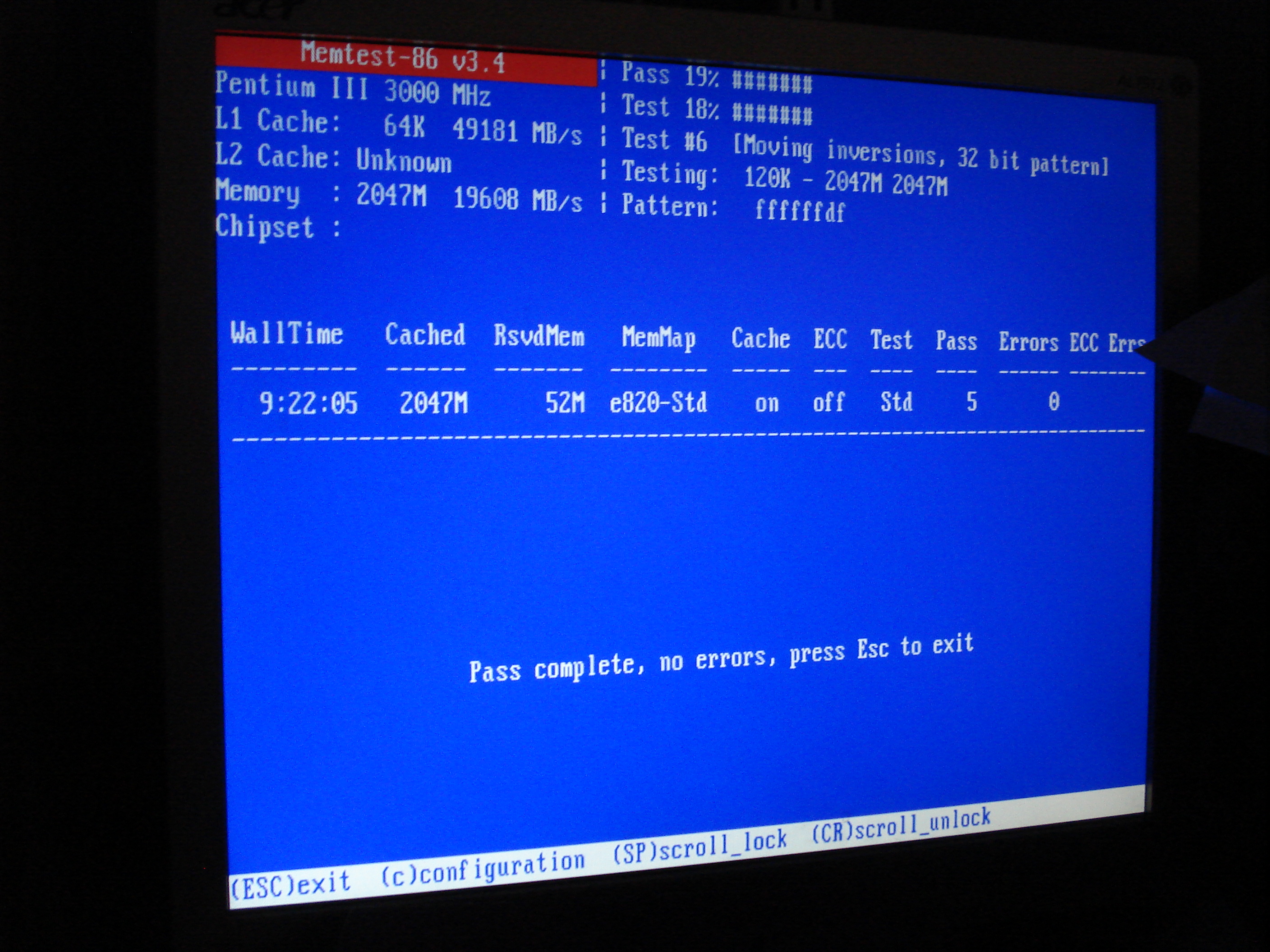

the results from the ram test was clear

When you say "turns off" does it turn off and stay off, or is it a reset that it does?
I was thinking along the lines of Sampler from that other forum. If you have the BSOD dump screen to auto reboot, it wont help you in finding and troubleshooting the problem.
Memtest86+ is easy to use, though you really want to leave it to do at least 3 passes. Set it going before you goto bed, then check the results in the morning.
Let us know how you get on :)
Did you try what was suggest and turning teh auto reboot option off?

Regarding memtest86+, please remember to leave it on overnight. IMO, 1 pass is not enough. 3 should be ok though.
Turning off auto restart means exactly that. So you computer will not automatically restart meaning that you can write down the error message that is shown (and subsequently vanished when your box turns off). It is that error message that will let you track down what it is exactly that is causing your PC to flip out.
Also, you wont be able to use any Windows based temperature logging software when running memtest86+ as it (MemTest) is essentially its' own operating system and when you boot from the MemTest86+ disc, it will not load windows. You will have to turn your machine off before you can get into Windows again.
I did not get a wink of sleep last night.
I kept tossing and turning and muttering something about RAM parity checks.
All i could think of was your PC running MemTest86+ overnight, and the thought of any errors meant my mind would not rest.
Can you help me sleep easy tonight and confirm that there were no errors please?
