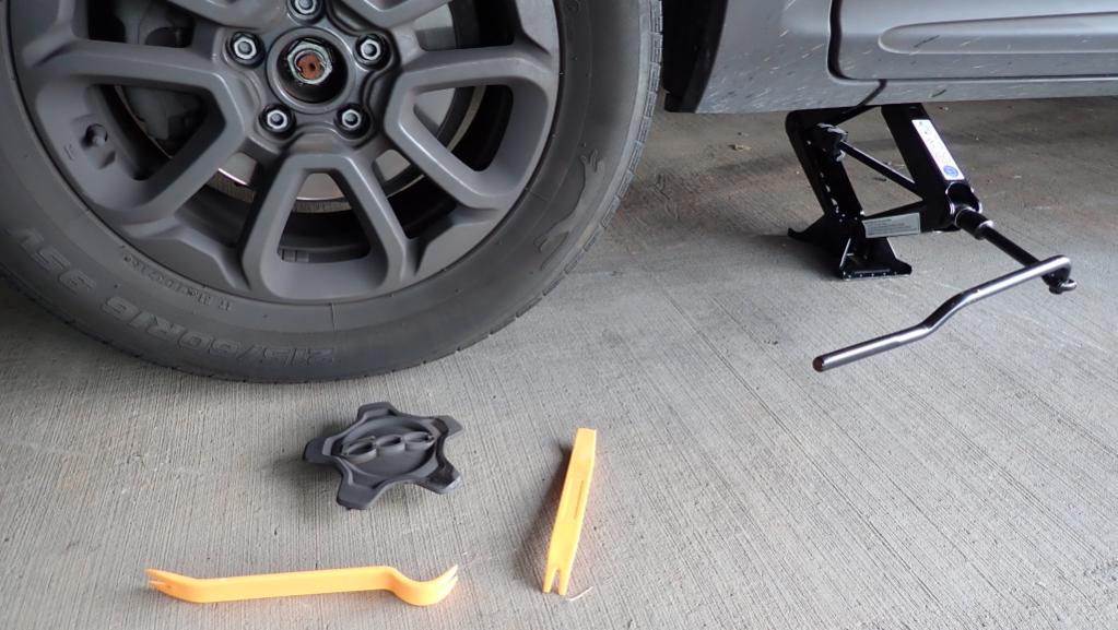

Raise car, wheel off & place under car, personal safety

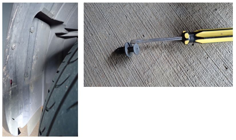

Remove the two plastic anchors by pulling out central stem and the flap comes off
IF YOU ARE ONLY CHANGING THE BULBS, no need to remove wheel. Just turn the wheels towards you and this should open up enough space to remove the flap and then unclick and pull out the bulbs and bulb holders.

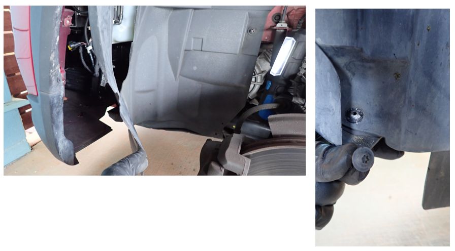

Loosen plastic molding by undoing 6 screws

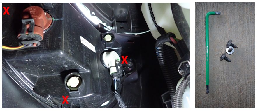

Undo the 3 TORX 25 screws, approximate locations marked X

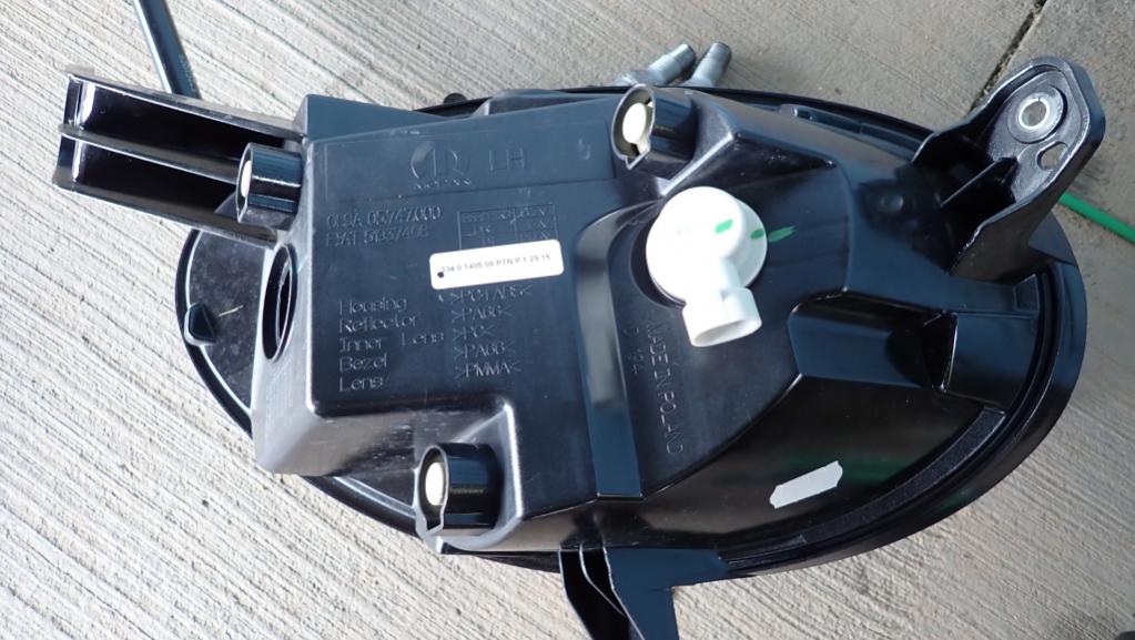

Disconnect bulb holders and there you go
In my case, the bulb holder felt sticky and positive terminal bit worn; loosened it up , replaced the bulband all seems well. Installation is the reverse!
