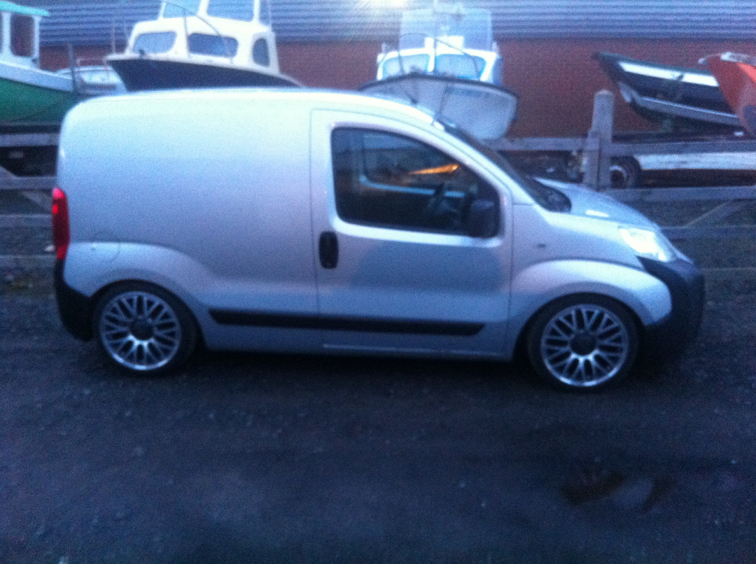

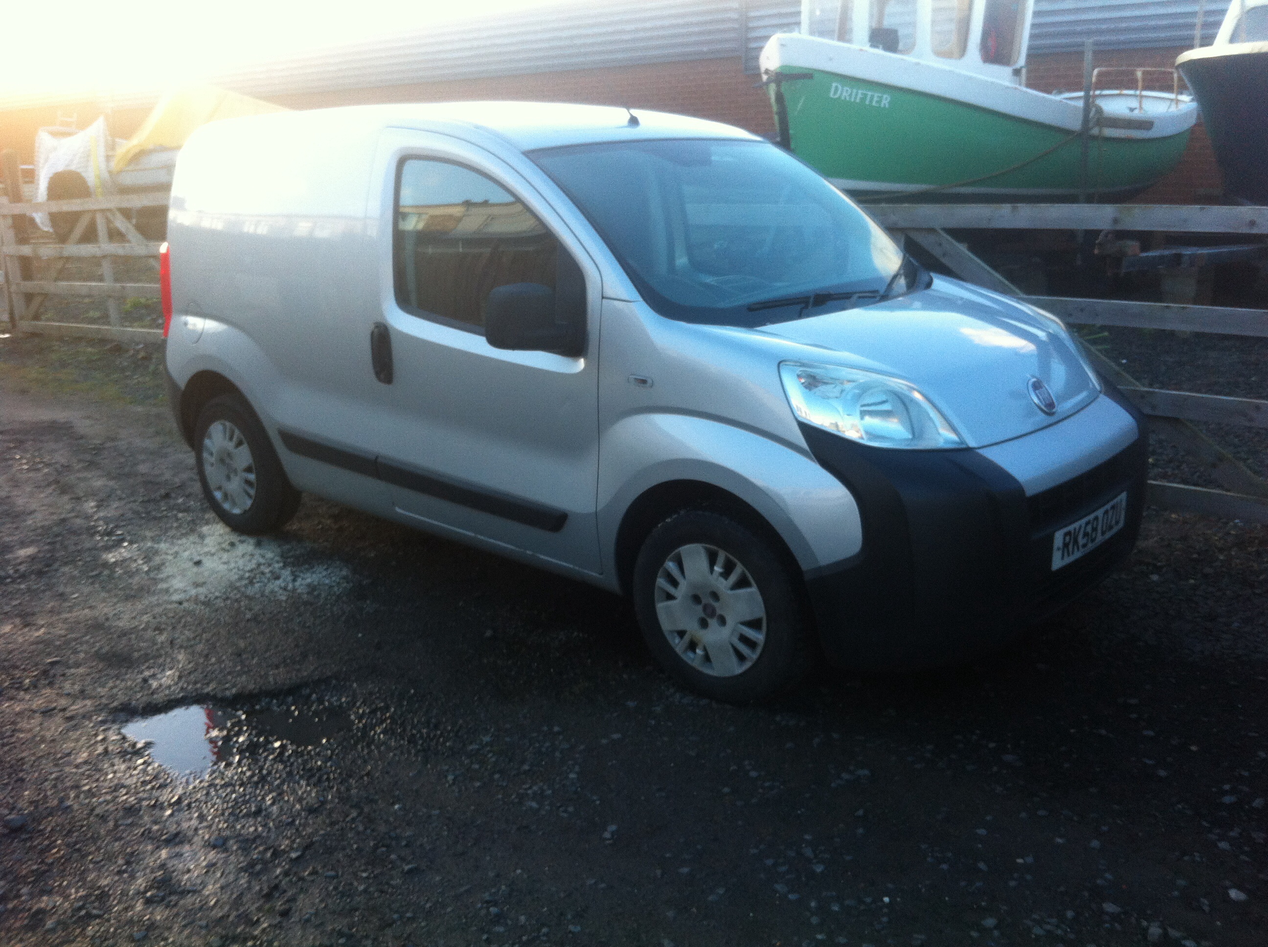

If I can up load pictures here some before and after, coilovers fitted
Wrong way round but you get the gist
