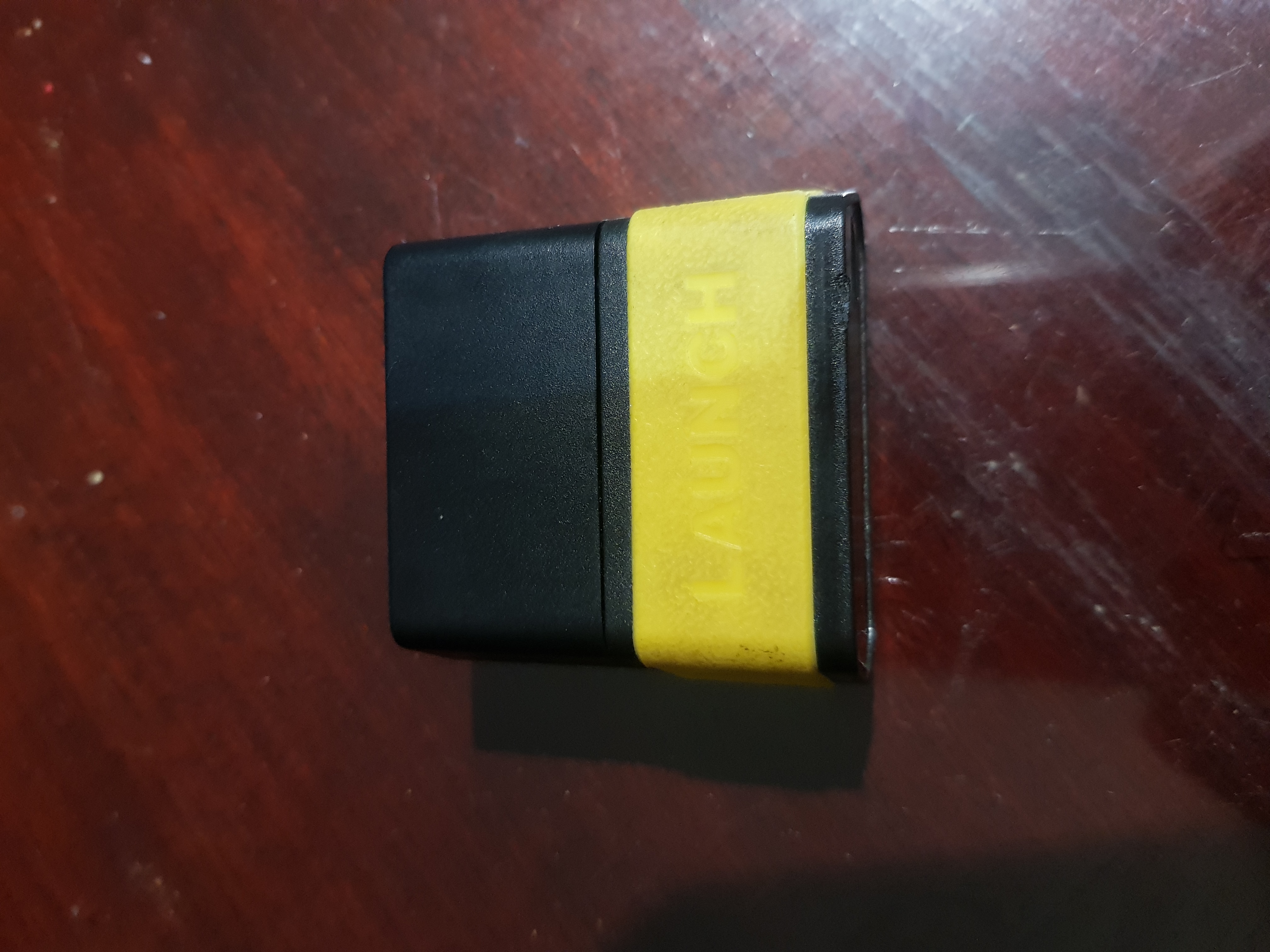

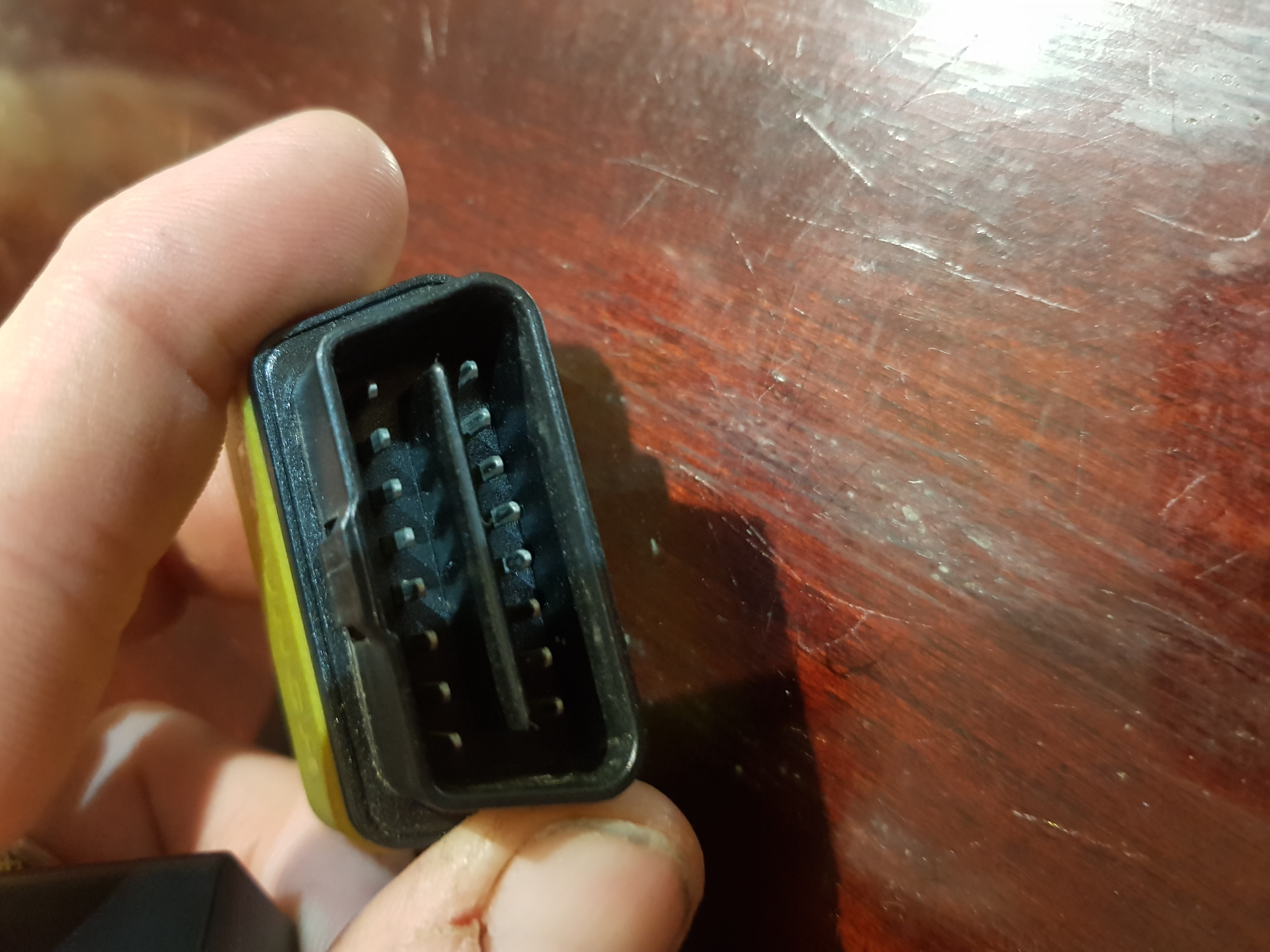

I think Launch might be the way to go
I have used this bluetooth scanner on various cars to read and clear codes
As well as other functions
Can get some screen shots shortly to show the interface on my phone
