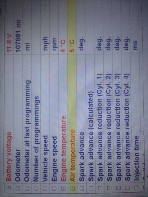

Connected to mine 05 work also on girlfriends 06
No happy. Cold outside. Restored windows recently so had to reinstall Multiecusan but no bid deal
Yes the battery is bad its been like that for 18 months or more. Car not been switched on for 10 days or so.
All I have it the blue switched cable which was around £12 at the time.

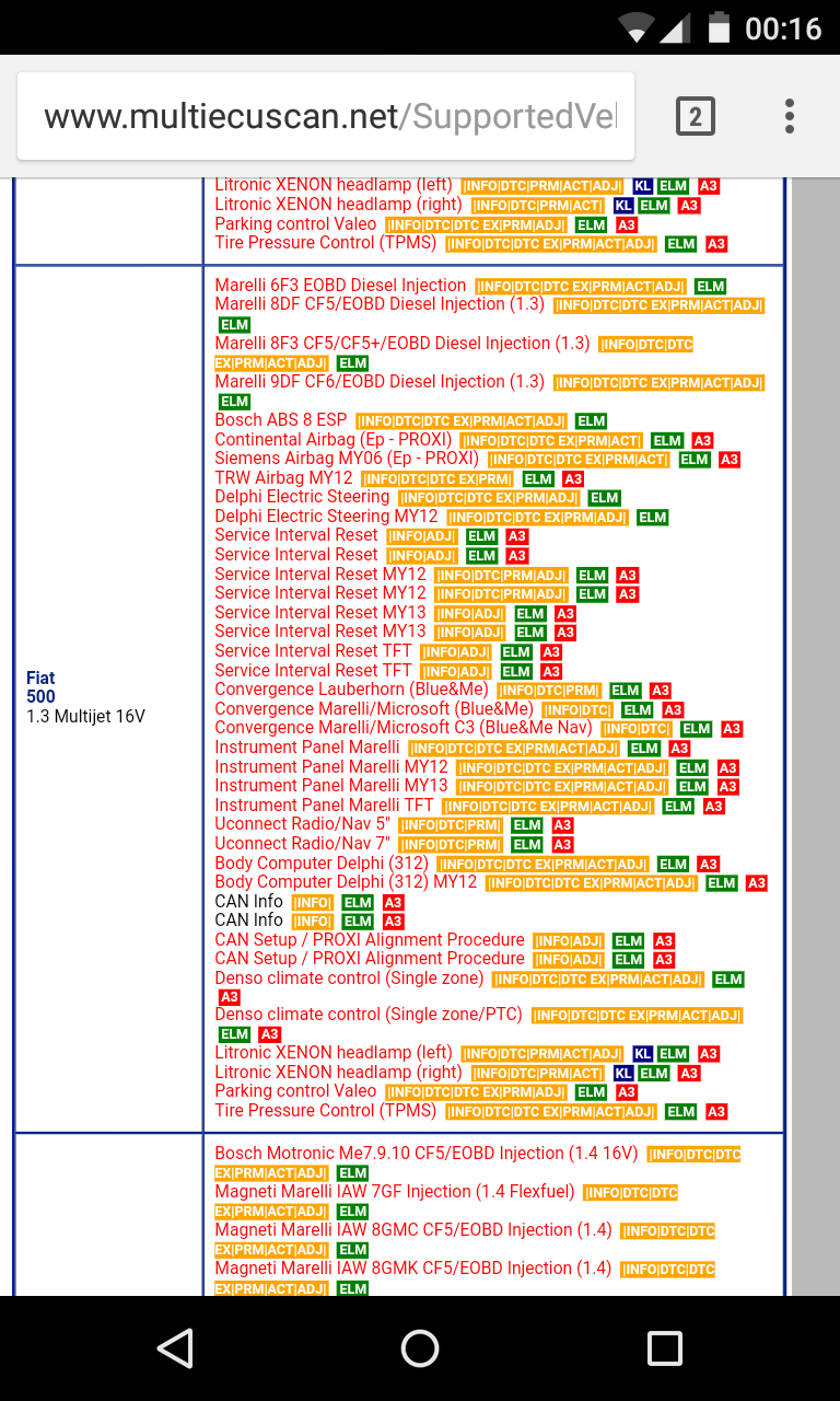

Not according to this unless I'm reading wrong
E
TRW Airbag MY99 |INFO|DTC|PRM|ACT| KL A2
Doesn't connect to the airbag whereas the KL does
Guess it depends on your car
Does connect to the dash. But the KL will not.
For every module you would need both. However in the last few years nobody has need to connect to the dash except if they were upgrading it.
I have used the cable to fix an airbag tho/QUOTE]
E

I don't know what more I can say. I have reinstalled multiecuscan then gone to my car with the same cable as I linked to earlier and connected to the engine module then moved the switch and connected to the airbag module. Then taken some photos as you can see it close to freezing here today.
As I have a full version I could have connected to the steering module also but that's not relevant here.

Edited extract from MES compatability list http://www.multiecuscan.net/SupportedVehiclesList.aspx
You can connect to the following modules with the unregistered MES (15 minute limit) and the KL interface you purchased:
Marelli 6F3 EOBD Diesel Injection (1.3) |INFO|DTC|DTC EX|PRM|ACT|ADJ| KLELM
Marelli 6JF EOBD Diesel Injection (1.3) |INFO|DTC|DTC EX|PRM|ACT|ADJ| KLELM
Bosch ABS 8 |INFO|DTC|DTC EX|PRM|ACT|ADJ| KLELM A1
Bosch ABS 8 ASR |INFO|DTC|DTC EX|PRM|ACT|ADJ| KLELM A1
Bosch ABS 8 VDC |INFO|DTC|DTC EX|PRM|ACT|ADJ| KLELM A1
You need to register €50 fee to connect to
Marelli 8DF CF5/EOBD Diesel Injection (1.3) |INFO|DTC|DTC EX|PRM|ACT|ADJ| KLELM
Delphi Electric Steering |INFO|DTC|PRM|ADJ| KLELM A1
You cannot connect to
TRW Airbag 2 (Ep - PROXI) |INFO|DTC|DTC EX|PRM|ACT| ELM
Service Interval Reset (Base) |INFO|ADJ| ELM
Service Interval Reset (Comfort) |INFO|ADJ| ELM
Connect (NAV) Marelli |INFO|DTC|PRM|ACT|ADJ| ELM
Instrument Panel Marelli (Base) |INFO|DTC|PRM|ACT|ADJ| ELM
Instrument Panel Marelli (Comfort) |INFO|DTC|PRM|ACT|ADJ| ELM
Body Computer Siemens |INFO|DTC|PRM|ACT|ADJ| ELM
CAN Info |INFO| ELM
CAN Info |INFO| ELM
CAN Setup / PROXI Alignment Procedure |INFO|ADJ| ELM
Denso climate control (Single zone) |INFO|DTC|DTC EX|PRM|ACT|ADJ| ELM
(those in red need registration)
If you add a ELM 327 like http://www.ebay.co.uk/itm/271275445368 and register MES you can access everything without adaptor leads. The ELM 327 with leads one and two will also do everything but as you have the switched KL there is not much point in getting the leads, but you will have to switch interfaces for different modules.
