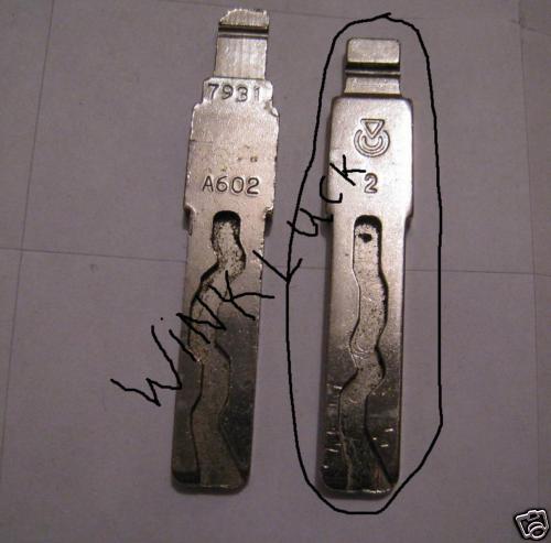

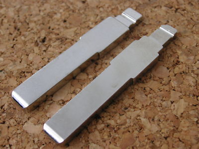

If it's just a new key you want cut, then you could buy a blank key blade, which most locksmiths could copy your old one to. You wouldn't need to recode or reprogram anything.
If buying a blank key blade, there are 2 different types, as in the pictures below. Also, most blank key blades sold on eBay are made of steel, which some locksmiths refuse to cut because it damages their cutter tool. You would need one made of brass.

You can use a second hand key off eBay for the electronics and immobiliser chip but they'll need programming to the car and a new blade fitting to match your current car.
If you buy a second hand key off eBay you can buy new key shells dirt cheap to give it a tidy up and make it feel like new.
Might be worth talking to a few key cutters round your way to see if they can provide a new blade or if they'll be happy to cut a steel one you source.
