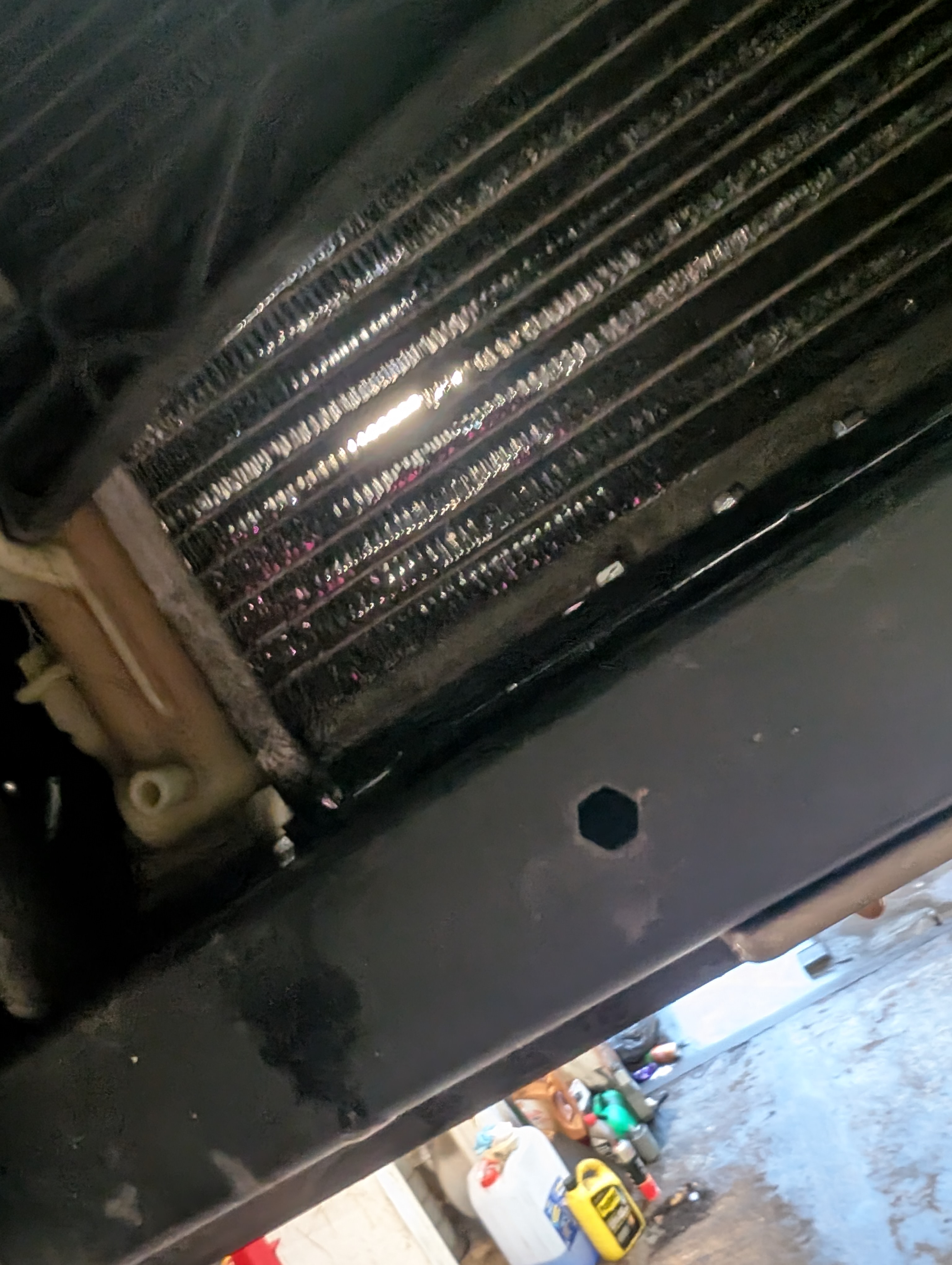

It's quite common for the metal inserts to pull out if the engine has overheated
Explanation from this guy
It has a coolant leak sometimes in its past
