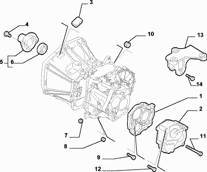

Not too familiar with the JTD 'box, but I believe the drain plug is No 8 and the fill plug No 7 in this diagram:
Remove the fill plug first, then the drain plug. Make sure the oil is warm before draining. Once drained, replace the drain plug and refill.
You will know when you've reached the limit when a little oil starts to spill over, out of the fill hole.

Both of the plugs are under the car and are part of the gearbox casing. The lubricant you need is shown here (manual gearbox fluid):
