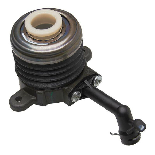

(2). Clutch Fluid Replacement:
While starting this job to do , I confused that from where to drain the fluid and remove the entrapped air if any?
Looking to the fluid pipe connection to the clutch, there is a Nipple with a hole but it seems non-openable (with a normal or ring spanner) unlike similar nipples at Brakes calliper devices at each wheel. So there is a no scope to bleed the clutch fluid by pressing and releasing clutch paddle and opening and closing the nipple as in the case of Brake fluid replacement as described in (1). There seems no Slave cylinder mounted on the gearbox body or bell but the only fluid pipe connection (with a plain nipple) entering in to the gearbox bell window. While pressing and depressing the clutch paddle, one can feel the fluid movement by touching the connected pipe.
So my QUESTION is:-
From where to bleed the Clutch-fluid and remove entrapped air-bubbles if any?
Very eagerly your positive response is awaited.

Main issue is that, in this case the nipple is not openable. It is fixed as an inbuilt part of the concentric clutch slave cylinder.
I am again attaching the pic.

It could not be the highest point in the circuit as it is on the Gearbox's bell-housing. This is one end of the Clutch Concentric Slave Cylinder (CCSC) of a VALEO brand. It has Part No.55237794 of FIAT LINEA T-Jet. 1.4 Petrol.
A similar type pic is adding here

done this recently ,its an open hole which is blanked off with the hose fully in ,you have to push in the metal clip to release hose from fitting slightly to allow fluild to run out of hole ...that's the only way I could do after replacing slave cylinder ,,,can be tight to remove flexi hose...
