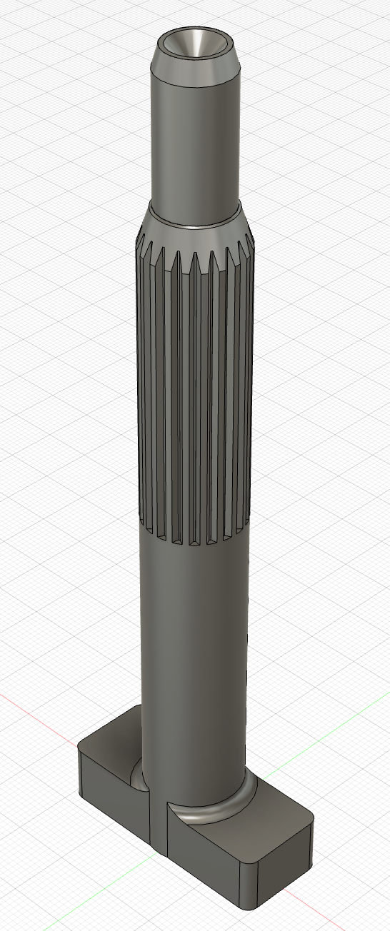

In fairness the one I have has two options to fit in the centre plate and it has fitted all the cars and light commercials I worked on and held them securely once centralised and tightened with the plastic nut.
If you know the diameter of that Punto centre plate, I measured this tools smaller option at 17mm.It's by Draper and although it looks pretty tatty it and my other tools earned me enough money to house and feed a family of seven for many years.:)
Hmmm now you mention it maybe I did have another adaptor for the centre with it which I have just lost at some point? I will have to have a look in my old tool box

I must admit that my 'eyeball alignment' technique is not the preferred option, I did turn up an alignment tool for my Land Rover clutch, a simple arrangement with the ID of the spigot and the minor diameter of the splines.
