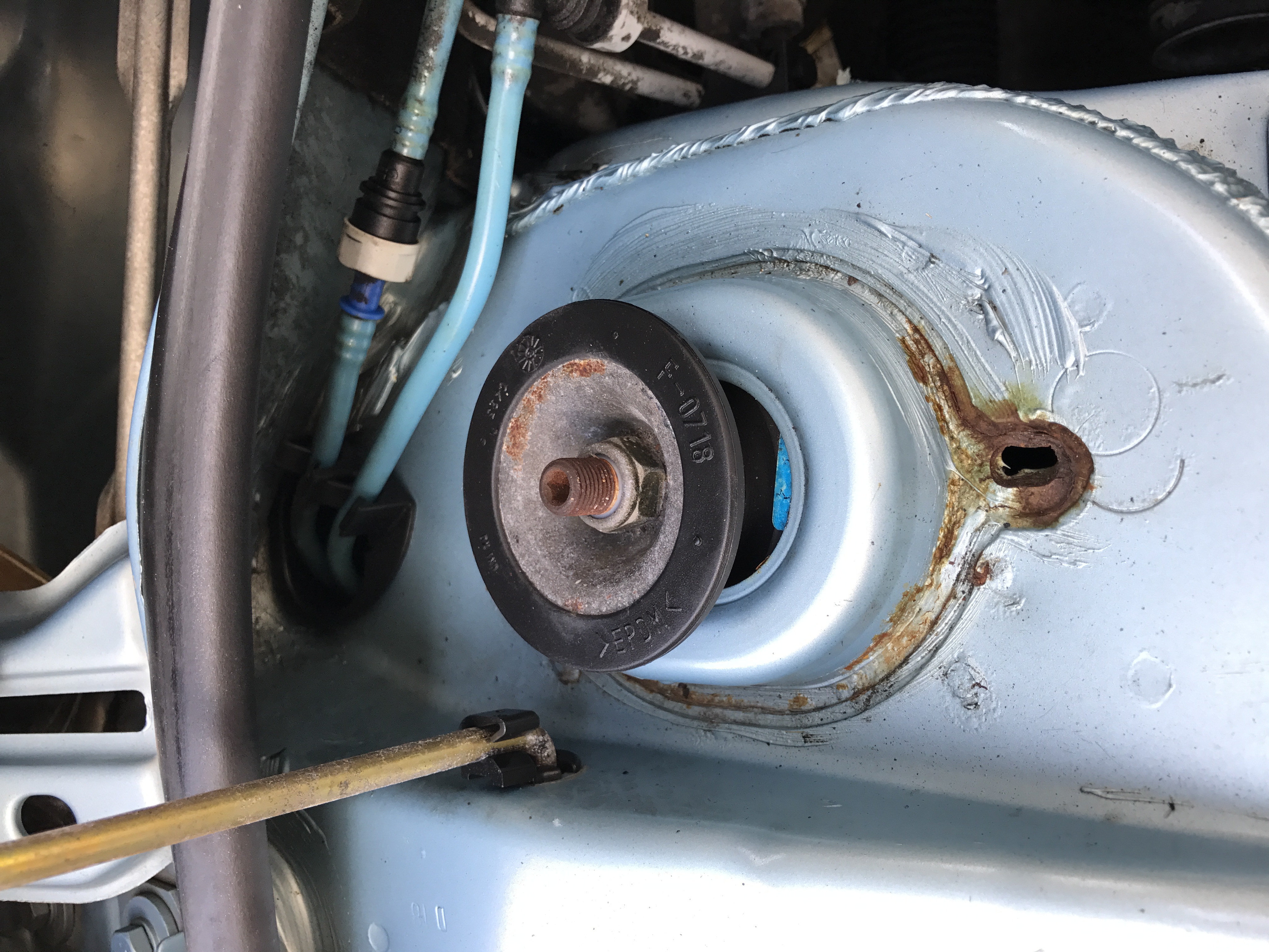

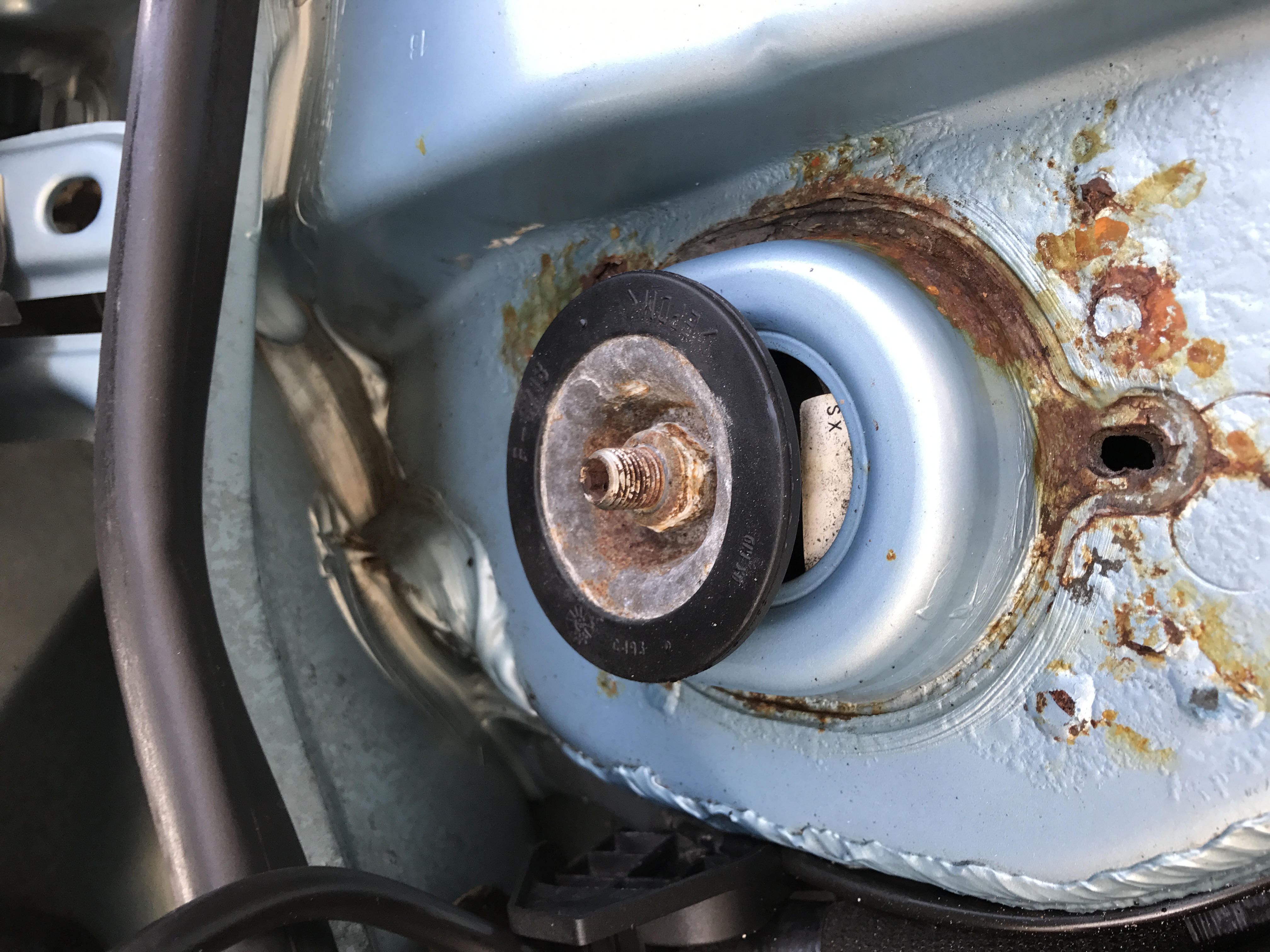

Cheers for that. Will give them a look.
Don't know if they look bad or not.

I had exactly the same problem. But it appeared after replacing the shock absorber, spring, upper end bearing and upper end rubber. The spring was broken, the shock absorber was broken, the bearing and other parts were rotten. The car rose 10cm, which tore the old inner suspension arm bushing apart. The problem could not be seen without removing the suspension arm. And that was the cause of the rattling. The sound was on the potholes in the road as if a hammer had hit an anvil. The impact was felt throughout the body.
