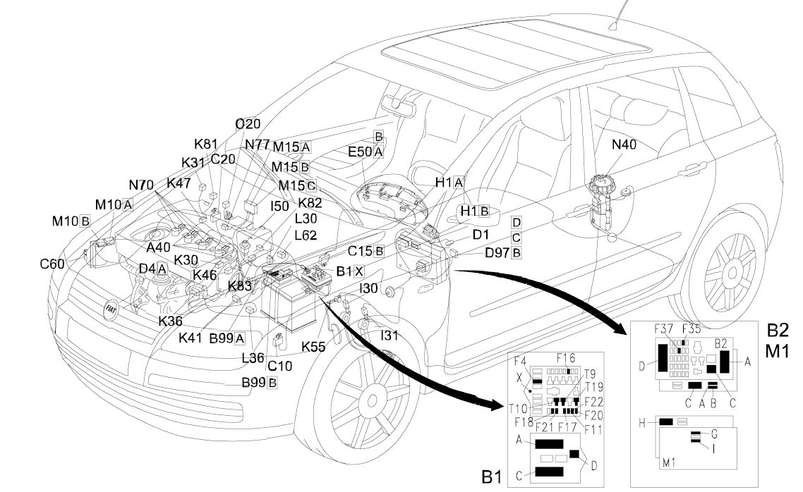

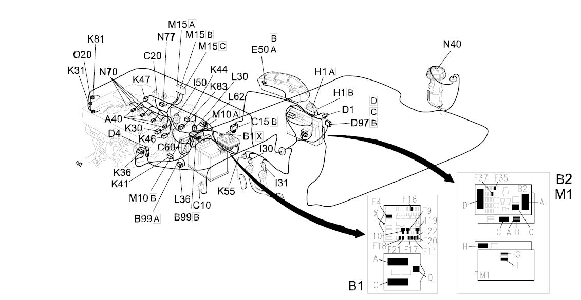

OK, so I'm putting new earths in it, but I can"t seem to find my ECU. It isn't on the same place as on that picture.
I'm driving a 1.9JTD.
If anyone knows where it is located, please let me know!
These are diagrams of the engine ECU location for the 8 valve and 16 valve JTDs. The 2 on the left are for the 8 valve.
M10 is the ECU on the top 2 diagrams.

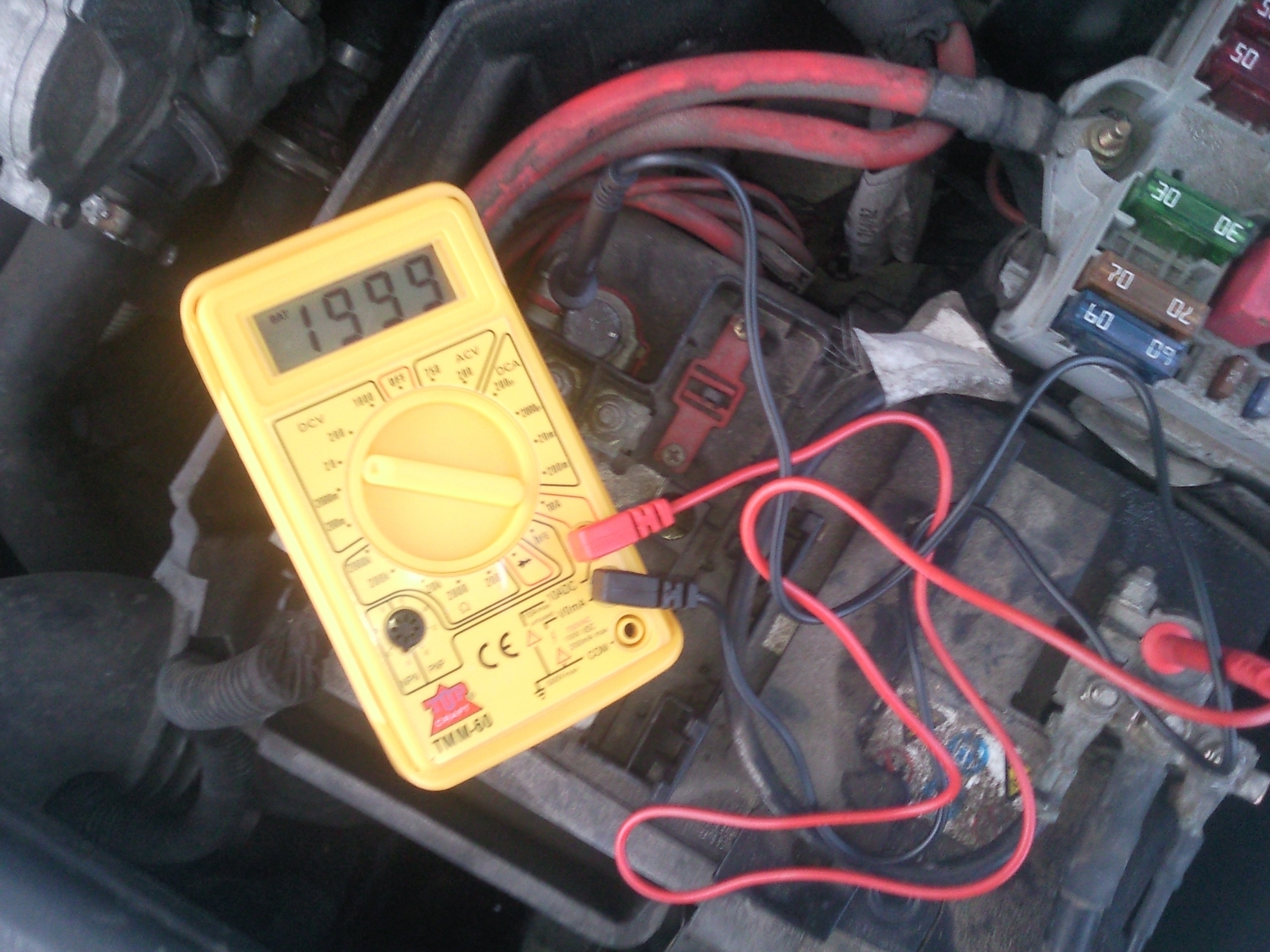

I then borrowed a voltmeter from my neighbor, to check everything;
and
my battery voltage was increasing? (when contact is of).
I measured 19.8-20V, then it stopped increasing.

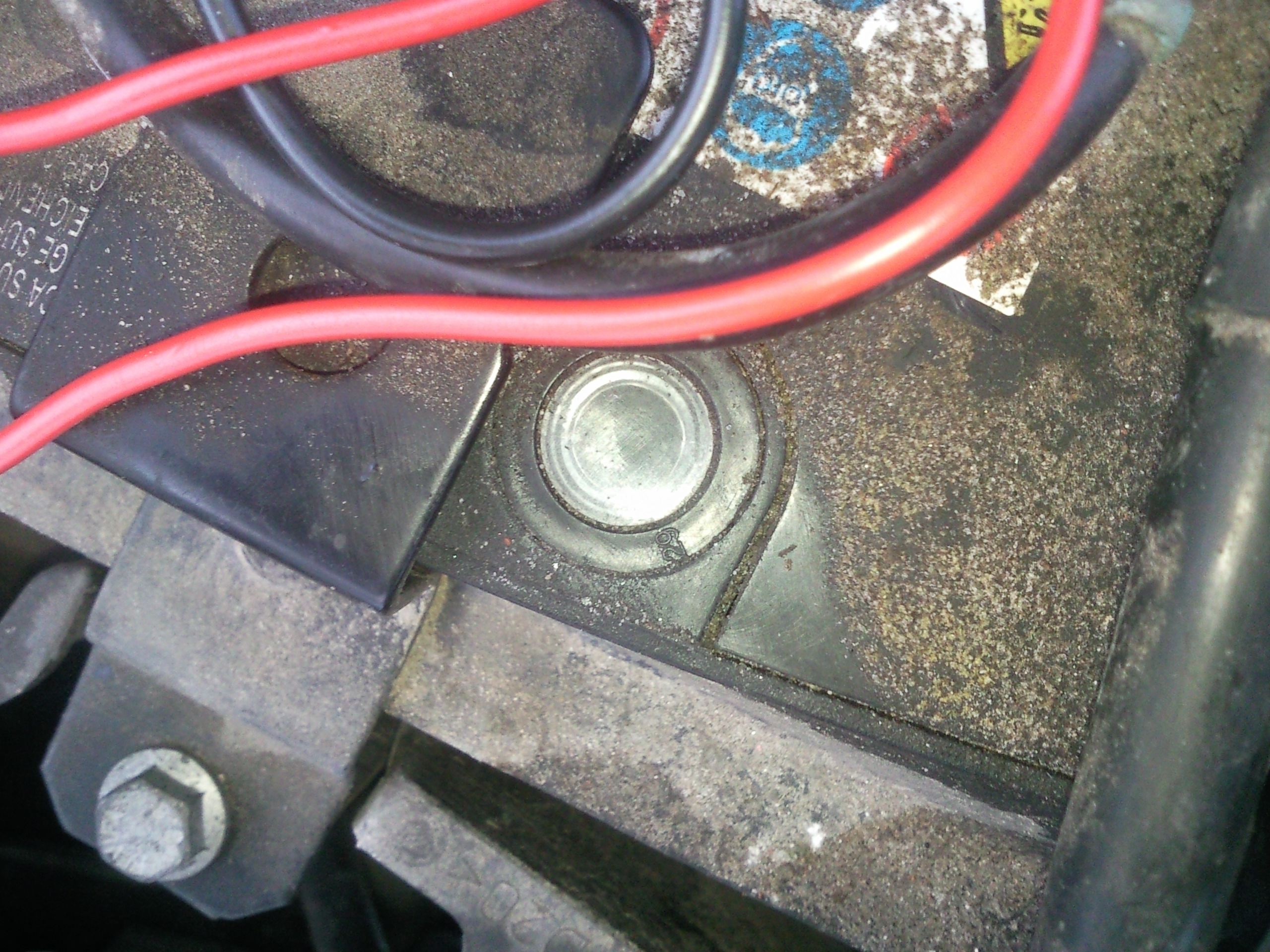

Also, the battery indicator is gone, instead off that little green, it is now black, pitch black :(
Here's a picture:
You've put the meter leads in the wrong sockets of the meter.
Black lead should be in COM, red lead should be in vΩmA to read voltage.
By putting the leads in vΩmA and 10A and connecting across the battery you may have damaged the meter.
Also, the meter battery is going flat so the meter may give inaccurate readings.
