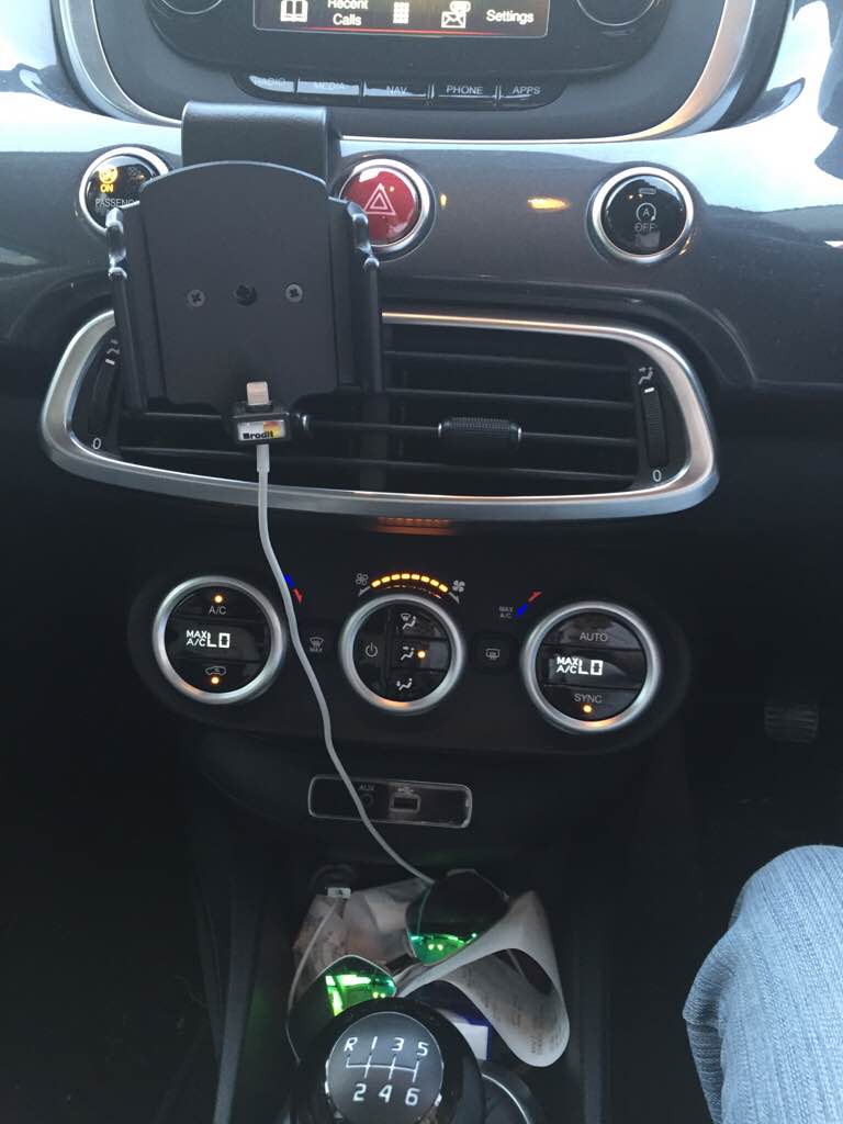

Just in mine now.
16 degrees outside temp, with the setting at low it is very noticeably cold.
In fact, it's cold to the point it is too painful to leave my hand over the vent for more than 20 seconds or so. ImageUploadedByFIAT Forum1462387224.462163.jpg

Just in mine now.
In fact, it's cold to the point it is too painful to leave my hand over the vent for more than 20 seconds or so. View attachment 167598
That's what I long for! Thanks for that - will keep for reference when I go into dealership.
