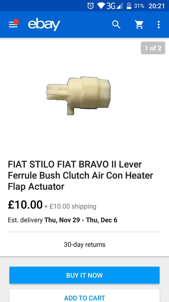

These ferrules are also available on eBay ,iv fitted them to mine and they work
i paid around 10€ each at my fiat dealership, no shipping costs and it was available on the next day...doesnt seem like a great deal if they are ordered from ebay (the plastic part cliffy71 said, havent found the potentiometers anywhere else other than aliexpress).
