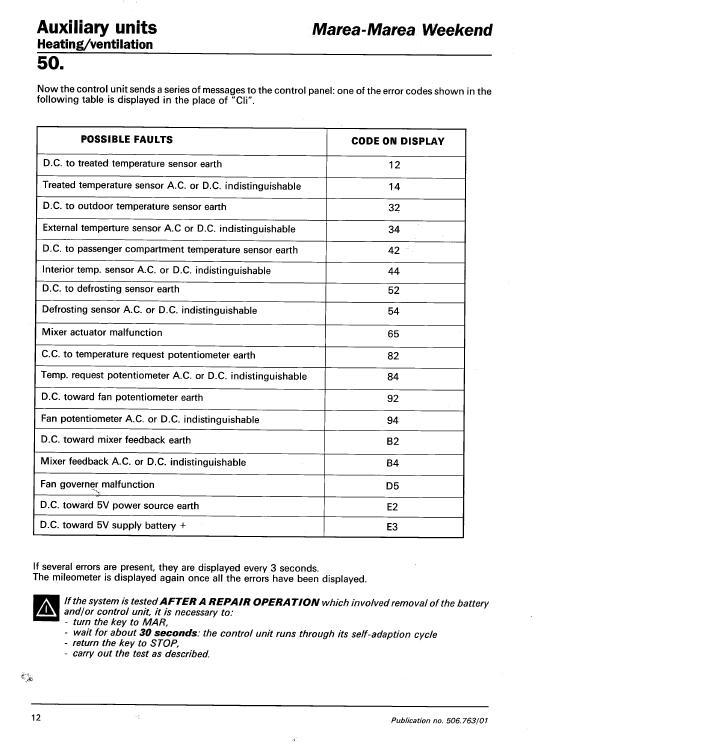

Try giving the centre console a hard knock and see if cold air comes out. Typically Error Cli is when the drivers mirror temp sensor is giving wrong readings. Check the connector from the door to mirror are connected properly. Some people swap the mirrors with mirrors with no sensor hence the warning message.
Make the following setup:
Temp knob on High.
Distribution knob on MAX DEF.
Ventilation knob on 0.
Turn the key from STOP to MAR
Within 10 sec turn the ventilation knob knob in the following sequence:
"0" - "AUTO" - "0" - "AUTO" - "0"
Then check the error code that is generated in the mileometer display with the following list.
