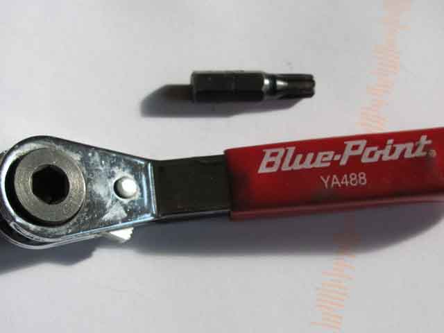

Mine seems to have torx 40 screws, but that's not a problem. Access to screw attaching sensor to the wall of engine is really awkward, even trying to remove egr valve not easy,because of four screws holding that in place, two are very difficult to access. I have come up with an idea, that I will cut short torx screwdriver bit from 25mm to about 18/2015 so it would fit between screw I need to remove and body of EGR valve, and then turn that bit using combination spanner size 1/4".
Now, is there any less hassle involving process to do that on 8v Multijet engines?
Advice much appreciated, thanks.
On my 16v diesel I always used a short torx bit, designed to be slotted into a 1/4" hex driver. Just pop the bit in, hold it in with your finger then turn it using a 1/4" open ended spanner.
Just be careful not to over-tighten when refitting it, as you can get a lot of torque with a spanner.
Cheers Doofer, so you're saying that I would be able to buy torx bits shorter than 25mm or is that the one you call short?
I used a standard T30 1/4" hex bit intended for use with a magnetic screwdriver in a cranked ratchet holder. This has a closed end and a magnet to hold the bit, but is a tight fit. A standard 1/4" ratchet ring spanner or plain ring spanner takes up less space but you can drop the bit. A good trick is to use a couple of small "O" rings on the bit, one each side of the spanner. I also applied a very thin smear of petroleum jelly (Vaseline) on the sensor "O" ring to help it slide into place.

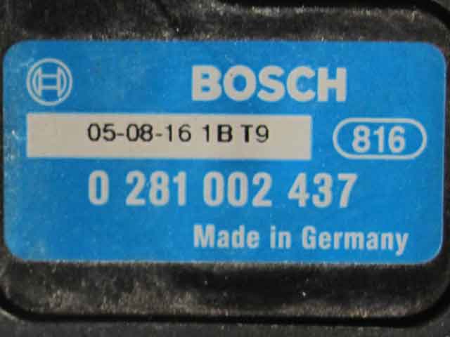

This appears to be a dual sensor. The visible yellow part looks like a thermistor for measuring temperature. The pressure element is inside the body of the sensor. The build-up of soot and tar will slow the response of both.
Hi G8RPI here,
The T30 bit I used (shown in photos) is 25.2mm long. My Croma is a 2006 16V manual and I had no problem. It sounds like the 8V is a bit tighter on space. The bits are hardened so you would have to grind them down, rather than sawing, if you want to shorten one.
