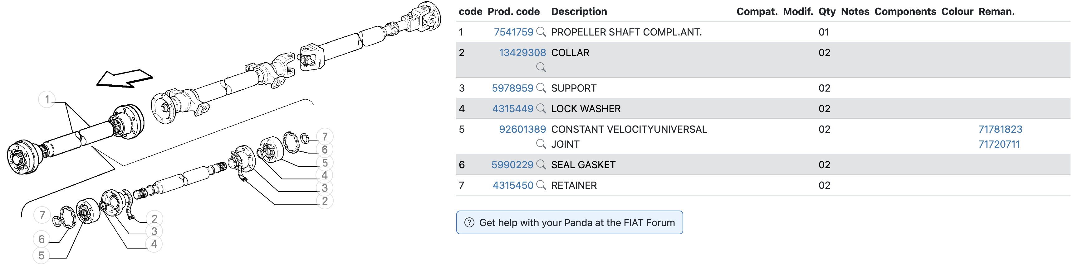

Thanks for your reply! Great point on the clonk as one accelerates – I suppose this would only happen if 4x4 is engaged? I need to go back and test that specifically, but you are probably right. If it was that, would it be some rubber part that is worn? I could not locate it on this diagram:

And thank you for your thesis on the springs. Is this the front suspension? Or these springs?
Generally, I had the impression that sound is coming from the rear, but it is quite hard to be sure since the vehicle is moving at speed.
