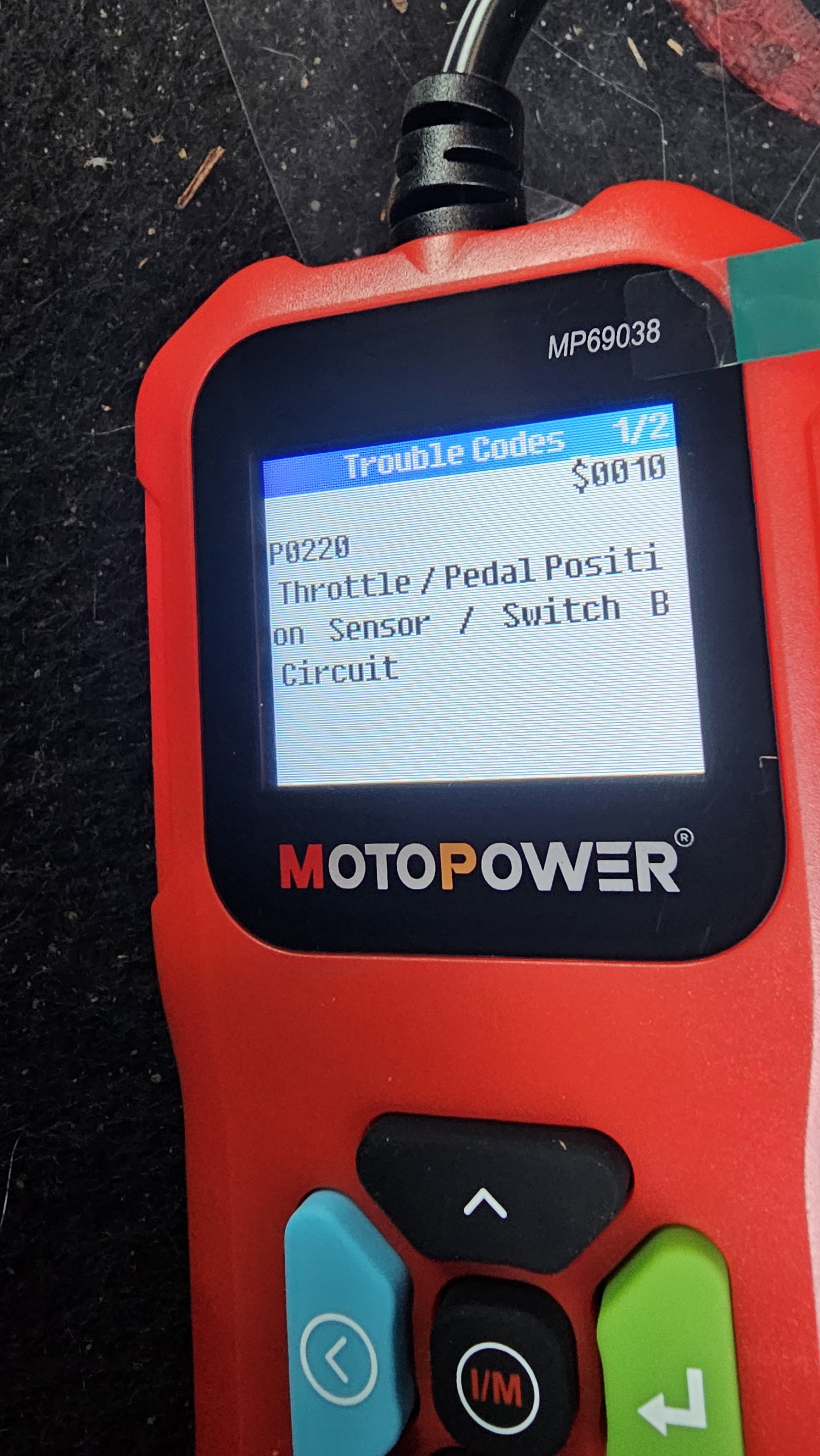

Throttle /Pedal Positi
on Sensor
Switch B

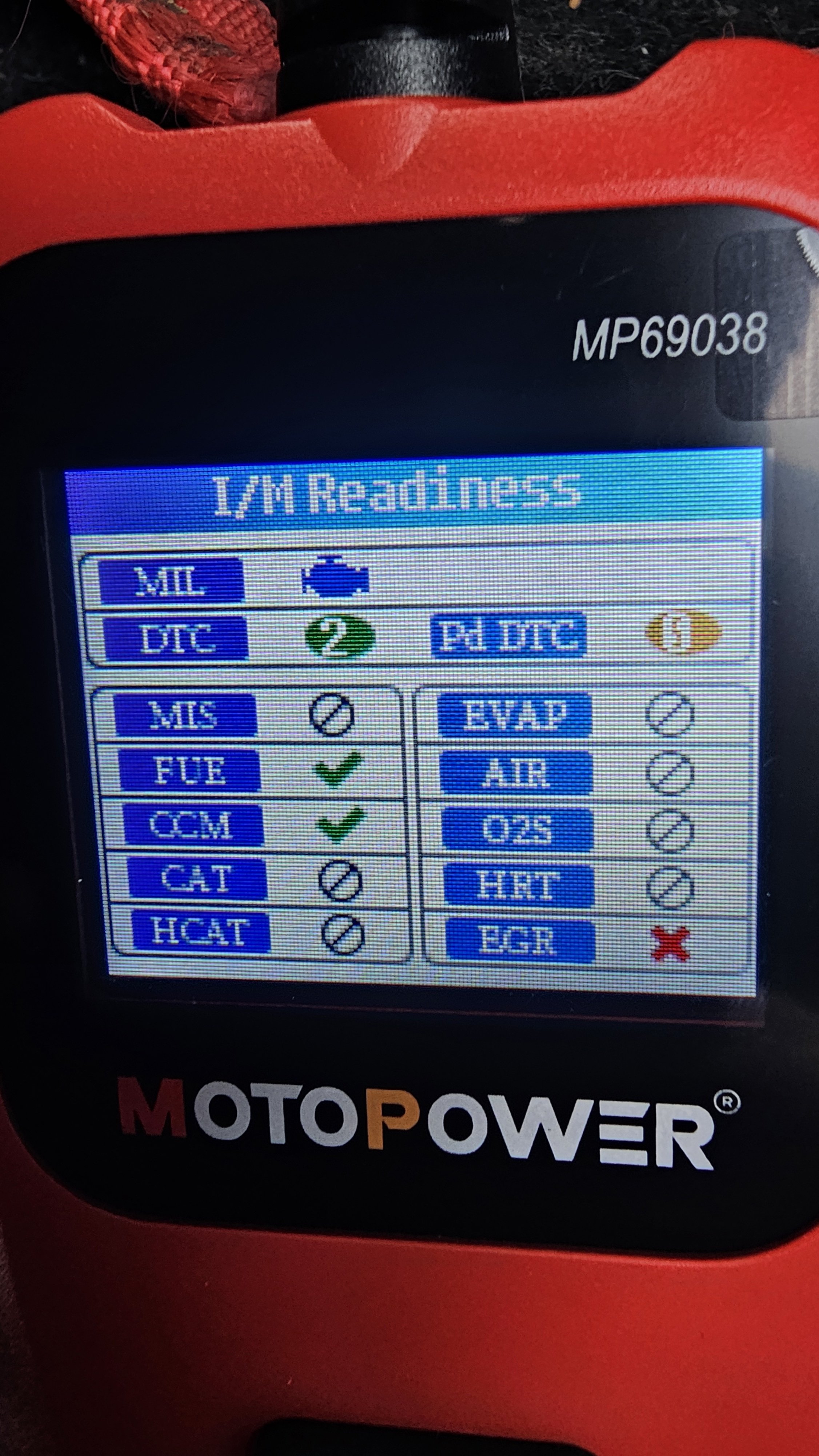

Circuit where do I find this sensor this is what I get on diagnostic engine management light is now on and know power getting to wipers or washer tested all fuese and relays all fine but no joy in finding problem

Seems to be one problem after another when I turn the key to start dash lights on but nothing happens if I leave it on it suddenly starts

In my opinion driving with the engine light on is not a good idea.
I have no idea which ECU and BCM the dispatch has. Is it the FIAT's one, or the PSA one. Depending on that, two different programs are used to communicate with the van (MultiEcuScan or Lexia / PP2000).
As you could see on your own example, the 'generic' code readers are crap. They don't communicate properly with the modules.
Try finding someone who could read the proper error codes.
