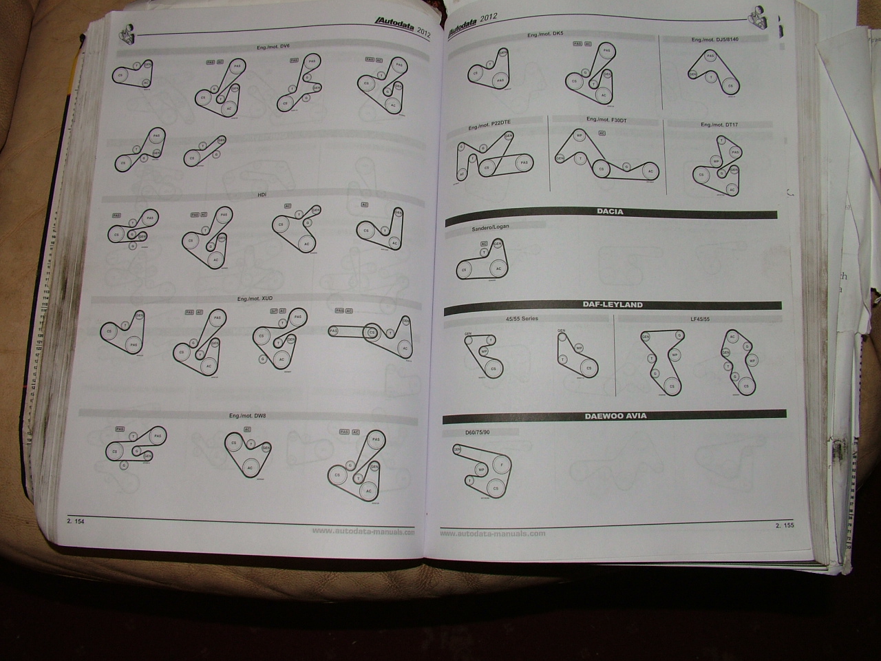

hi guys i am cracking up i need the alternator belt but back on and donot no the run does anyone have a picture so i can put it on the correct way many thanks
Model, age,engine series, aircon or not. please.hi guys i am cracking up i need the alternator belt but back on and donot no the run does anyone have a picture so i can put it on the correct way many thanks
Citroen dispatch 2.0hdi mk1 van 2006 no ACModel, age,engine series, aircon or not. please.
citroen dispatch 2.0hdi enterprize mk1 2006 no acModel, age,engine series, aircon or not. please.
Any good, guessing third row down on the left.citroen dispatch 2.0hdi enterprize mk1 2006 no ac
thankyou very muchAny good, guessing third row down on the left.![]()
Yes looks good m8 thankyou will try putting it on later will let u knowthankyou very much
