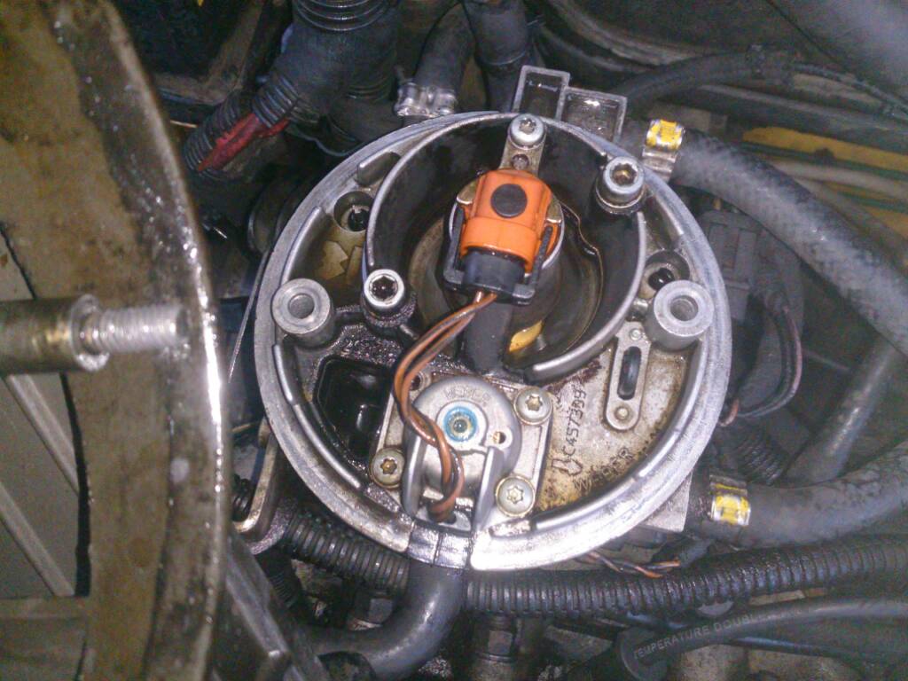

Today, I'm goin to clean the sensor on the spi that controls iddle, to see if that gets better. Gonna see aswell if the car starts whitout the injector to see if the problem is from the ecu or the injector itself. Any help would be good, thanks.

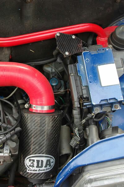

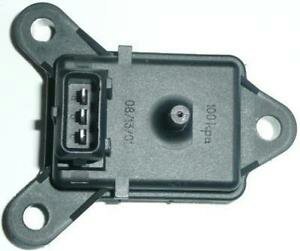

There should be a small pipe from the back of the inlet manifold going to a black box picture included to give you an idea to where and what your looking for it

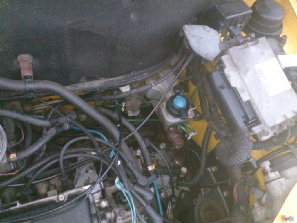

Update buddies, the vacuum pipe seems to connected properly, in a fair condition, so, nop, not map sensor. I'm taking the car tomorrow to a mechanic. Gonna keep this updated.
Here's my webber, and, the vacuum pipe thames from the map sensor to the inlet manifold. (You can zoom in, my phone has a fair camera quality)
