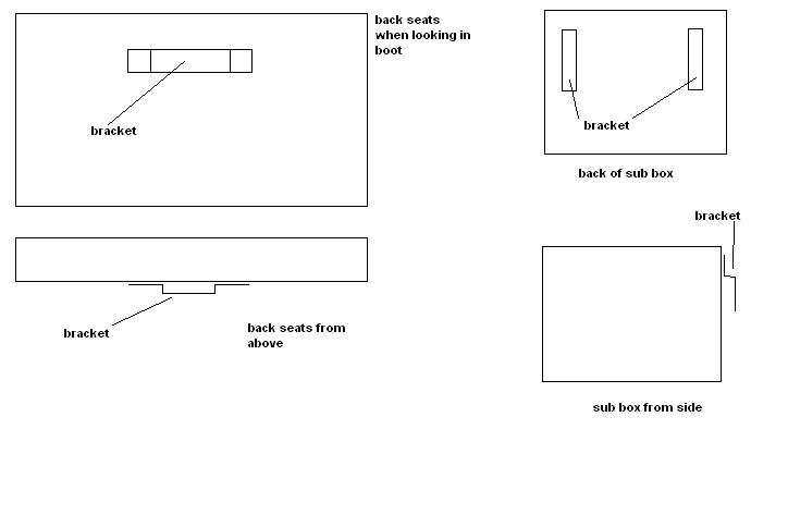

a good way to keep it easily removable is to screw a bracket on the back seat, and then 2 brackets onto the sub box, and then slide the box brackets behind the seat bracket.
that probably doesn make much sense, so let me illustrate.
