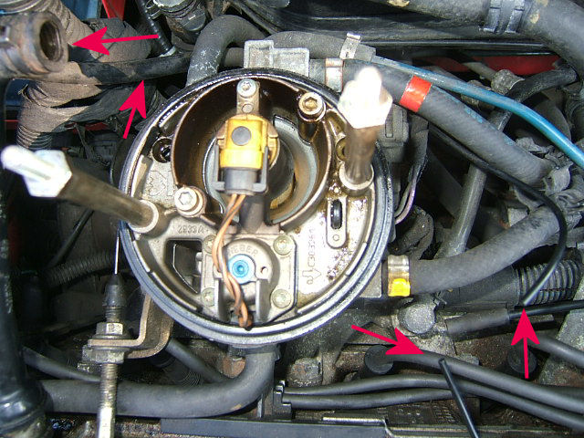

From what I can tell there are 3 vacuum pipes in total. One small one to the MAP sensor, another small one to the rear of the throttle body and the larger oil breather which splits in 2 (one to the air box and the other to the rear of the throttle body next to the smaller one).
Both small ones seem fine. The oil breather was quite gunked up which I've cleaned out and it can now breathe freely.
It still idles at around 1200 :(
