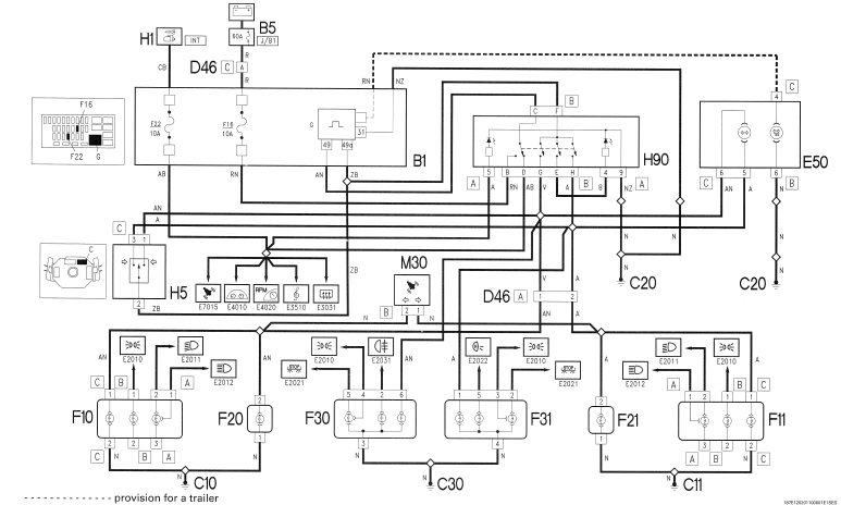

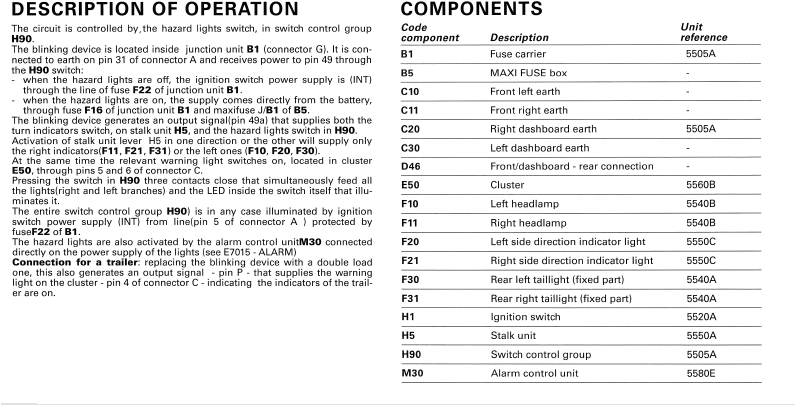

no working hazard lights have tried changing switch & relay still no joy think radio mite be goosed n all! brain bit fried with fiat electrics so have gave up for the day, anyone got a one piece wiring diagram for cinq 899 as haynes.... well nuff said. could a bad earth prevent my radio from working?

cheers mate have you got a full diagram on one sheet? haynes have split diagrams now its a black art fiat electrics methinks
no printer dude wanted to trace wires through loom figured it would be easier with all info on one sheet sort of thing p.s. been eyeing up that head 32 mm tb u say? hmmm

hi craig ask ming bout 32mm tb cos i heard it off him, my prob was big plug had been removed so had wires spare 4 were speakers but the purple wire has to be connected to the red/green wire i now got hazards AND sounds (pity bout the tiny speakers) all i got to do for mot is exhaust now athing dun p.s its a 95 cinq
cool is yours an sx because mine has had an alarm fitted and they have wired it to the indicators and i dont have the fob for it
