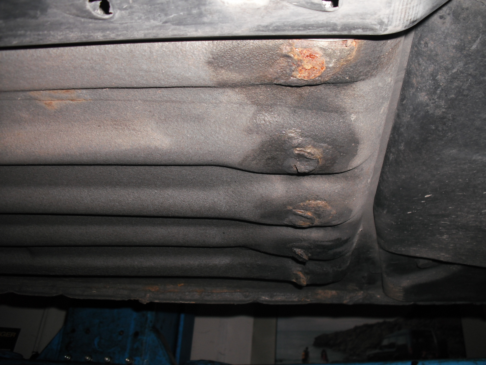

Finally got the Marea up on the hoist to check the condition after a rough winter. I just peeled back the seperated underseal wirebrushed the rust and painted Dinitrol 4941 over the areas where the underseal has failed. That should see it through the next 10 years. These was the only area that needed doing but i went round the whole car while I was there. If you leave this sort of damage the car will need welding after 2 or 3 years.
that's exactly where mine needed plating:(
on the road for another year though:cool:
